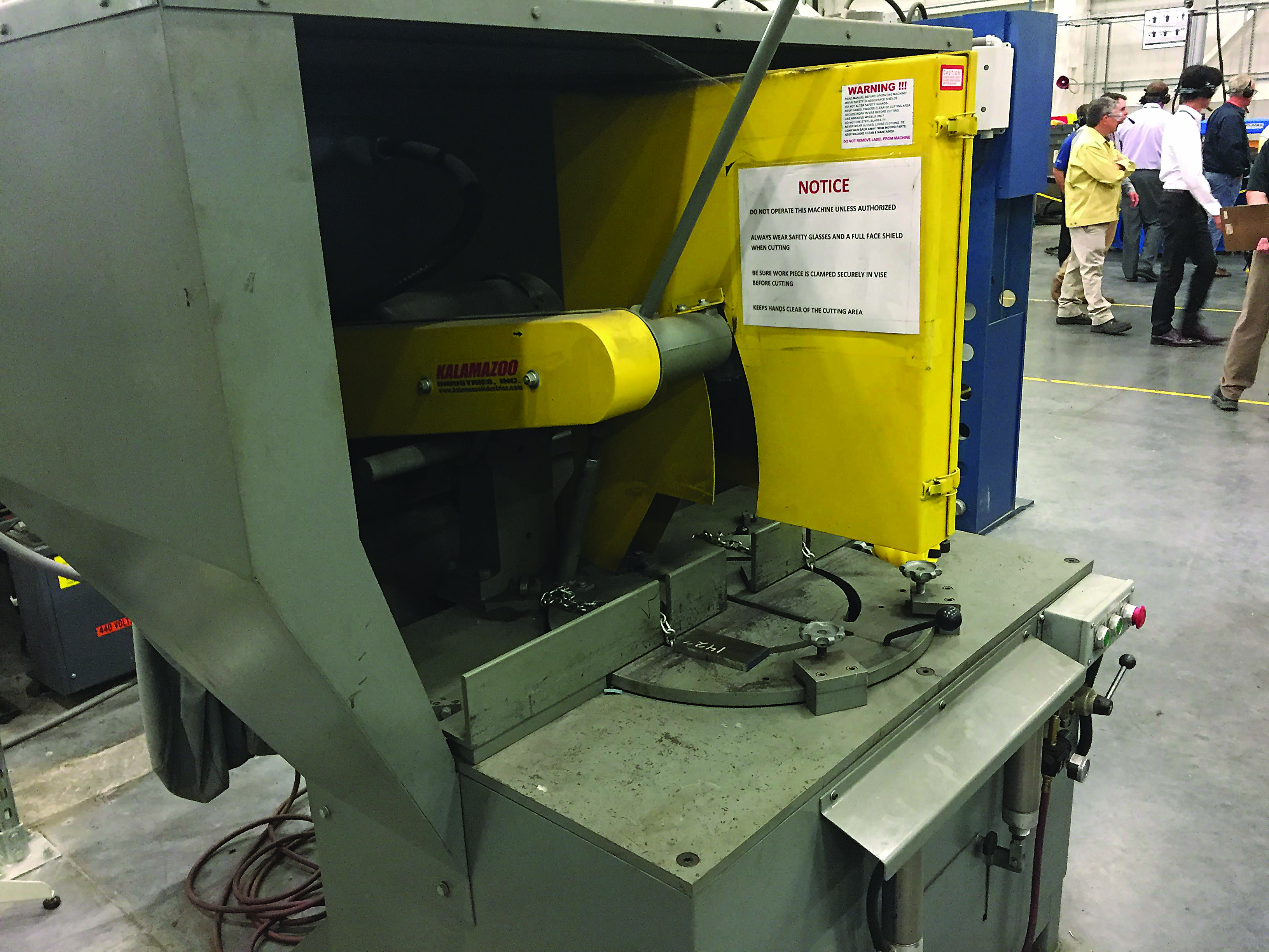

No sawing discussion would be complete without covering abrasive cutoff saws. As the name implies, these saws utilize blades made from abrasives, usually aluminum oxide encapsulated in a fiber-reinforced resin.
Compared to the other saws discussed, abrasive saws are barbaric. They are hot, dirty and not highly accurate, but they do have a place in manufacturing.
Abrasive saws are easy to use and require little maintenance. They don’t need coolant and are economical to operate. These saws are often found in places that need to quickly cut something long down to size.
Abrasive saws are also used to remove sprues, gates and slag from forgings and castings. They are often found in shops that fabricate rebar. Abrasive saws and blades are forgiving, which makes them suitable for harsh
environments.
