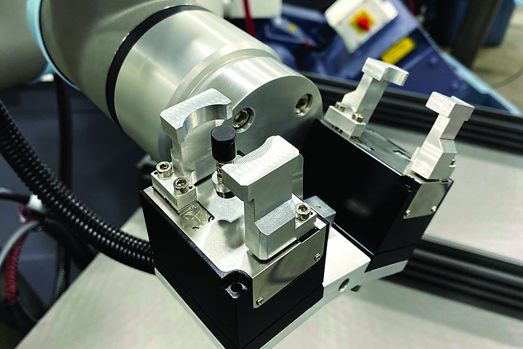

A standard Flex Grip Tool connects two work-handling arms. Image courtesy of Schunk Intec

An example is shown of off-the-shelf components connected via customization. Image courtesy of Fairlane Products
Shops may choose from a selection of off-the-shelf items on Fairlane Products’ website or reach out to the company for operation-specific, customized grippers. Online brochures include important specifications to help machinists pick the right tools, and Fairlane Products’ engineers can fill in gaps from there.
