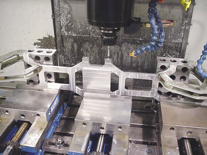

This part is held for edge drilling with the aid of 2-4-6 blocks. All images courtesy J. Harvey.
When presented with a part that is difficult to hold, your ingenuity will be put to the test. However, don’t spend time constructing complex fixtures when you don’t have to. When a standard vise won’t do the job, one option is conventional shop tooling, such as 1-2-3 blocks, 2-4-6 blocks, long parallels, grinding vises, angle plates and V-blocks. These items can effectively provide the added support you need.
Nonetheless, I’ve found that when I finally decide to build a custom fixture, I’m almost always glad I did. Often a fixture is needed to hold parts for perimeter cutting if the material is already at the correct thickness. In these cases, you can’t use excess stock to hold the part.
The following is a simple but effective trick for making fixtures you can bolt parts to. Suppose you are making a part that has no excess material to hold for cutting the perimeter, but has through-holes that can be used for clamping. When you are done drilling, manually tap the fixture through the holes in the part. After that, simply screw the part to the fixture. You are now ready to cut the perimeter. The beauty of this method is you never have to move the part.

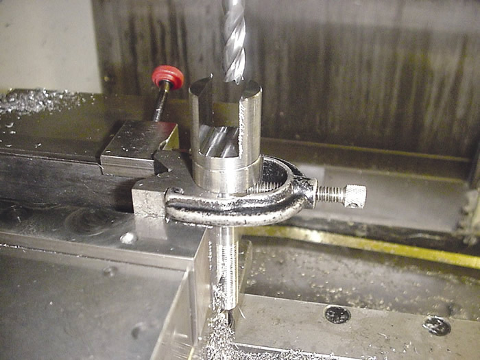

V-blocks provide a quick way to hold cylindrical parts for further machining.

There are a few items to keep in mind when using V-blocks to hold parts. First, V-blocks don’t apply clamping pressure over a large surface area. The clamping pressure is applied to tangent lines on the part circumference. If you squeeze down too hard on a part held with a V-block, you may dent the part and throw the centerline of the part off location.
If you use two V-blocks to hold round parts, theoretically, you get four lines of clamping contact. If cutting pressures will be light, I often use just one V-block and a vise jaw to apply clamping pressure. In addition, placing soft material between the vise jaw and part prevents denting the part.
If the diameter of a cylindrical part is not precise and consistent, using a V-block to hold the part may cause it to tilt or throw the centerline off location. That’s one reason you shouldn’t always take advantage of wide-open tolerances. Tight tolerances, although not necessarily needed for the part to function, may be needed to accurately locate and hold workpieces for further
