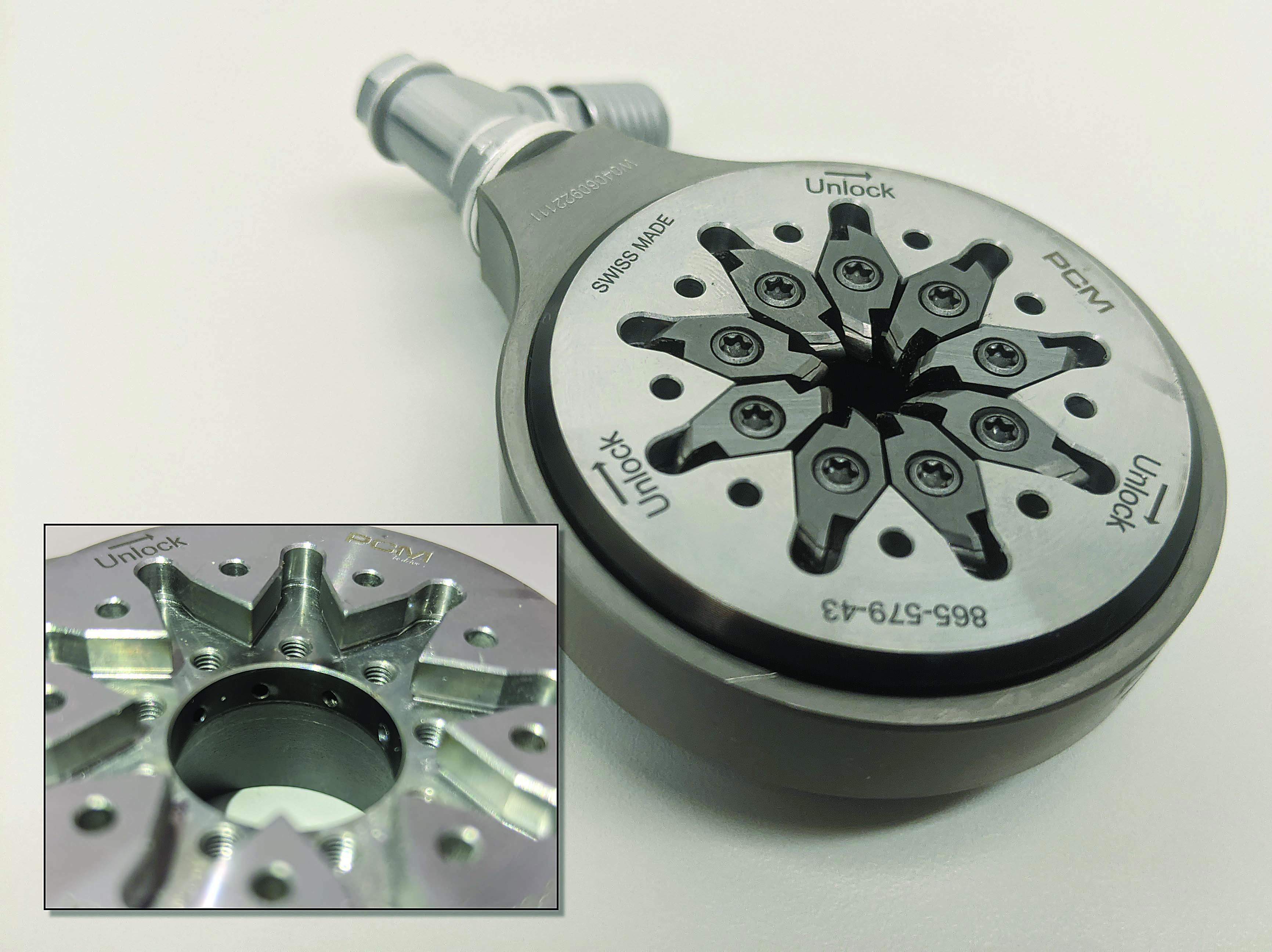

Shown above is a typical arrangement of cutting inserts in a thread whirling ring, which affixes to the dedicated live tooling attachment used to perform the process. Image courtesy of Genevieve Swiss Industries

Internally cooled thread whirling rings eliminate the need to have perfectly aimed coolant nozzles for chip evacuation and insert cooling. Cutting oil is delivered to the insert edge through internal channels in the cutter ring. Image courtesy of Genevieve Swiss Industries

“To help accommodate that,” he said, “shifted cutter rings that bring the inserts closer to the guide bushing are available for more readily available live tooling attachments on the market.”
