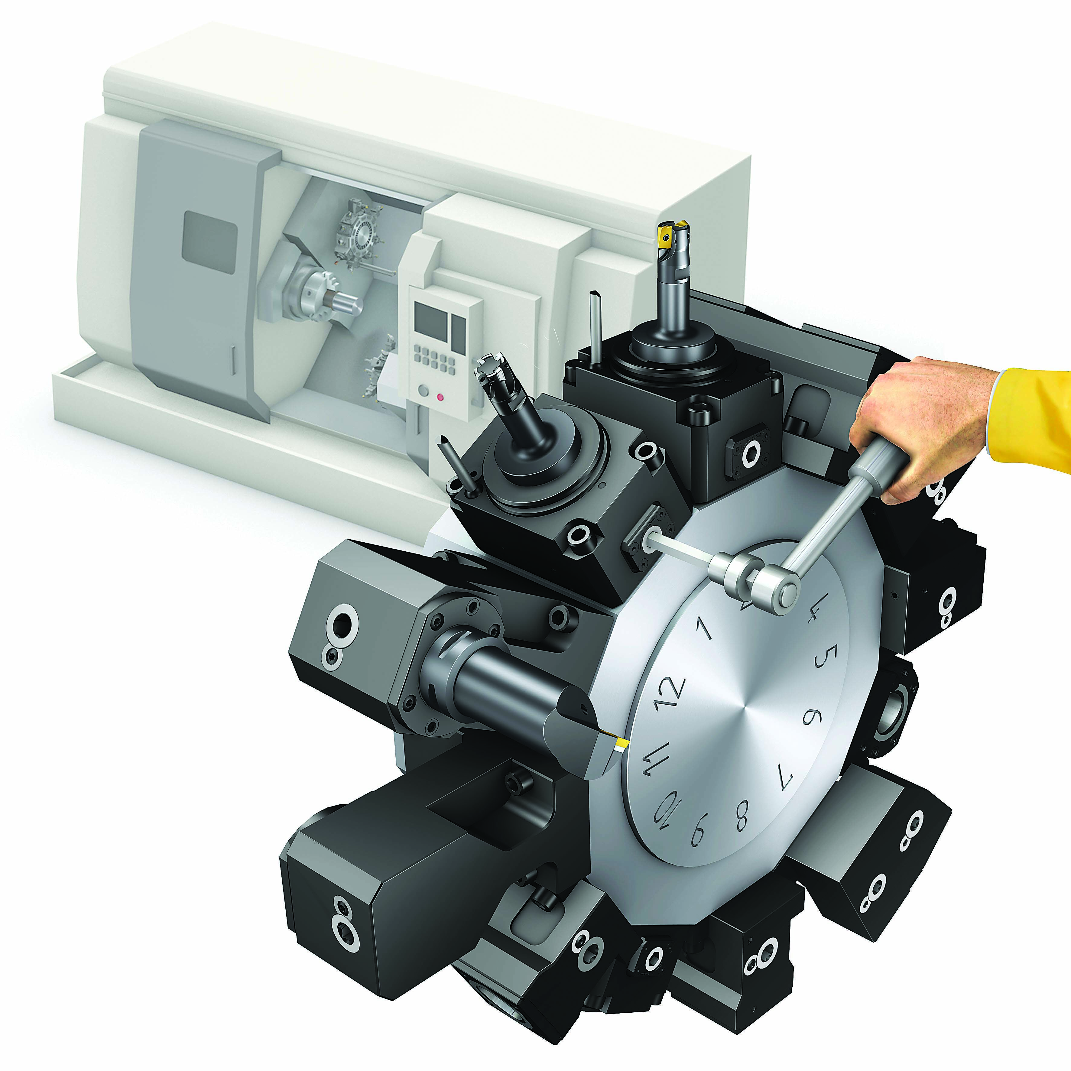

Quick-change tooling solutions can increase machine utilization in industries that use complex assemblies and longer tools, such as aerospace engine component production, by reducing the time that it takes to measure, set up and change tools.
Quick-change tooling solutions can increase machine utilization in industries that use complex assemblies and longer tools, such as aerospace engine component production, by reducing the time that it takes to measure, set up and change tools. Image courtesy of Sandvik Coromant

CNC lathes and sliding head machines have fast tool indexing, but they often have lower utilization than machining centers because of the time that it takes for setup and tool changes. Here, quick-change solutions can make a big impact on utilization by dramatically reducing changeout times. Swapping turning tools may go from 10 minutes to 30 seconds, and driven tools might go from 20 minutes to 30 seconds. There are even more advantages for boring bars, which can be more time-consuming because of center height setting and coolant plumbing. With a quick-change solution, they could be changed in less than a minute, with better accuracy.
But how do you achieve these advantages? There are a number of features to look for in a quick-change solution that will ensure faster tool changes and setup times. The stability and sophistication of the coupling design play an important role. Designs that use loose parts like pins can mean more fumbling with changes and less accuracy. And couplings that rely on moving parts like ball bearings may wear out more quickly.
The coupling design in Sandvik Coromant’s Capto system, for example, uses a triangular polygon shape with a tapered contact surface for quick, accurate positioning within 2 µ. The coupling locks into place and centers itself by locating off of the three polygon lobes. The large contact area of the coupling also improves rigidity and maximizes even torque transmission. With this patented design, clamping the cutting unit in a static or driven toolholder can be achieved manually with a quarter turn of a hexagon key or with an automated solution in a machine tool spindle.

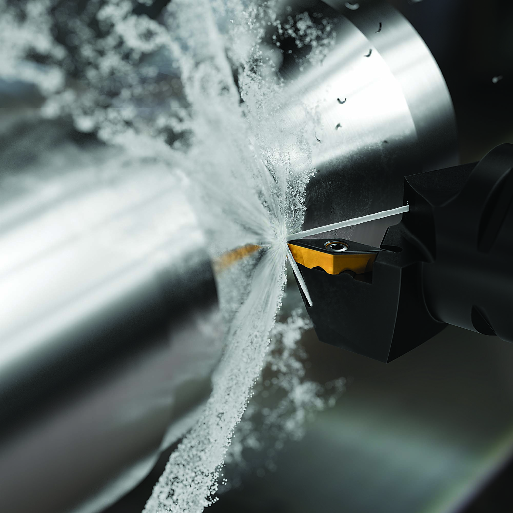

With advances in quick-change design, toolholders can use high-pressure jets to deliver coolant, which not only cools the cutting tip but helps break chips and improve chip evacuation.
With advances in quick-change design, toolholders can use high-pressure jets to deliver coolant, which not only cools the cutting tip but helps break chips and improve chip evacuation. Image courtesy of Sandvik Coromant

Coolant delivery is another important consideration when choosing a quick-change solution. Advanced systems are designed with lubrication channels built in to the toolholder that deliver lubricant through the turret and holder and straight to the tip of the tool. This further speeds up setup times by eliminating the need for unwieldy hoses and plumbing that complicate tool setting. It also provides more efficient coolant delivery that can significantly boost tool life and productivity.
Equipped with embedded sensors and Bluetooth connectivity, smart driven toolholders, such as Coromant Capto DTH Plus, capture useful toolholder data to enable predictive maintenance.
Sandvik Coromant
With advances in quick-change design, high-pressure coolant delivery is possible too. Some toolholder designs use high-pressure jets to deliver coolant, which not only cools the cutting tip but helps break chips and improve chip evacuation. These systems additionally improve uptime by reducing the risk of chip jam-ups and bird nests. The high-pressure delivery also can contribute to much higher cutting speeds.
