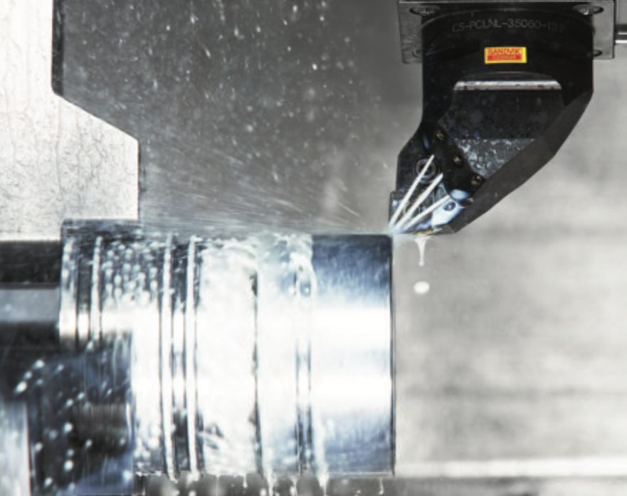

When turning heat-resistant superalloys, accurately targeted high-pressure coolant provides chip control while enhancing cooling at the tool/workpiece interface and enables higher cutting speeds.

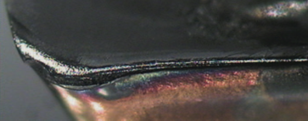

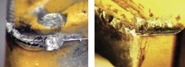

A number of wear mechanisms occur when machining HRSA. According to Sandvik Coromant’s Holt, the two major ones that have a detrimental effect on chip formation are built-up edge and, because the surface is prone to workhardening, notch wear.
The latter effect, also called notching, is found on the main and secondary cutting edges and is more prominent when cutting nickel- and cobalt-based alloys, the toolmaker reports. On the main edge, notching is seen as chipping at the DOC and is mainly mechanical wear. Notching occurs on the secondary edge where an insert exits the workpiece and negatively impacts the surface finish. Notching on the secondary edge is caused mainly by chemical wear; aluminum-oxide and PVD tool coatings are recommended to minimize it.
BUE and notching on the main and secondary edges can be minimized by applying round inserts with positive, reinforced geometries. “Round inserts are the strongest inserts available, and with a round insert you’re getting out of the area of notch wear by varying the entering/lead angle, depending on the depth of cut selected,” Holt said. “You should never be using a typical CNMG insert to machine superalloys as this creates a 95° entering angle, thus increasing notch wear on the insert.”

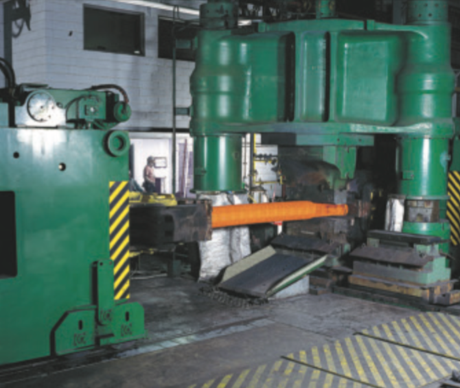

Carpenter Technology’s vacuum arc remelting furnaces remove impurities from ingots produced in primary melting.

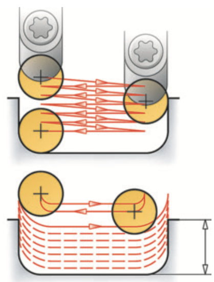

Holt pointed out that when cutting nickel-base superalloys, trochoidal milling and trochoidal turning can be effective because they eliminate the high level of contact between the insert and workpiece and prevent wraparound. (Wraparound occurs when plunging or profiling corners with round inserts because of the high angular engagement, creating high cutting pressures. Therefore, the feed must be reduced.)
“A trochoidal toolpath is almost like a swinging toolpath,” he said. “You’re not plunging in. The insert is not under sudden shock and you get a nice, smooth, optimized toolpath. Especially when taking a smaller DOC, you can increase the feed rate and that helps with chip breaking as well.”
For controlling wear, in general, Holt recommends an entry angle of 45°, with a maximum of 60°.

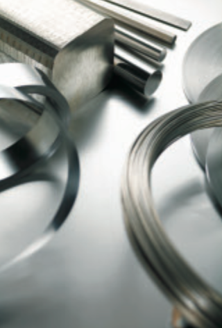

Carpenter Technology produces nickel-base superalloys in a variety of product forms to meet stringent customer specifications.
It is best to use accurately targeted high-pressure coolant—up to 1,200 psi—from an optimized nozzle to produce a high-velocity, parallel laminar jet, Holt noted. Benefits of high-pressure coolant include extending tool life, enabling higher cutting speeds and enhancing chip breaking and control by providing a hydraulic wedge between the tool and chip to lift the chip.
In a laboratory test, Sandvik Coromant compared the application of high- and low-pressure coolant when machining 718 Inconel. The high-pressure coolant increased tool life, increased metal removal 50 percent when using a CNMX insert at a cutting speed of 164 sfm, allowed a 20 percent increase in cutting speed with the same or better tool life and improved chip control during finishing.

Typical insert wear mechanisms when machining heat-resistant superalloys include notch wear on the main cutting edge at the DOC (left), chip hammering (right) created by chips hitting the cutting edge line outside the cutting zone, and plastic deformation (below) caused by a combination of high temperature and high pressure on the cutting edge.
