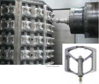

Figuring there must be a better way, the company sought alternatives and found Pitbull fixture clamps from Mitee-Bite Products LLC, Center Ossipee, N.H. The clamps provide a low gripping profile and high vertical and horizontal clamping forces, according to Mitee-Bite. For its aggressive stock-removal requirements, Straitline selected 0.750 "-wide clamps with a tool steel knife edge and maximum holding force of 3,600 lbs. It built a test fixture for the clamps and compared the clamp setup against the vise setup.
“The clamps can apply a tremendous amount of down force because of the way they cam down onto the part,” Paulson said, noting that the clamps only hold 0.090 " of stock using a standard ¼-20 cap screw. “We found we could push the Mitee-Bite setup as hard as we wanted without the parts shifting in the fixture.”
Running a 1 "-dia. cutter at 14,000 rpm, Straitline can feed at about 250 ipm with a 3⁄8 " DOC using the clamps vs. 100 ipm and 0.100 " DOC using the vises, Paulson noted. “With the Mitee-Bites, we’re just flying through the material,” he said.
For production applications using the clamps, Straitline made workholding fixture plates the same size as the tombstone faces. Dowel pins are used to locate the plates, which bolt onto the palletized tombstones, Paulson explained. The company uses an air tool to quickly tighten and loosen the clamp cap screws when placing parts on fixture plates and removing them.
IMG_0703.tif
Courtesy of Straitline Components
When roughing bicycle components, such as an aluminum pedal (inset), on a tombstone, Straitline Components uses Pitbull fixture clamps from Mitee-Bite to hold as little as 0.090 " of stock without the parts shifting in the fixture.
