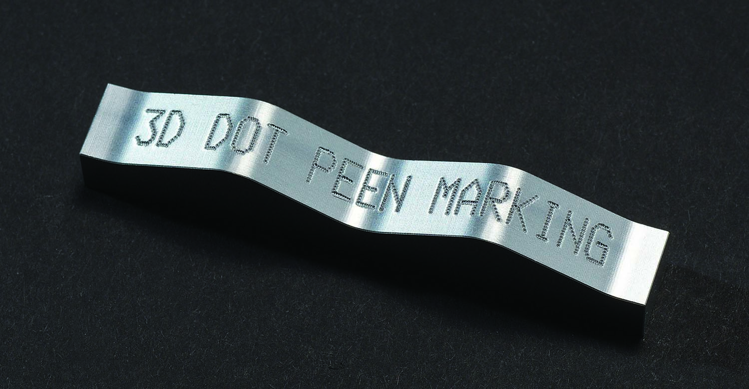

Equipped with Intelligent Driving Impact, the stylus of a dot peen marking system can follow the contour of a marking surface. Image courtesy of Technomark
Dot peen systems create marks using a stylus that displaces material on a part surface. As for laser marking, he sees wider adoption of the technology, with fiber lasers being the preferred option of their kind for marking metal parts. He said both dot peen and laser systems excel at putting QR codes on parts.

On the other hand, costs rise and the task becomes more difficult when application conditions are less than optimal. He said the most challenging applications are those that require marking across uneven surfaces. While chemical etching can effectively mark these surfaces, he said both laser and dot peen systems can struggle with wavy marking surfaces due to height differences across the wave profile. So he noted that some sellers of laser systems offer 3D marking heads that can adapt to variations in surface height relative to the laser lens.

As for dot peen systems, Lawlor cautioned that they may leave only a faint mark in some places if they lack the ability to adjust to surface height differences. For applications like this, Hansen pointed out that some marking systems have a spring-loaded feature that allows them to apply sufficient force across an uneven surface to produce marks with consistent depth.

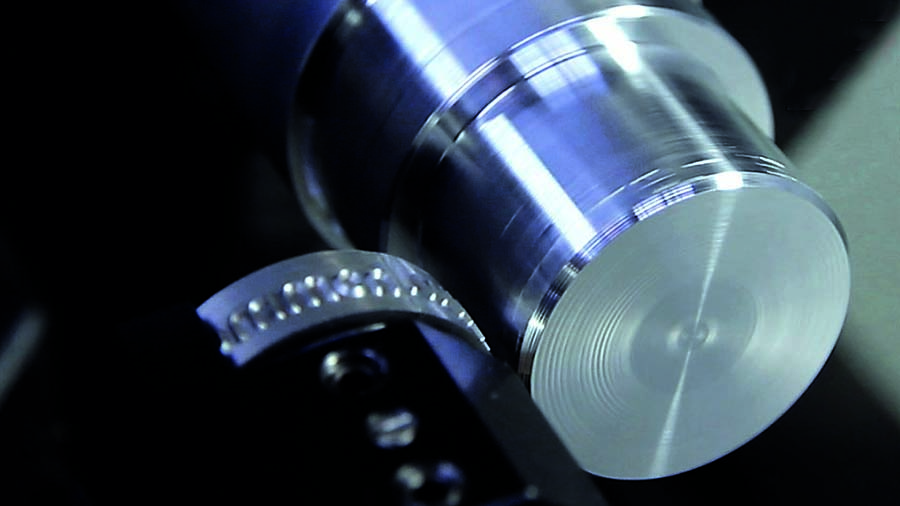

Laser marks show clearly on metal parts. Image courtesy Dapra” data-entity-type=”file” data-entity-uuid=”1a69291a-b64c-49f3-b034-5b4c7a83575f” height=”327″ src=”/wp-content/uploads/legacy/inline-images/Image%206%20Datamark%20Small%20Metal%20Parts%20-%20Laser%20Marking%20-%20Data%20Matrix_1.jpg” width=”492″ />To effectively mark uneven surfaces, Technomark has equipped all its dot peen machines with Intelligent Driving Impact, a patented technology that automatically adjusts the marking force and stroke length of the stylus as necessary during the process. If a marking surface is wavy or otherwise complex, IDI makes sure the stylus will be able to follow its contour and produce a mark of even depth, according to the company.If the parts to be marked are round, shops can employ a rotary marking tool. As a round part turns, Hansen explained, it’s in contact with the rotary tool, which is turning as well and essentially rolls the desired mark onto the part as it does so.In addition, Lawlor pointed out that both laser and dot peen systems can be programmed to mark around the circumference of any round component.When the challenge is marking parts with thin walls, both laser and dot peen systems are up to the job thanks to their adjustability, Boulkouane said. For these applications, he said users of dot peen systems can select a lower marking force while laser users can opt for lower frequency and power settings.Lawlor said shops marking thin-wall parts also will appreciate the ability of fiber lasers to minimize heat-affected zones.”Since they’re very precise,” he said, “they can mark very quickly, so the (part) is not deformed or impacted in any way by heat transfer to the base material.”Lawlor added that chemical etching is a good option for marking thin-wall parts because it normally creates marks with minimal depth. He said this process is also effective for marking very hard materials.Hard ProblemsLaser and dot peen systems can handle hard materials as well. Thanks to their hard carbide styluses and adjustable force settings, Boulkouane said dot peen systems can mark part materials up to 63 HRC.When the material is harder, however, “even if you select the highest force on the machine,” he said, “the marking will be light.”A stand-alone laser marking station, the AutoMarkX can work in a fully automatic mode. Image courtesy of Anca” data-entity-type=”file” data-entity-uuid=”1d662126-3636-4273-bd05-9d70d573138a” height=”367″ src=”/wp-content/uploads/legacy/inline-images/Image%201%20AutoMarkX%20new%20machine.jpg” width=”376″ />Laser users can turn up the power of their systems to mark harder materials. In addition, Boulkouane said they can make several passes to produce the desired marks.”The precision of these machines allows you to mark text in the same position several times,” he said. “If you mark the same position several times, you will be able to (achieve) more depth.”Generally speaking, however, dot peen systems can produce deeper marks than lasers, Boulkouane noted, which means that dot peen marks last longer.”Depending on the area, 20 years, 30 years, even a century after the marking, you will have more chance to be able to read a mark done by dot peen than (a mark done by) a laser,” he said.On the other hand, Hansen believes that laser marks have an edge when it comes to appearance.”Aesthetics are important, and it’s not always easy to make a good-looking marking,” he said, adding that laser marking is very consistent and the results “are always beautiful.”On the downside, Hansen said laser marking systems aren’t cheap and marking volumes often may be insufficient to justify the expenditure.”Shops that are not doing marking every day or not doing high volumes are probably not going to invest in a laser marker,” he said.Making ProgressToday, Lawlor sees more manufacturers with high marking volumes integrating automation into operations. In such processes, for example, a robot can take a part from a cart, place the part in a machine for automatic marking and then move the marked part back to the cart. In seconds, Quick marking tools can mark parts with a variety of geometries. Image courtesy of Platinum Tooling Technologies
