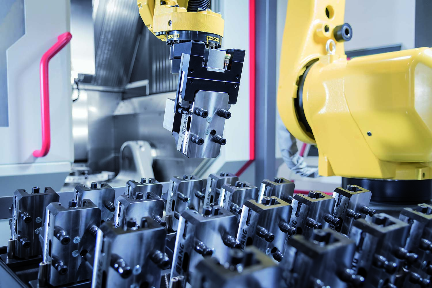

Common workholding devices include vises, into which blanks are manually loaded outside the machine tool. In automated systems, the loaded vises are picked up by a robot arm and placed into the machine.
One example of this is the RoboTrex automation system from Lang Technovation Co. in Hartland, Wisconsin. The system contains a pair of trolley carts that hold vises loaded with blanks. Loading takes place offline while the machine is running, explained General Manager Jon Dobosenski. Once filled with loaded vises, the trolley cart in the loading area is ready to be wheeled into the machining area, where it takes the place of the other cart, which is filled with vises that hold parts that have been machined. During the machining process, a robot arm picks each loaded vise out of the cart and places it into the machine, then puts it back in the cart when machining of that part is finished.
A robot locates vises in a cart and keeps track of which are ready for machining and which are finished.
A robot locates vises in a cart and keeps track of which are ready for machining and which are finished. Image courtesy of Lang Technovation
With this dual-cart system, he said, “we can keep the automation process consistent and maximize usage time on the machines.”

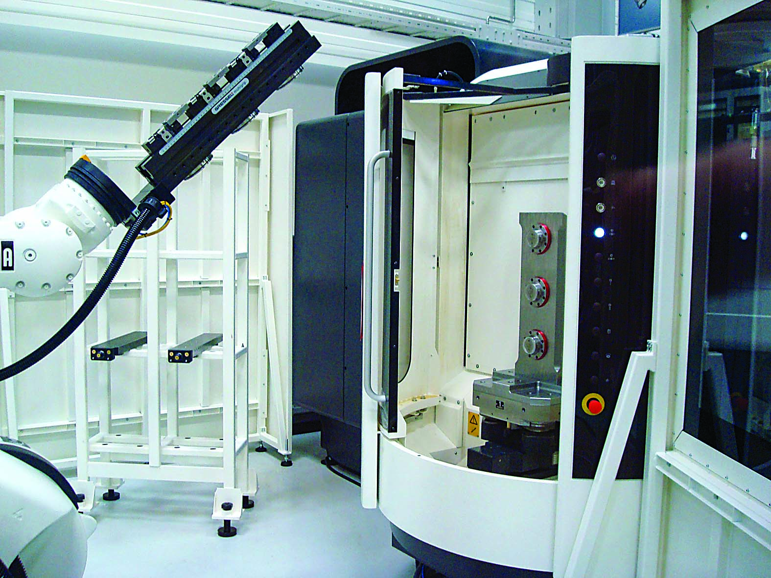

A robot pulls a fixture loaded with material from the racking.
A robot (top) pulls a fixture loaded with material from the racking, then the loaded fixture (above) is placed on a custom tombstone fixture in the machine. Image courtesy of BIG DAISHOWA
If a shop relies strictly on a robot in these situations, “the robot programming will require constant upkeep,” he said. “You have to keep going back in and tweaking the program points where the robot picks and places things.” However, “an accurate location system for the pull studs ensures that the process has a good level of repeatability.”

Zaya pointed out that many newer automation systems are designed to pick and place assemblies consisting of blanks held by fixtures, such as pallets capable of holding multiple parts. Inside a machine, loaded pallets are often placed on zero-point clamping systems that attach to the underside of a pallet by means of a retention knob or pull stud of some sort, he explained.
“If you have a 12″ pallet and your part is 8″, you can only fit one part on the pallet,” he said. “But if your parts are 3″ or 4″, you may be able to nest multiple parts per pallet.”
Zaya said increased “part density” per fixture is the way that workholding can have its biggest impact on an automated system.
“Having a single part per fixture only makes sense when it’s based on part size,” he said. “Once you get away from size constraints, having multiple parts per fixture is where an automation system can really shine, particularly with five-axis machines.”
In five-axis machining, a common occurrence cited by Zaya is the need to machine four or five parts at a time. In cases like this, he said shops can use a pyramid fixture with four faces and possibly a fifth on top, each of which can hold a part.
“That way,” he said, “you’re loading a single fixture but with four or five parts on it rather than swapping individual parts or individual fixtured parts.”

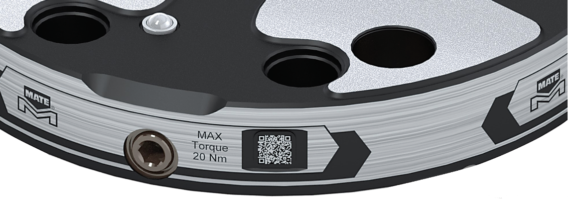

When it comes to workholding, automation isn’t limited to robotic picking and placing. To help customers get access to accurate, up-to-date product information, Mate Precision Technologies has embedded a QR code in its vises, bases and other workholding products. The code serves as a link to Mate Precision Technologies’ database, which contains a wealth of information about each of its devices. This includes the device’s born-on date, torque settings, tolerances, CAD drawings and maintenance recommendations.
To access this information, all users need is a cellphone.
 The QR code embedded in workholding products from Mate Precision Technologies gives access to a wealth of information about the devices for users.
The QR code embedded in workholding products from Mate Precision Technologies gives access to a wealth of information about the devices for users. Image courtesy of Mate Precision Technologies
“Say you’re on the night shift and you have to put (a workholding device) in the machine, but you’re not sure what it is and the front desk is closed. How will you find out quickly?” said Frank Baeumler, vice president of workholding. “All you have to do is pick up your phone and scan that QR code, and you’ll have all of this information right on your phone. So you can get your machine into green-light time quickly because you’re not running around looking for paperwork or looking for another human to help you.”
In addition to getting information in real time, operators can be sure that what they’re seeing on their phone screens is the latest on the subject.
“The QR code points to a database that we control,” Baeumler said, “and we update the documents.”
