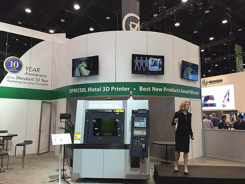

Hybrid machine tools for moldmakers
Sodick’s OPM250L hybrid machine blends CNC milling with powder-bed fusion
for moldmaking applications. Image courtesy of Sodick.
The reason for the low level of competition has a lot to do with technological challenges inherent to the process, according to Evan Syverson, marketing manager for Sodick Inc., Schaumburg, Ill.
“In order to print something that is adequate for moldmaking, you need to use direct metal laser sintering,” he explained, adding that DMLS provides a suitable density for molds.
Also known as powder-bed fusion, the process involves firing a fiber laser into a bed of powder metal (PM), which melts or welds the material together to create the part structure. While LMD is by far the most common method in hybrid machines, that process—in which PM is essentially sprayed and then melted onto the work surface—creates structures that are too porous for molds, Syverson noted.
“Those types of machines have considerable utility in repair and fabrication work,” Syverson said, “but with a powder bed, the material density endemic to the process lends itself more closely to moldmaking.”
Density is critical, he explained, because even small deviations can dramatically reduce the lifespan of a mold. For example, a 0.1 percent difference in density can yield a 50 percent reduction in tool life. Sodick’s OPM250L offers a reliable part density of 99.99 percent, while other 3D printers may be limited to 99.7 percent density or lower, according to Syverson.

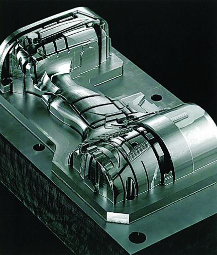

The combination of additive and subtractive manufacturing can yield complex, intricate mold geometries
with extremely fine surface finishes, without involving an EDM. Image courtes of MC Machinery Systems.

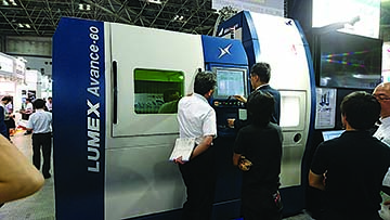

Effectively alone in their class, Matsuura’s Lumex Avance-60 and Sodick’s OPM250L hybrid machines cause a stir at trade shows. Images courtesy of Matsuura Machinery (left) and Sodick.
“Besides the obvious,” he said, “parts can be designed such that various offsets can be created, then milled in process, which increases accuracy from ±0.010″ to ±0.001″—a huge leap.”
Matsuura’s Lumex machines boast similar selling points. Prototypes can often be completed in a single untended machining cycle, according to Gillcrist, and the cycle times in the molding process can be further reduced by building internal cooling channels into a mold. Perhaps most surprisingly, this hybrid technology has allowed MC Machinery to almost—not entirely—eliminate the need for a sinker EDM on the shop floor.
“Every 10 layers, the laser stops and the spindle moves over to do some rough semifinishing of the top 10 layers, followed by a finish path on the previous 10 layers,” he explained, meaning the spindle is able to work in areas of the workpiece that might become unreachable once the part is complete. “That means we can generate some very deep structures or ribs that were previously only achievable via EDM.”

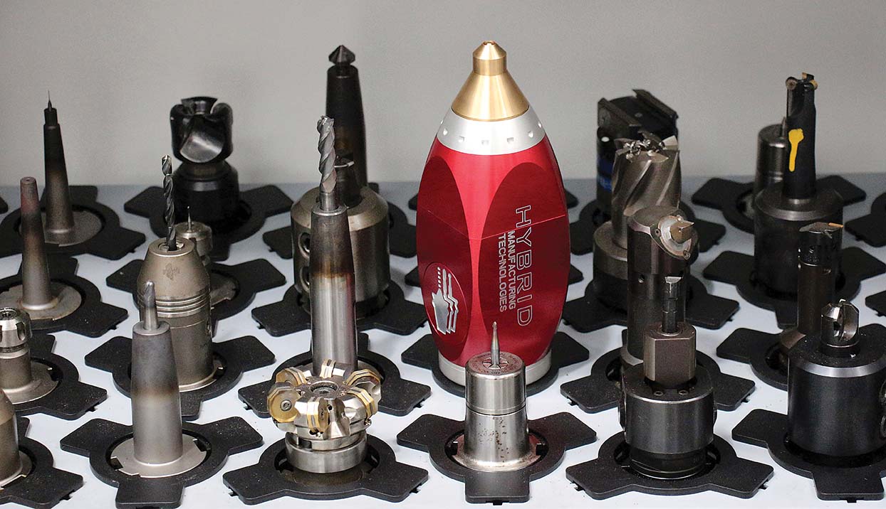

Hybrid Manufacturing Technologies’ AMBIT system can be fitted to a standard CNC spindle,
making switching between additive and subtractive machining processes no different than any other tool change.
Image courtesy of Hybrid Manufacturing Technologies.
“There are multiple opportunities for this technology within moldmaking,” said Hybrid CEO Jason Jones. These include restoring a mold to its original dimensions and modifying an out-of-tolerance mold. “Another, which has the biggest impact, is to enhance a mold so that it’s better than the original mold.”
Restoring old molds or modifying new ones can provide substantial cost savings, he continued, because out-of-spec molds don’t necessarily have to be scrapped and replaced. Such “enhancements”—adding a wear-resistant coating to critical surfaces of a humble tool steel mold, for instance—is an affordable way to significantly lengthen mold life.
“Most people don’t think of plastic or glass as being particularly hard or abrasive, especially compared to steel,” Jones said, “but when you’re injection molding, the molten material wears away the mold as it flows, to the point that the mold has to either be thrown out or refurbished. Cladding the surfaces most prone to wear means you are getting performance that’s comparable [to a mold made of a much harder and more expensive material].”
In addition, traditional moldmaking involves roughing, heat treating and finish machining, rendering alterations to the finished mold difficult and costly, he said. AMBIT heads allow machinists to weld new material to the mold and impart the desired finish in the same setup, at a much lower cost than making an entirely new mold.
