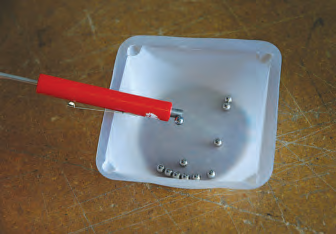

The small magnet on a pocket screwdriver can tell you a lot about a metal based on its level of magnetic attraction.

• Magnetism. The small magnet on a pocket screwdriver can tell you a lot based on a metal’s level of magnetic attraction when you are hip deep in the metal rack or see an odd looking dowel pin in the stainless steel box. I always have one of these cheap magnetic screwdrivers in my apron pocket. It’s my combination pry bar and metal identifier.
