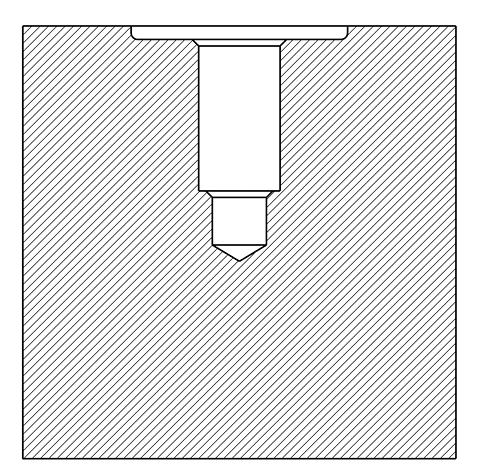

However, high-production shops often have cycle-time requirements that prevent this approach. Automotive manufacturers machine millions of parts each year and a cycle-time reduction of 1 second leads to significant savings. Therefore, a tool that produces multiple geometric features simultaneously often becomes a necessity. A job shop might create a complex hole using five tools for spot drilling, drilling, reaming, spotfacing and chamfering, whereas a custom combination tool eliminates the need for multiple operations (Figure 2).
FIGURE_2.tif
Figure 2. These hole features, which are similar to ports in hydraulic components, could be produced by applying numerous standard tools, but if it’s a high-volume parts application, a custom drill that creates the features in one operation is easy to justify.
