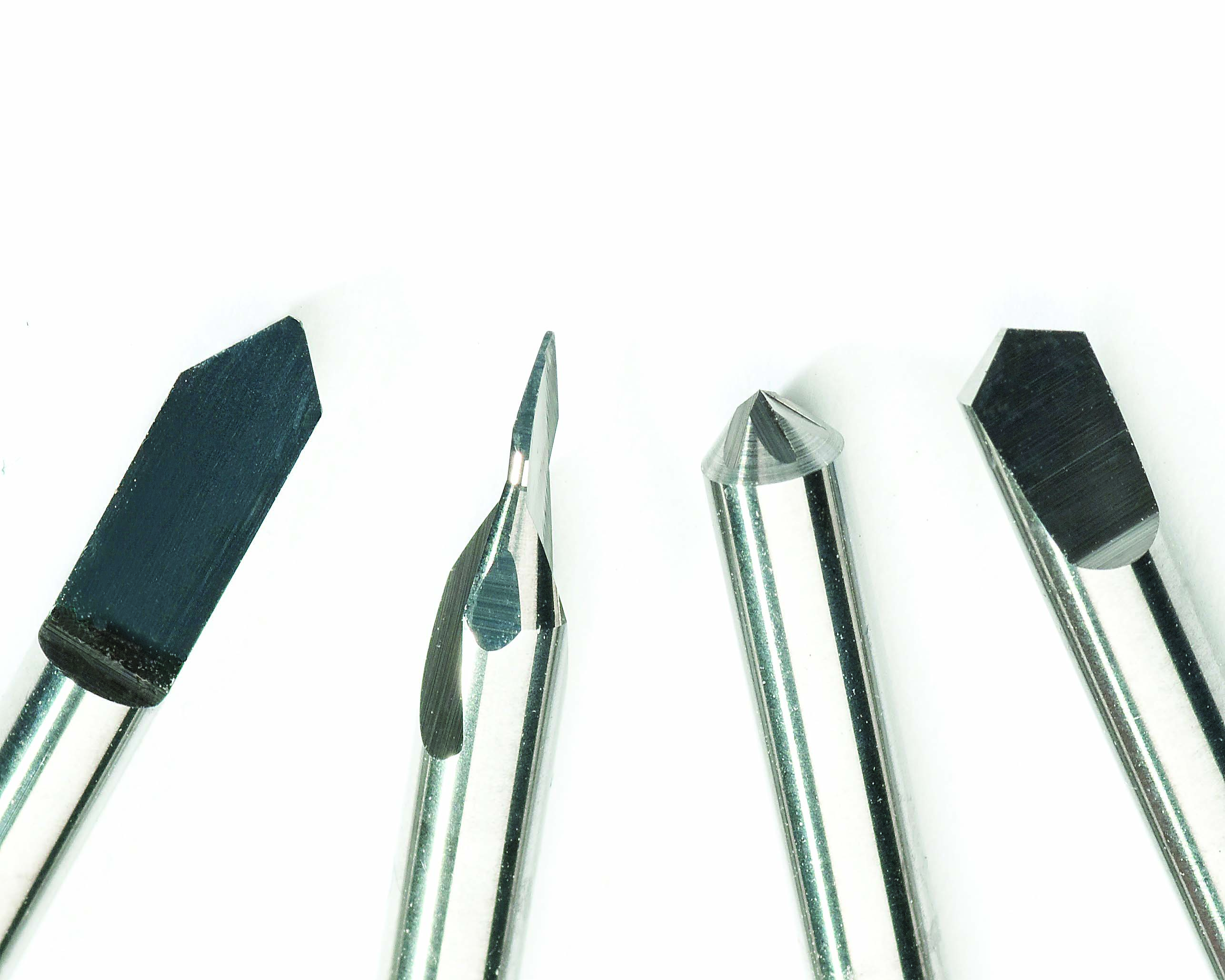

Kyocera Precision Tools offers solid-carbide spade, half-round and two-flute engraving tools. Image courtesy of Kyocera Precision Tools
However, that’s not the case for the other two series, Jackson said. The two-flute EGR engravers have a 1.27 mm (0.05″) diameter, have a V-shaped bottom and are available with a 30°, 60° or 90° included angle while the single-flute HR tools have a flat at the end as small as 0.127 mm (0.005″) to produce a letter height up to 1.59 mm (0.0625″).

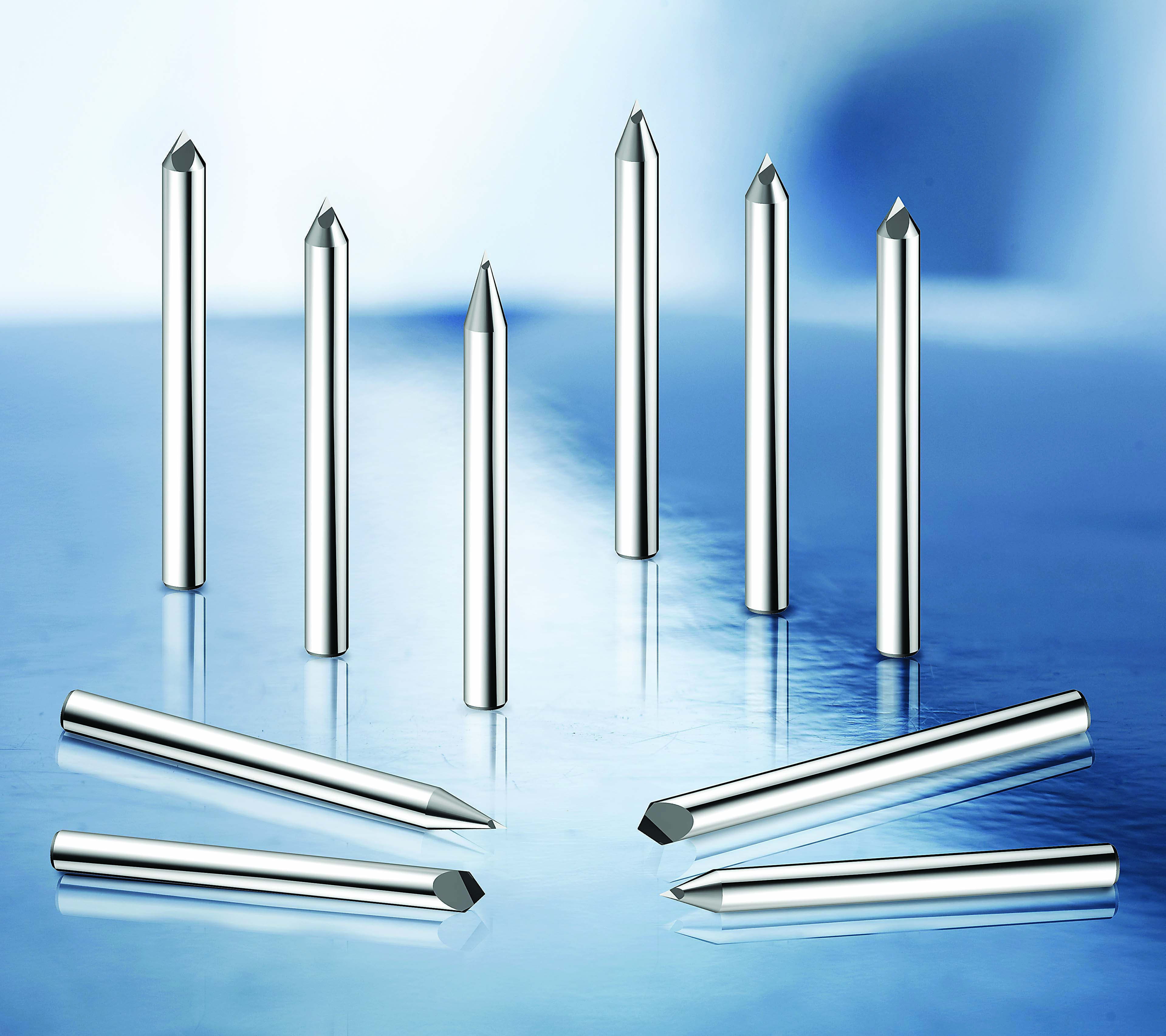

BIG KAISER Precision Tooling Inc. is another manufacturer of microengraving tools. The Hoffman Estates, Illinois-based company offers Sphinx single-flute engraving mills with a flat or radius tip. The flat-tip tools have a diameter range from 0.02 mm to 0.15 mm (0.0008″ to 0.0059″) and are available with a point angle of 30°, 40°, 50°, 60° or 90°. The other style is available with a radius range from 0.04 mm to 0.1 mm (0.0016″ to 0.0039″) and the same selection of point angles.
The tools are targeted at machining environments that require a high level of precision, said Sphinx Product Manager Cory Cetkovic.

This EGR series engraving tool (bottom) and split-point engraving tool (top) are from Kyocera Precision Tools. Image courtesy of Kyocera Precision Tools

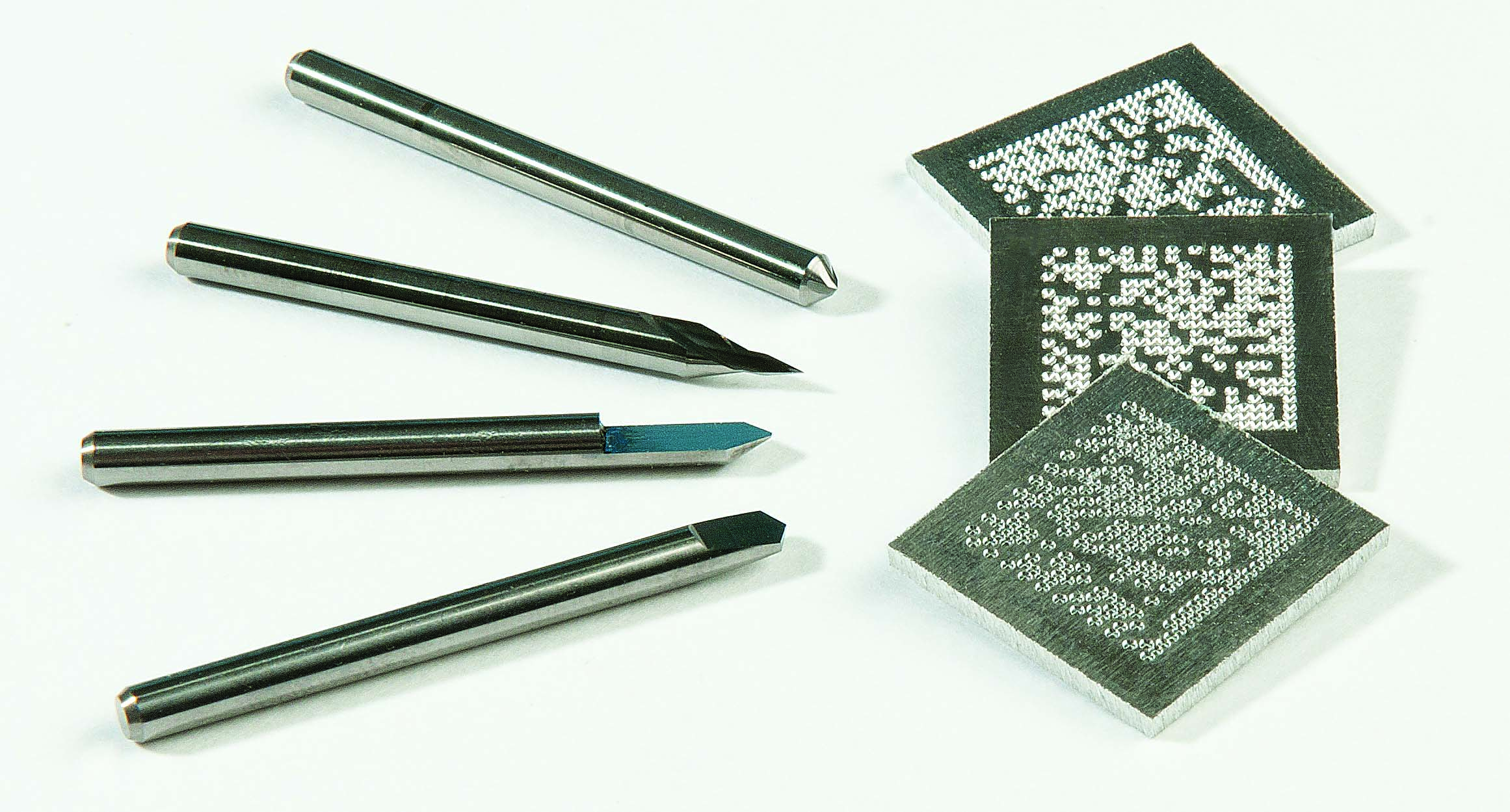

To minimize the amount of workpiece material that sticks to a tool, White pointed out that SCT provides a polished finish on the face of its engravers.
In addition, cutting edges must be sharp to create a clearly visible, consistent engraving. That is generally not an issue for uncoated engraving tools but can be for coated tools if the appropriate coating technology isn’t employed.
“In the old days, the coatings were pretty thick because they were CVD coatings,” White said. “Now, the modern PVD coating is thin: 1 to 2 μm (0.00004″ to 0.00008″). You can put it on a really sharp tool and still keep a sharp cutting edge.”

Engraving tools and engraved workpieces are shown. Image courtesy of Kyocera Precision Tools

Sphinx single-flute engraving mills are displayed. Image courtesy of BIG KAISER Precision Tooling
