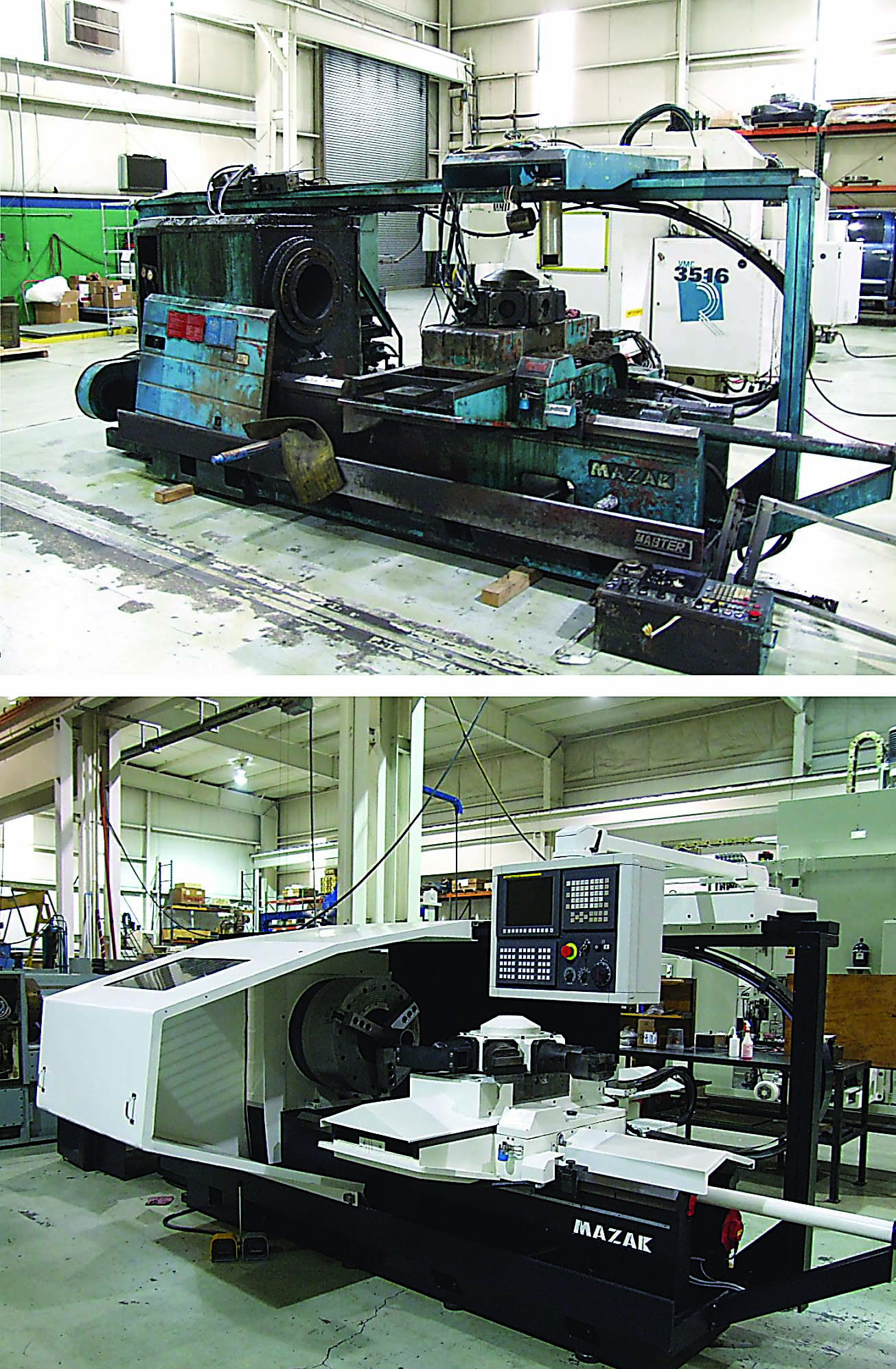

Before-and-after photos of a remanufactured Mazak Power Master turning center. Image courtesy of KRC Machine Tool Solutions.
When rebuilding a circa 1976 vertical turning lathe, hand scraping consumed about eight hours a day, 40 hours a week for three or four weeks, Mullins said. “Some machines are bigger and take longer to scrape, and smaller machines you can do in a couple of weeks. With proper preventive maintenance, a good scrape job will probably last 10 years.”
A remanufacture includes all the rebuild steps, a CNC retrofit and at times a machine redesign to enhance its capabilities and improve its productivity. According to KRC, remanufacturing a machine costs about half of a new machine and is most appropriate when replacement costs exceed $600,000.

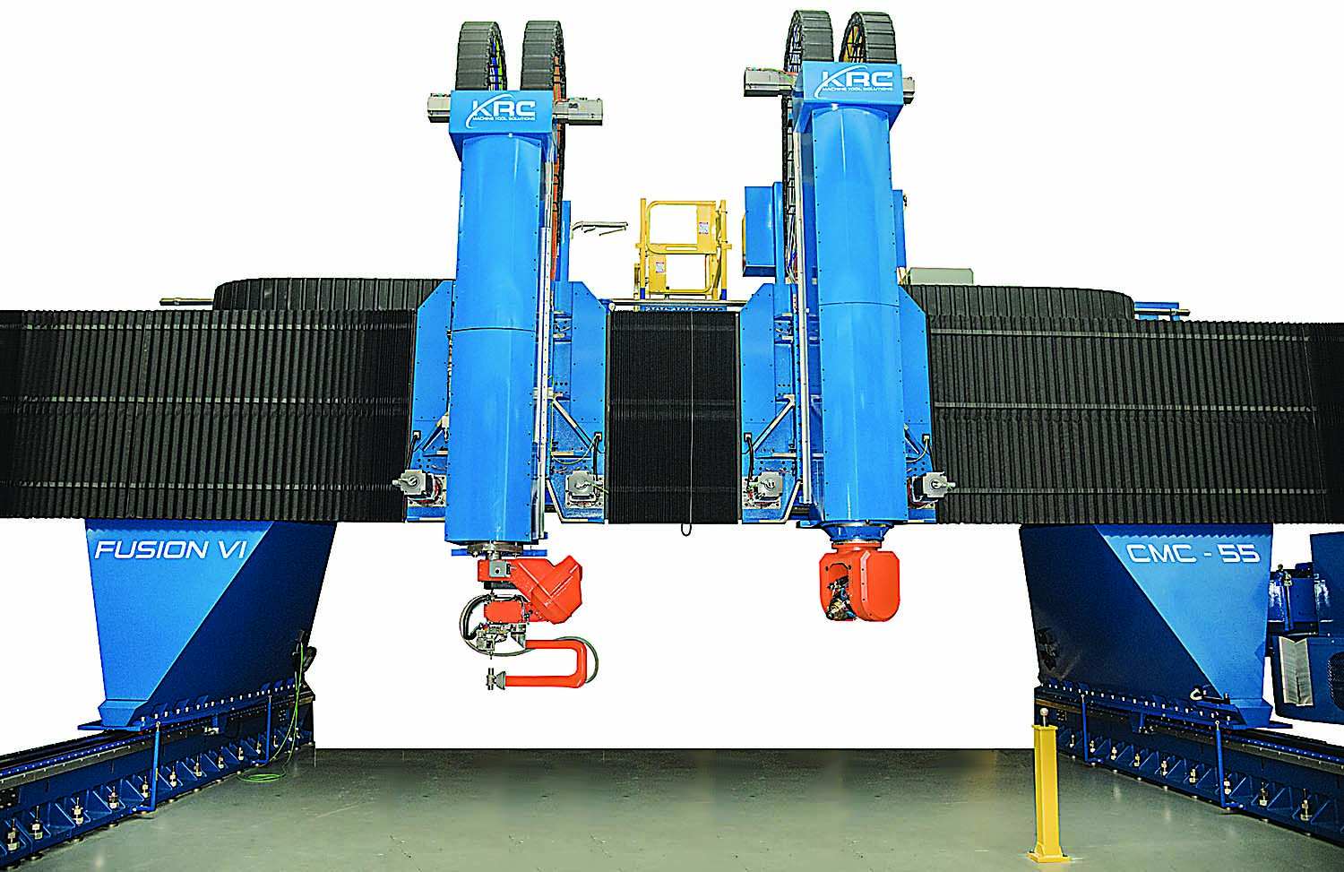

The Fusion VI gantry-style machine tool has two machining heads. Photo credit: KRC Machine Tool Solutions
The Fusion VI gantry-style machine tool has two machining heads that move in either five axes for milling or six axes for abrasive waterjet cutting. Image courtesy of KRC Machine Tool Solutions

To help continue its growth trajectory, KRC launched the Fusion VI series of multiple-process gantry-style machine tools with a movable bridge and dual vertical masts on parallel rails suspended above the work area. Last year, KRC entered into a technology agreement with Flow Aerospace Systems LLC, Jeffersonville, Indiana, and its partner, Ascent Aerospace LLC, Macomb, Michigan, for the rights to the design and manufacture of its Gen 5 gantry composite machining centers.
DeVore explained, however, that Flow Aerospace has since “shut their doors, and we were able to work with some of their former employees and bring them on board.” Those employees included the chief engineer and project manager.
With that expertise and KRC’s designing, building and retrofitting experience, KRC introduced the sixth-generation Fusion VI machine, which can perform trimming, drilling, routing, milling, marking and inspection in one setup. The two machining heads move in either five axes for milling or six axes for abrasive waterjetting, powered by Flow ultrahigh-pressure intensifiers and cutting heads, along the defined toolpath to produce a completed part. This configuration is tailored for processing composite aerostructures, as well as large parts made of various materials, according to the company.
