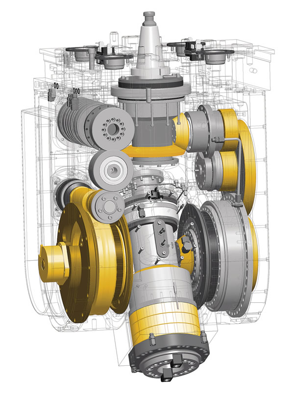

Milling head gear units include numerous parts that must be lubricated.
