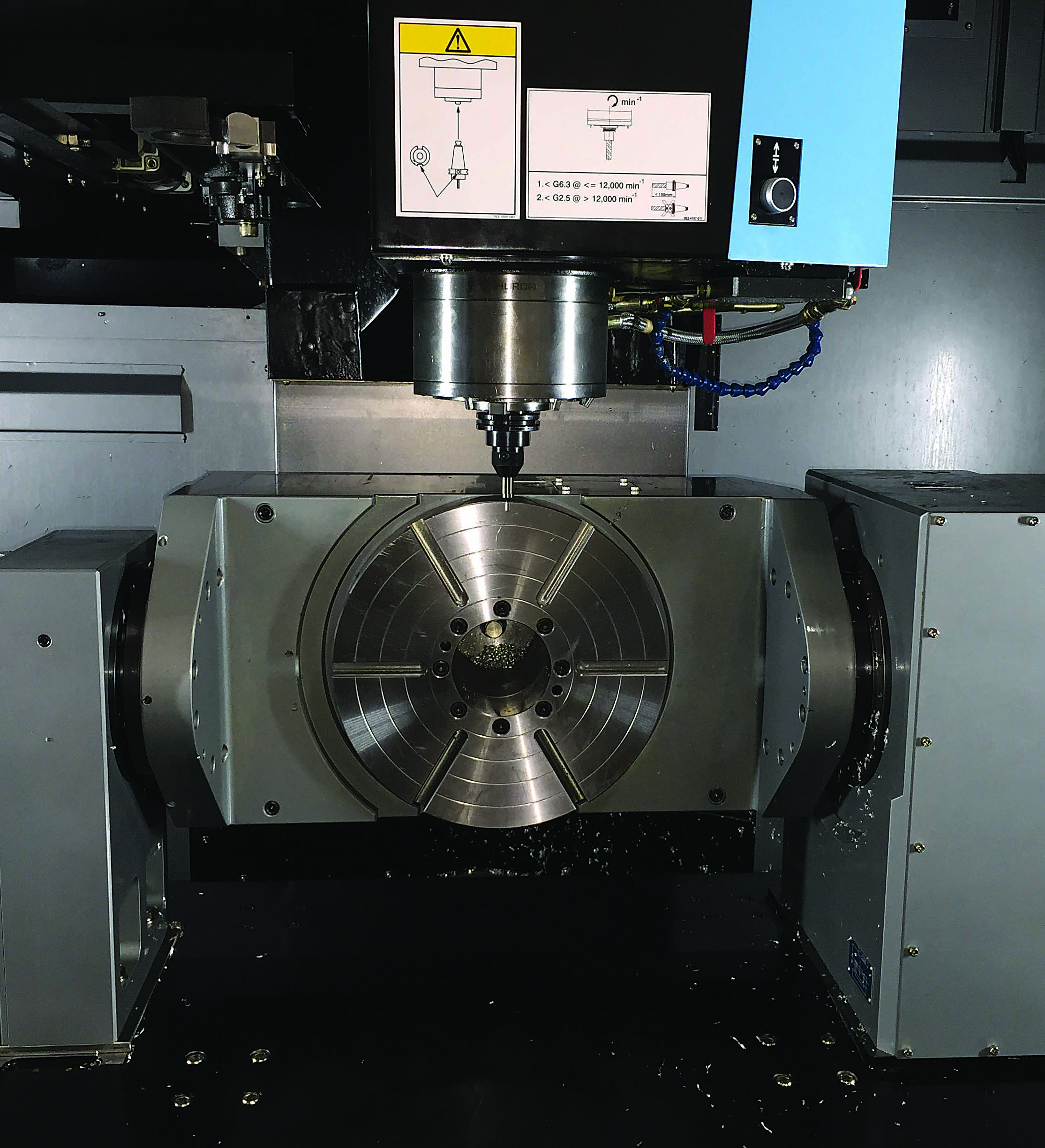

Figure 1. To find the true X and Y centerlines of rotation for the C-axis table, place the indicator and magnetic base on the table and indicate the inside of the spindle nose by rotating the C-axis table. Images courtesy of Hurco.

- Run an indicator across the surface of the C-axis table to ensure that the A-axis is flat.
- To find the true X and Y centerlines of rotation for the C-axis table, place the indicator and magnetic base on the table and indicate the inside of the spindle nose by rotating the C-axis table (Figure 1).
- Note the current X-Y machine position. This location is the X-Y centerline for the C-axis.

Figure 2. In this machine, the A-axis can tilt 110° forward but only 30° in the opposite direction.
The Y-axis centerline for the trunnion A-axis should be the same value found in the C-axis procedure. Even though it’s possible that the actual position is slightly different, you cannot verify the precise position because of the tilting limitations (in one direction) on most AC-style trunnion machines. For example, Figure 2 shows that the A-axis can tilt 110° forward but only 30° in the opposite direction. Because of this limitation, you can’t locate the true Y-axis centerline.
