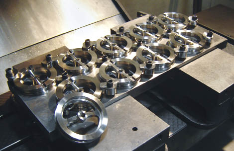

R&M Manufacturing engineered an efficient workholding setup and later changed the method used to cast workpiece blanks when machining stainless steel retainers used in food processing equipment.

On the VMC, Mitsubishi endmills applied at 350 sfm and 25 ipm milled the inside profile of the retainer and cut two 0.375 "-wide × 0.125 "-deep slots in the face of each part. To hold the retainers for this operation, R&M designed a fixture that handles nine parts simultaneously. Cagle noted that secure workholding was essential to maintain the 32µin. Ra surface finish the part required. To assure consistent part location, the fixture plate's base was fitted with pins that matched the central axial hole in each part.
Radial cutting forces were another concern. "Doing that contour, we were pushing the part, and it did have a tendency to rotate," Cagle said. That tendency was overcome by a series of 15 clamps. Every retainer was secured by a minimum of three clamps; some of the clamps contacted two or three parts, engaging the top sides or O-ring grooves of the retainers. "The more contact points, the more stable it was," Cagle said.
