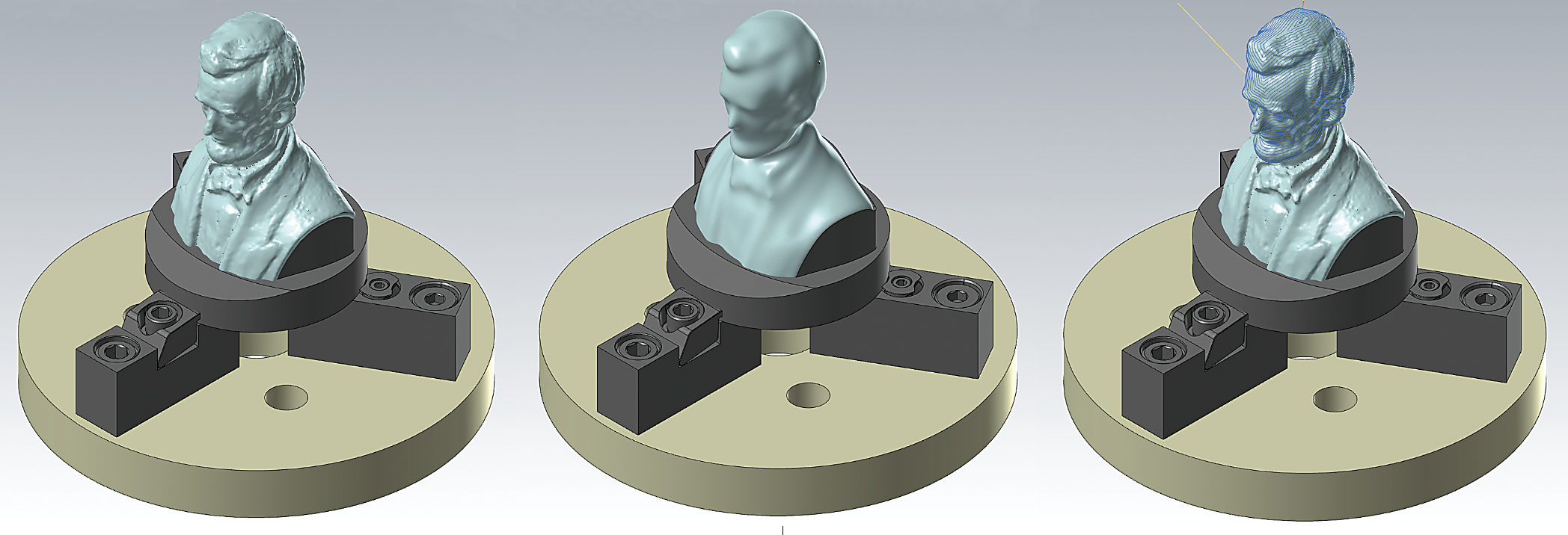

The original CAD model of the bust of Abraham Lincoln. In the middle is the smoothed model of the bust achieved through use of mesh-editing CAD tools. At right are the new toolpaths created after using mesh-editing tools.
The original CAD model of the bust of Abraham Lincoln. In the middle is the smoothed model of the bust achieved through use of mesh-editing CAD tools. At right are the new toolpaths created after using mesh-editing tools. Image courtesy of CNC Software

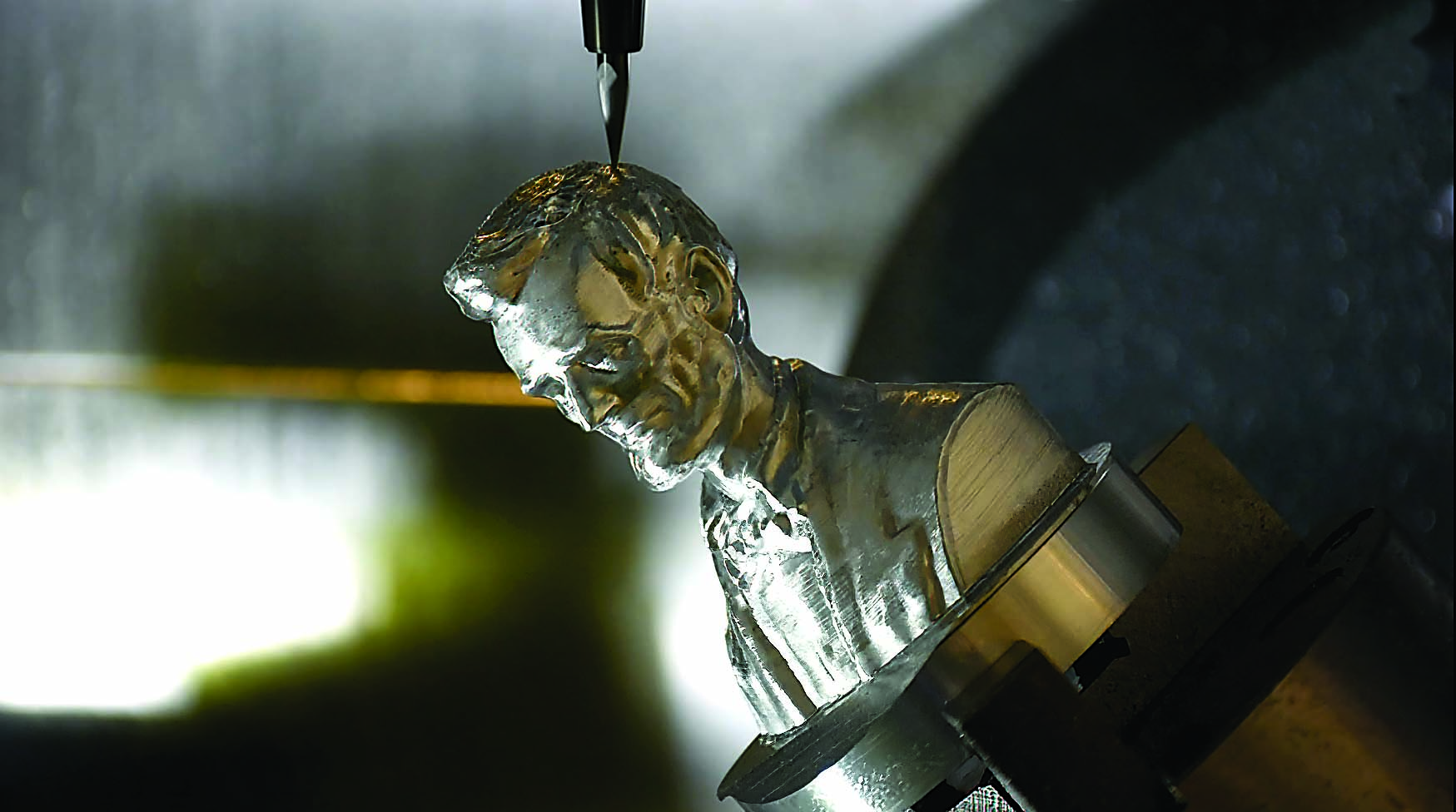

The resulting part shows the bust of Abraham Lincoln after machining using Mastercam's mesh editing and toolpaths.
The resulting part shows the bust of Abraham Lincoln after machining using Mastercam’s mesh editing and toolpaths. Image courtesy of CNC Software

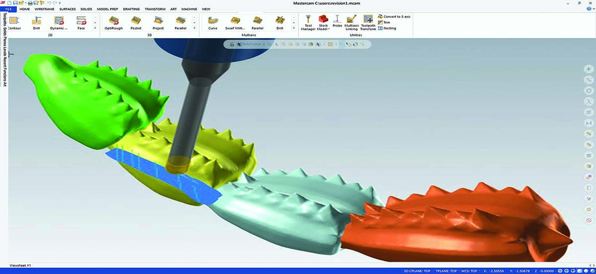

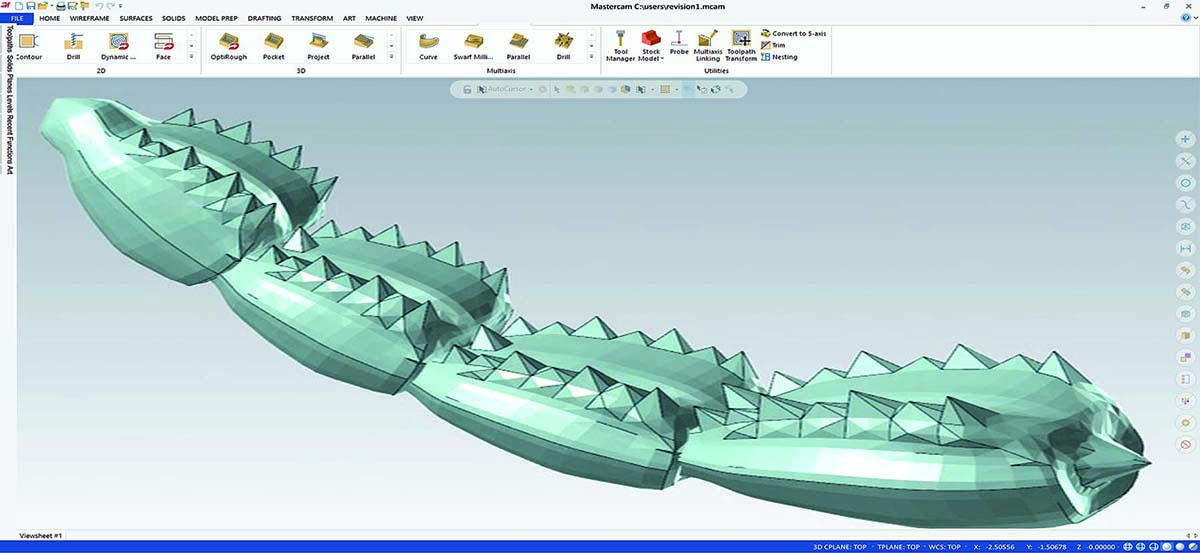

Displayed are images of an organically shaped mesh model being processed to create a Unified multi-axis toolpath. The model came in as a faceted mesh model. A CNC programmer broke it into individual components, smoothed the model to remove faceting and applied the Unified multi-axis toolpath. Image courtesy of CNC Software
In addition to smoothing model-cutting regions for cleaner cuts, mesh tools can be used with a multi-axis toolpath for machining complex shapes. Trying to control motion and not have the tool flip around can be challenging. For a recent Mastercam training session, we created a five-axis toolpath on a model of a bust of Abraham Lincoln, an organic shape. Our engineers used a mesh model and smoothing tools to achieve optimum motion and better tool-axis control. Initially, due to the amount of design detail, the tool tended to flip around. By making a copy of the original mesh and then smoothing out the fine detail, the tool flowed better and still cut the bust. Tilting was not as unpredictable. Using the original mesh to drive the toolpath and using the smoothed mesh as tool-axis control allow the programmer to create an uninterrupted continuous-motion toolpath.
