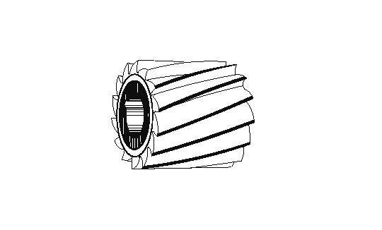

A plain milling cutter is able to rapidly remove a large volume of metal.

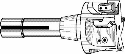

A facemill tooled with inserts.

Facemills are applied to smooth large, flat surfaces and to rapidly remove large volumes of metal. Facemills that accept inserts are available in a range of diameters, typically from ½ ” to 3 “. When run on vertical knee mills, lack of mill frame rigidity and the resulting chatter limit those machines to smaller diameter facemills. Facemills are more suitable for massive C-frame mills. When facemilling softer materials, such as aluminum and plastics, larger diameter facemills can be used without chatter.
Plain milling cutters are usually applied on horizontal machining centers on an arbor supported at both ends. Horizontal endmilling machines provide the power and rigidity needed to fully utilize the high metal-removal rates possible with plain milling cutters. However, a horizontal milling attachment permits the use of plain milling cutters on vertical knee mills. This is a useful accessory, even though a vertical knee mill must take lighter cuts than a horizontal mill because of rigidity and chatter issues. In a vertical knee mill with a horizontal milling attachment, the plain milling cutter removes more metal faster than other cutters. In some instances when lacking a horizontal milling machine, using several cutters on the same arbor is simply the best way to do the job. Plain mills are usually wider than the workpiece and cut completely across it.
Plain side milling cutters are similar to plain milling cutters, but they can also cut on their sides. Plain side milling cutters also cut slots, cut off heavy metal bars, smooth faces and cut material into strips. They can be mounted on an R8 toolholder with a single-end support but are best employed in a horizontal milling machine or in a horizontal milling attachment on a vertical knee mill, which is more rigid. Like the plain milling cutter, plain side mills can be mounted with other milling cutters to take multiple cuts simultaneously. CTE
