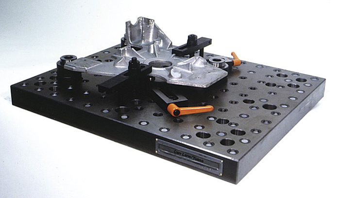

Irregularly shaped parts, such as this casting, can be clamped directly to a modular baseplate. Image courtesy Carr Lane Manufacturing.
Merriam-Webster defines modular as “having parts that can be connected or combined in different ways.” But to Colin Frost, chief business development officer at Carr Lane Manufacturing Co., St. Louis, modular means the ability to quickly and easily fixture most any job that comes through the door.
“For us, modular starts with a superaccurate, grid-style baseplate, tool block or angled plate that contains a series of bushed holes,” Frost said. “We use a hardened-steel threaded insert with a locating bushing over that, so customers can clamp and locate in the same hole.”
The company’s offerings include a seemingly endless assortment of mounting blocks, locating pins, adapters, clamps, stops, risers, rests and supports that either bolt directly to the baseplate grid or to one other. These components are available individually or in one of several “starter sets.”
“Modular fixturing kits are popular with shops that manufacture a variety of low-volume, complex parts on an infrequent basis, when a vise is unsuitable,” he said. “For example, we have a customer in Iowa that makes repair parts for agricultural equipment. Some of this is quite old, and, since they obviously don’t want to keep tooling on the shelf for 30 or 40 years, they use modular components to build whatever fixture is needed at the time, then tear it down when the job is done.”

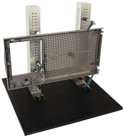

​A variety of modular components can be assembled to hold almost any workpiece, even on a coordinate measuring machine. Image courtesy TE-CO.
“No matter what comes down the pike, the goal should be fast and flexible workholding,” he said. “One way TE-CO accomplishes this is with a broad offering of quick-change jaw configurations and modular fixture plates that can be mounted in or on top of vises. This meets the needs of shops that want to mount their vises and leave them there.”
