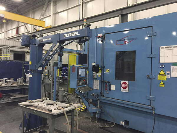

A jib crane moves parts and fixtures around the area for waterjet machining at Mitsubishi Hitachi Power Systems Americas.
A jib crane moves parts and fixtures around the area for waterjet machining at Mitsubishi Hitachi Power Systems Americas. All images courtesy C. Tate.

Jib cranes are simple machines that have an L-shaped construction with a mast that supports a single arm called the boom. A trolley and hoist mount on the boom and move in and out relative to the mast. This construction provides 360° of load rotation and allows the operator to place the load anywhere in the circular area under the crane. We use jib cranes for applications where loads are small and high maneuverability is required. Jib cranes are often less expensive and more easily relocated than other types of cranes, making them ideal for moving material for a single machine or around a work cell.
