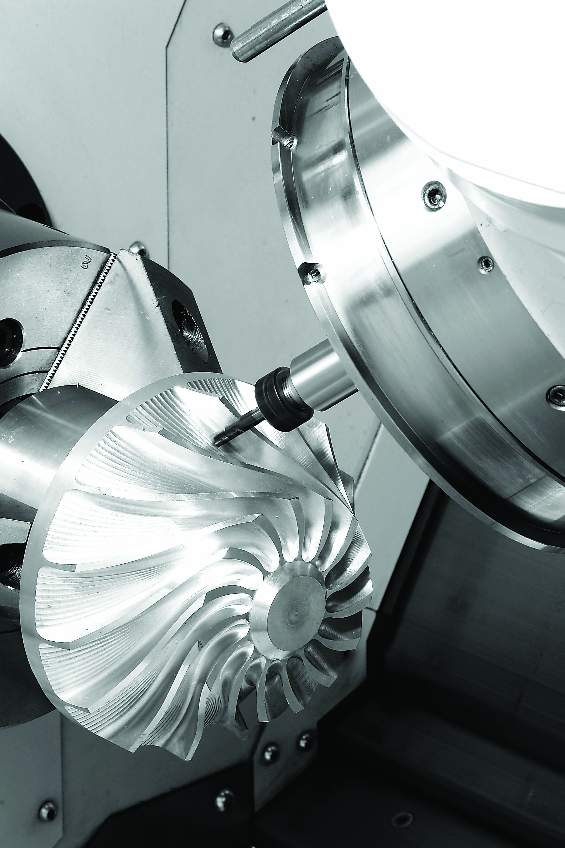

Suppose your company just bought an Okuma Multus, a Mazak Integrex, a DMG Mori CTX lathe or a similar do-everything-in-one-operation multitask machining center. Provided that the workpiece fits into the work envelope, these high-end mill-turn CNC machines are perfectly capable of milling the complex, free-form part features frequently found on aerospace and medical components that are typically reserved for 5-axis machining centers. They’re also darn good at 3+2 milling, able to machine complex valve bodies and similar parts without secondary processing. The decision, however, is whether what remains a lathe at heart is the best place to process such work.

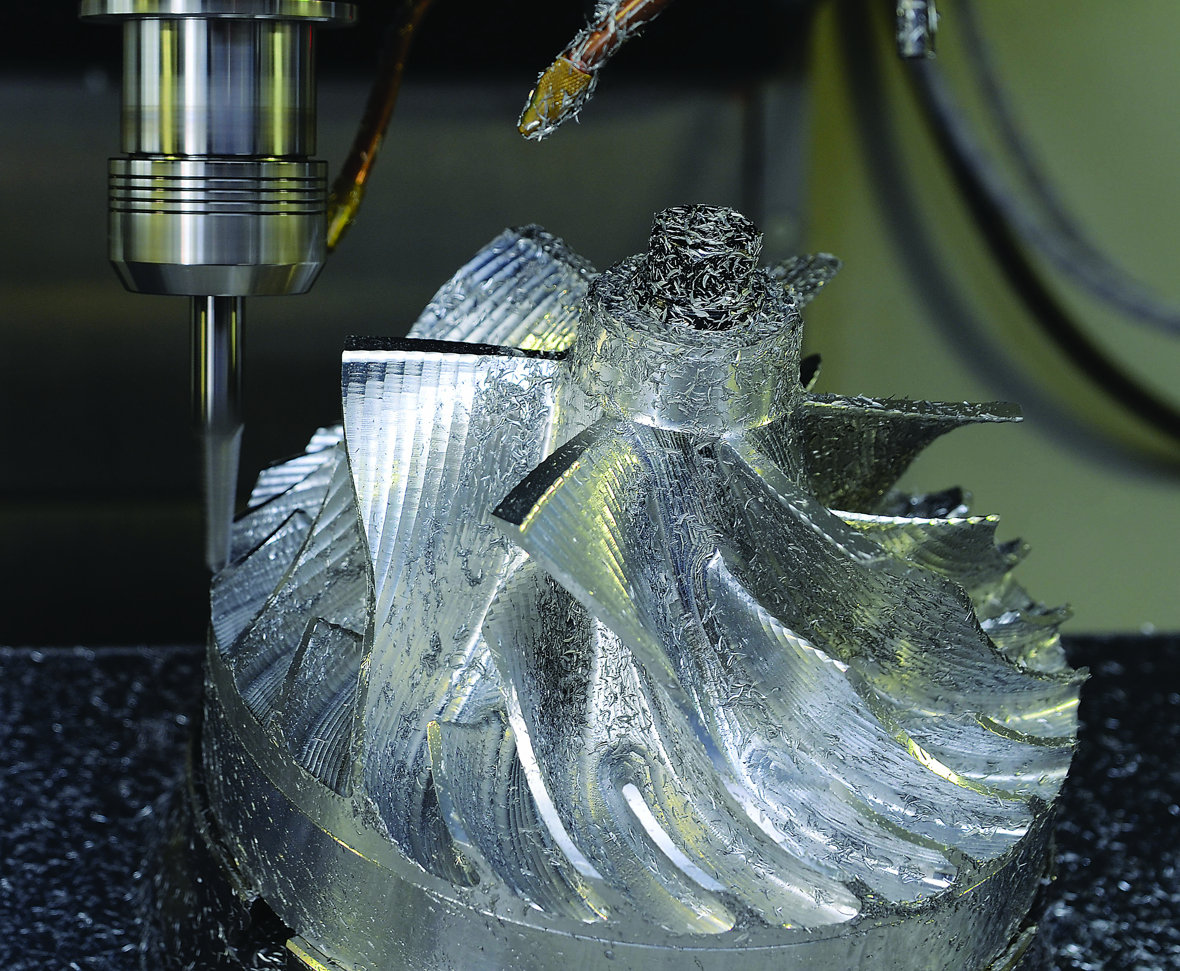

An impeller is machined on an Intergrex multitasker. Image courtesy of Mazak
Chuck Birkle offered a conditional yes. The vice president of sales and marketing at Florence, Ky.-based Mazak Corp. listed a number of applications in which traditional 5-axis machined parts are often more suitable for a multitask lathe than they are for the milling department. These include blades and blisks, propellers, orthopedic components such as knee implants, pump bodies and other “roundish” parts, as well as a few that most people would never guess came off a lathe despite its milling capabilities.
“We worked with a major aircraft manufacturer that was making an aluminum steering component,” he said. “The part looks a lot like a turkey wishbone. They were previously producing them on their machining center but were tired of buying and maintaining multiple fixtures and then having to modify them whenever an engineering change came along. So they put it on an Integrex. They now use round aluminum bar stock, remove a very high percentage of the raw material, then snap the completed part off the base and deburr the bottom. Their fixturing is a 3-jaw chuck, and there’s just one operation.”
Birkle ticked off a number of other parts for which his customers saw significant improvements. One customer reduced lead times on a series of parts for aircraft landing gear from weeks to hours. A pump manufacturer slashed from five to one the number of setups needed to complete a valve body the size of a dinner table. And because multitask machines improve part quality, a leading heavy-equipment engine producer greatly reduced downstream grinding time.

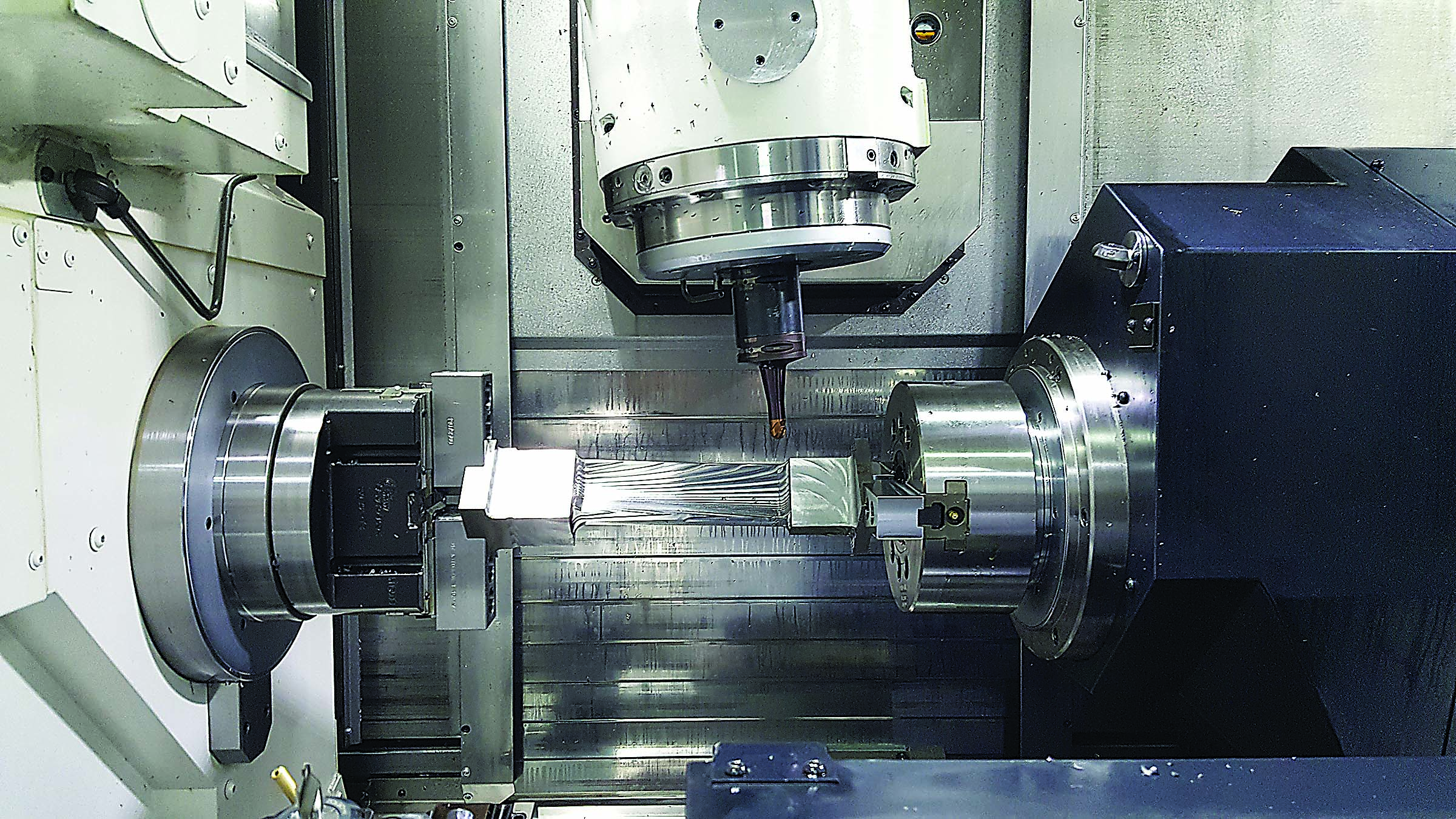

Thanks to their ability to support both ends of long workpieces, multitask lathes are commonly used to machine turbine blades and other rotor components. Image courtesy of Okuma America

“With 5-axis machining centers, you typically need a fairly large work envelope relative to the part size because you’re swinging the workpiece around, trying to reach the part with the milling cutter,” he said. “That, and the fixturing and sometimes the table can create interference, so you need to lift the part up relatively high or use extended-reach tooling. You don’t have these restrictions with a lathe.”
On a multitask lathe, the workholder is the chuck. The B-axis movement is achieved by rotating the turret, and the C-axis is the lathe spindle. This construction makes it easier to reach many part features with a milling cutter. Because the part can be held between both spindles or between a spindle and tailstock, its length is less constrained than with a 5-axis machining center.
“This makes it ideal for long parts, like large turbine blades or shafts with complex milling work, which you’d otherwise need a very large machining center to complete,” Fischer said.

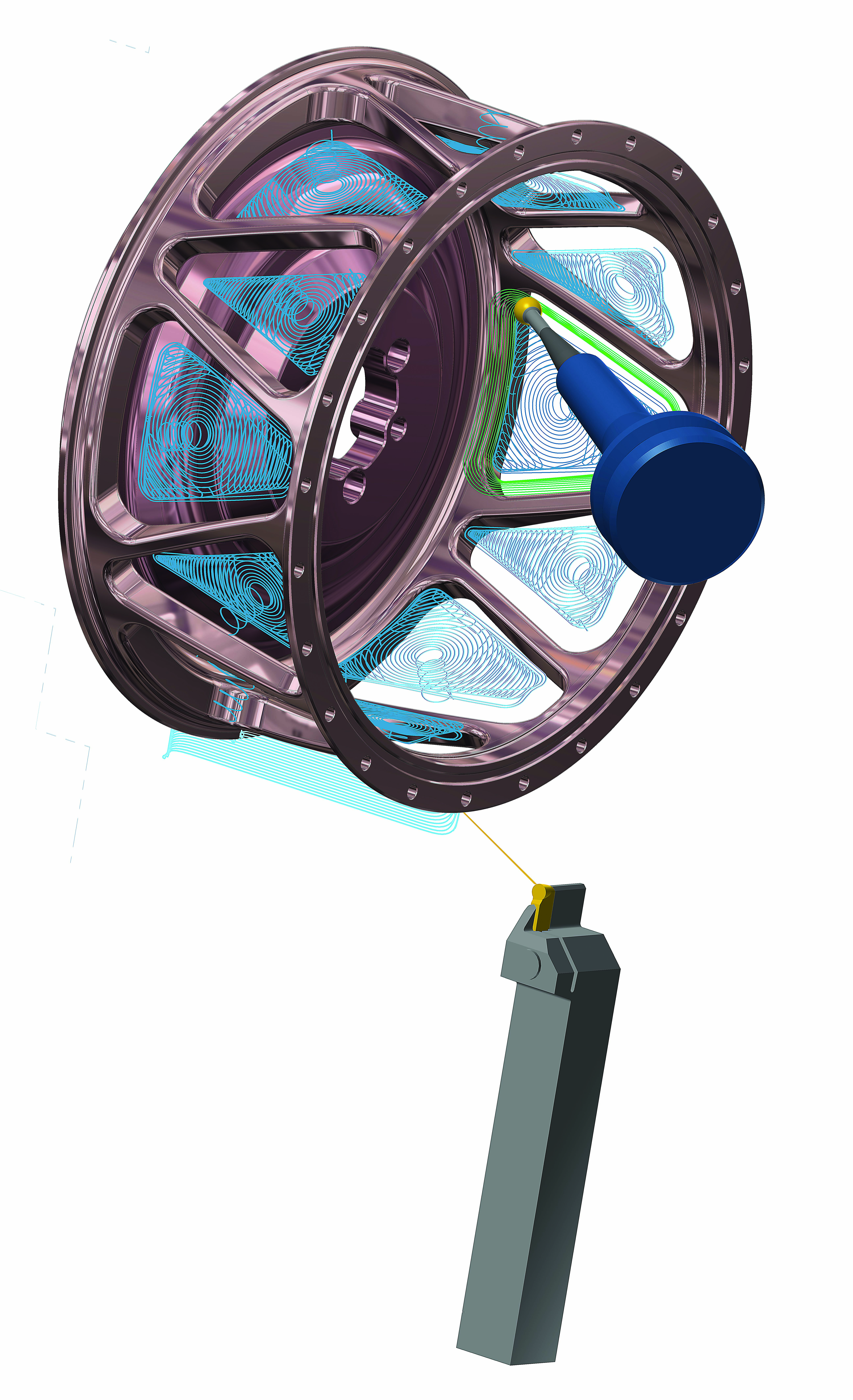

Toolpath simulation is an important step toward collision avoidance. It also gives the programmer an additional opportunity to further optimize the machining process. Image courtesy of CNC Software

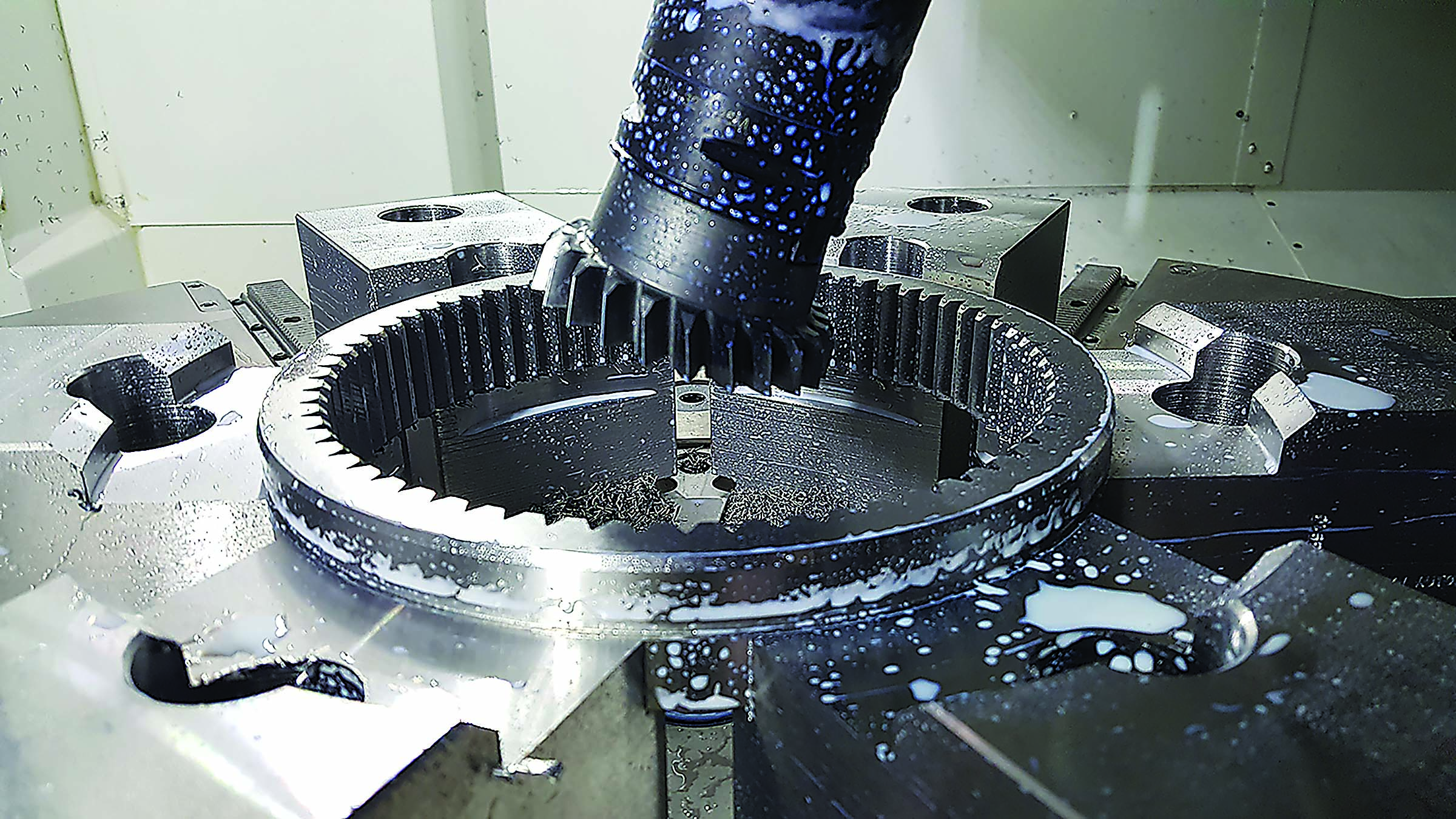

Okuma Application Engineer Chris Peluso said skiving and hobbing—two operations traditionally completed on a dedicated machine tool—are easily performed on a 5-axis multitasker. “The tooling looks a little different and acts a little differently, but long shafts with splines on them, for example, are easy to finish in one operation. The same can be said for internal gears that would normally be broached or shaped. Why not set up one machine that can do this rather than invest in specialty machines, especially when you only need to do it occasionally? The tools are all there. There’s less part handling. It even uses the same G and M codes, so the programming will be familiar to any CNC lathe operator.”

Ben Mund, senior market analyst at Mastercam CAD/CAM software developer CNC Software Inc., Tolland, Conn., agreed that programming a 5-axis multitask lathe shouldn’t be a scary proposition.
“It’s virtually identical,” he said. “You’re using milling toolpaths for the milling portion and turning toolpaths for the turning portion. About the only thing that’s different is that there’s probably going to be more going at one time with a mill-turn machine. You might have two spindles and two or three turrets working simultaneously, and you need to take the extra step of making sure there won’t be any interference. That’s why toolpath and machine tool simulation is crucial on a mill-turn.”

Skiving, shaping, broaching and more are possible on this 5-axis multitask vertical turret lathe from Okuma. Image courtesy of Okuma America
For those wondering if a new CAM module—or even an entirely new CAM system—will be required after purchasing a multitasking machine, Mund said not necessarily. Shops faced with programming a mill-turn machine can continue to use their machining center module for any milling and their lathe module for turning. They can then merge the two disparate programs by hand.
That approach, however, is probably not going to be as effective as dedicated mill-turn software, which takes care of orchestrating multiple machine axes, synchronizing tool motion and ensuring that the CNC program is as efficient as possible. Having a mill-turn-specific programming package also does the best job of toolpath simulation.
