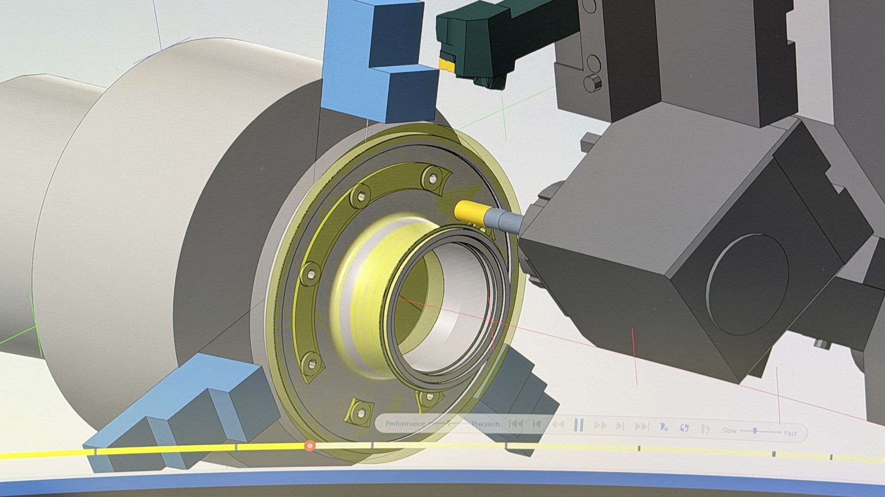

JR Machine frequently machines heat-resistant superalloys, which was the case for a family of 60 parts in various sizes that were made of 718 Inconel, said Brent Berholtz, JR Machine’s engineering manager. The parts were initially machined on a DMG Mori NLX 2500 three-axis CNC turning center, which required creation of an in-house fixture to hold the part after the second operation. Completing the part, which has some 45° angles with small step-downs and chamfers, required three operations and three setups.
Looking to streamline the 11-hour production process, JR Machine purchased the Mastercam Multiaxis add-on for its Mastercam CAD/CAM software from CNC Software LLC in Tolland, Connecticut, Berholtz noted. JR Machine started using Mastercam in 2010 and in 2024 incorporated the multiaxis machining add-on, which enables simultaneous four- and five-axis machining capabilities with advanced toolpath strategies and reduced setup times.
Kunschke noted that JR Machine purchased the software from ShopWare but now works directly with Mastercam.
The job shop also moved production of the part family to a DMG Mori NTX machine, which provides simultaneous five-axis machining with the direct drive motor on the B-axis.
“We used to run them on an NLX 2500 and the capabilities on that machine are very fast yet very limited to the capacities that we have on our DMG Mori NTX machines,” Kunschke said. “That machine’s capabilities matched with the mill-turn software is what drives us to be able to make this in one operation.”
Instead of performing three setups and three operations, JR Machine was able to machine parts complete in one five-axis machine, eliminating the fixture operation by being able to grab the bar stock with the main spindle, transfer it to the secondary spindle and finish the operation while cutting the cycle time by about 50%, Berholtz said. “You get those two matched together perfectly. If you only had the machine, you wouldn’t be able to have that much cycle time reduction. If you only had the software, you won’t be able to have that. You have to get it from both sides.”

(Picture 1.png)
JR Machine incorporated the Mastercam CAD/CAM multiaxis machining add-on, which enables simultaneous 4- and 5-axis machining capabilities with advanced toolpath strategies and reduced setup times.
