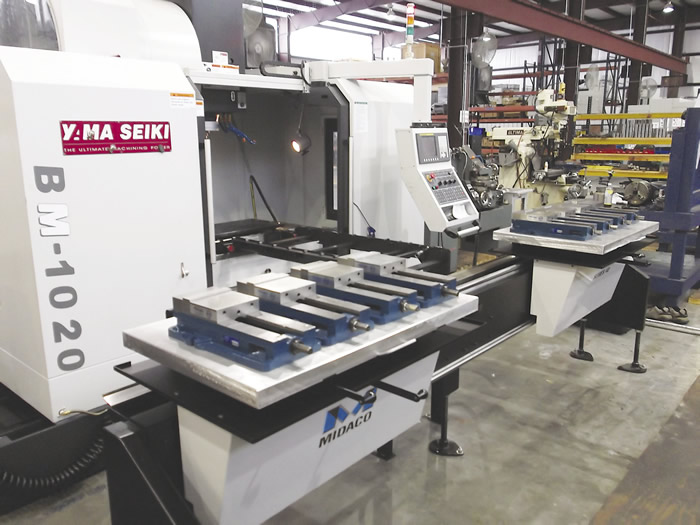

Manual pallet changers allow operators to load parts onto one pallet while another is being machined, then simply load the new one when the process is completed.

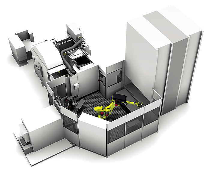

There are three main types of pallet changers—manual, automated and robotic—but the underlying principle is the same: As soon as one pallet full of finished parts is unloaded from the machine, a new pallet of parts to be machined is put in.
With manual pallet changers, the operator physically loads and unloads pallets via a receiving bay on the front of the machine. Automated systems can be loaded with pallets, but the load/unload process is handled by the machine itself. Robotic systems utilize a arm to load and unload pallets, with each arm able to serve multiple machines.

Several types of pallet systems are available, with manual styles being the most basic. These systems involve installing a receiver bay on the front of the machine into which an operator loads a pallet of parts to be machined. The pallet is then brought inside the machine tool. This allows the operator to load new blanks onto the next pallet. When the part or parts on the pallet in the machine are done, it can simply be swapped for a different pallet loaded with blanks for machining.
“By dedicating pallets for different jobs, you can eliminate a lot of redundancies,” Midaco’s Munao said. “Whether it’s vises, table work or whatever the customer is doing on a daily basis, they can have pallets dedicated to that type of work ready to go, so there’s a lot less setup time getting the parts into the
machine.”
In addition to a manual system’s relatively low cost—Midaco offers manual pallet changers that start at around $20,000—it also occupies little floor space.

While an automatic system is mounted to the side of a VMC, Munao added, a manual system sits in front of the machine, where a human is able to physically load pallets into the pallet changer. “People put their machines very close together, so there might not be much room side-to-side, but there’s always room in front of the machine.”

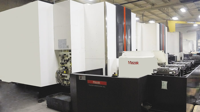

An automatic pallet changer provides all the benefits of a manual changer, explained Midaco’s Munao, but it changes automatically through the machine control, making the changer machine-driven rather than operator-driven.

“You can load the machine up with parts, push the button, and it’ll bring the second pallet of parts in to be machined when the first is done,” he said. “That machine can now run unattended for 3 to 4 hours.”

Robotic Reach
The third primary method of pallet changing is robotic. While robots have their own drawbacks—namely cost—they get results.
“We’ve [installed] quite a few pedestal-style robotic palleting systems for our larger, Tier 1 automotive customers,” said Mazak’s Ware. “In those situations, we will typically work with another company that supplies the robotics while we handle the integration.”

Mazak's Palletech system is a fully automated pallet changer, allowing unattended machining.
Mazak’s Palletech system is a fully automated pallet changer, allowing unattended machining. Image courtesy Mazak.

Fastems LLC, West Chester, Ohio, a third-party integrator of flexible manufacturing systems (FMS), works exclusively with RGVs (rail-guided vehicles) and robots when supplying pallet systems, explained Robert Humphreys, the company’s Western U.S. sales manager. The reason is because Fastems eschews traditional 3-axis VMCs for 5-axis versions.
Because 5-axis vertical machines are relatively expensive “when compared to lower-cost standard VMCs,” Humphreys said, “it’s easier to justify the high cost of robotic automation for 5-axis machines. The goal is to maximize spindle hours, and when the spindle hours are worth more than the machine tool and the manpower that you put in front of the machine, that’s when [robotics] becomes a worthwhile investment with a fast ROI.”
What kind of investment? A basic FMS that can serve three 5-axis VMCs will cost in the neighborhood of $800,000, Humphreys said.
“If you take those three machine tools and have 40 different jobs to run between the three spindles, you’d be constantly changing between pallets and see your spindle utilization collapse to 30, at best 40, percent,” he said. “Investing in an FMS could increase the spindle utilization in excess of 85 percent. In addition, if you have three shifts running three machines, you could need up to nine skilled operators. With an FMS, you can do the same amount of work with one operator per shift, so your savings can be huge.”
