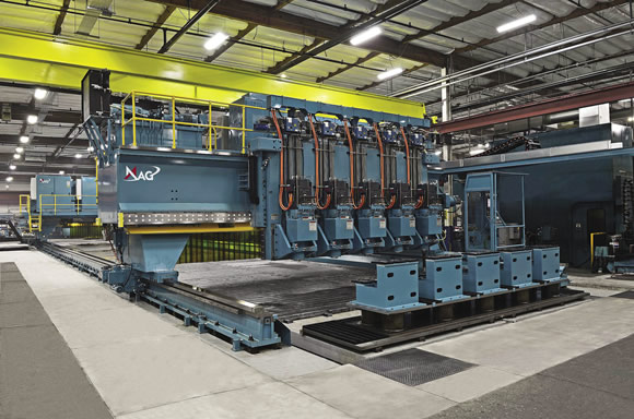

FLI-MAG-6-axis%20profiler%20w-flextool.tif
Courtesy of MAG
A MAG 6-axis gantry profiler, with the optional Flexitool universal holding fixture, performs high-speed/high-performance machining of a skin panel.
The Okuma Sampling Path (OSP) control has a control-feedback-loop speed from 3 to 5 milliseconds, enabling it to feed at 1,000 ipm without stuttering, and its new P300 CNC has a speed from zero to 3 milliseconds, according to Endsley. “Theoretically it’s zero; it’s like nine places to the right of the decimal.”
