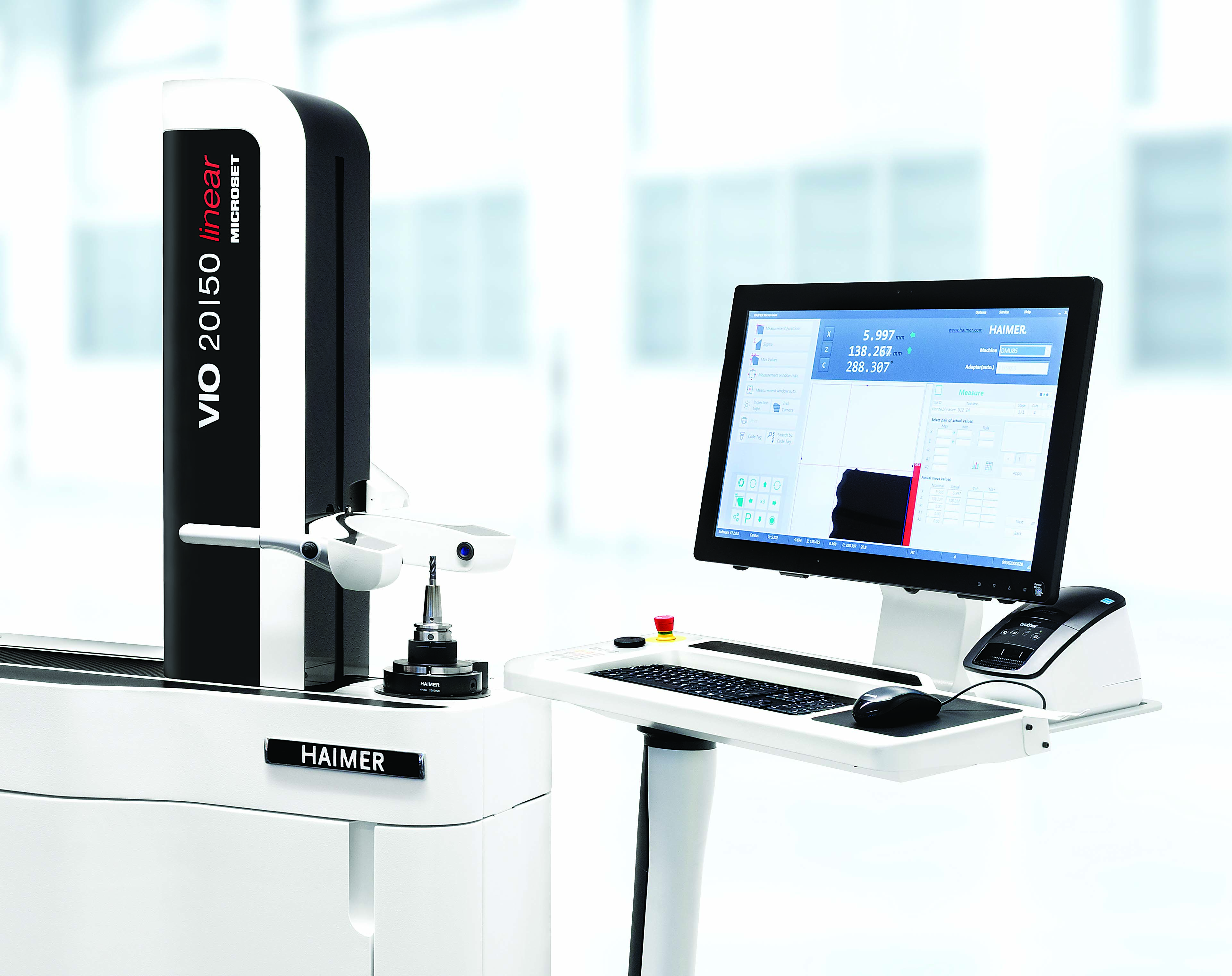

Haimer USA’s VIO 20|50 linear Microset presetter. Image courtesy of Haimer USA

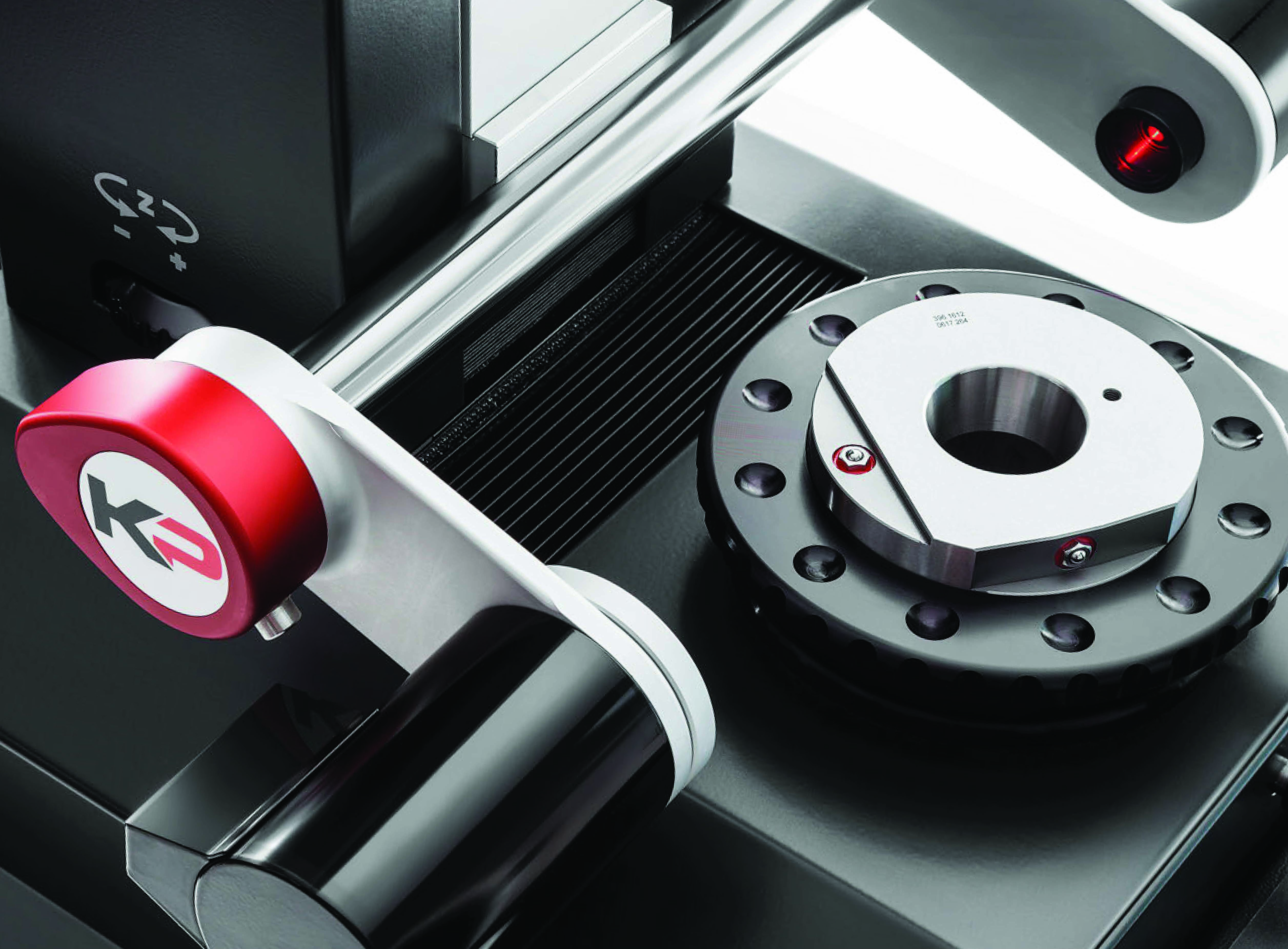

Koma Precision’s Prime is an entry-level noncontact tool presetter. Image courtesy of Koma Precision

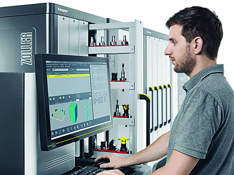

An operator (above) uses Zoller’s TMS Tool Management Solutions hardware, or smart cabinets. Image courtesy Zoller

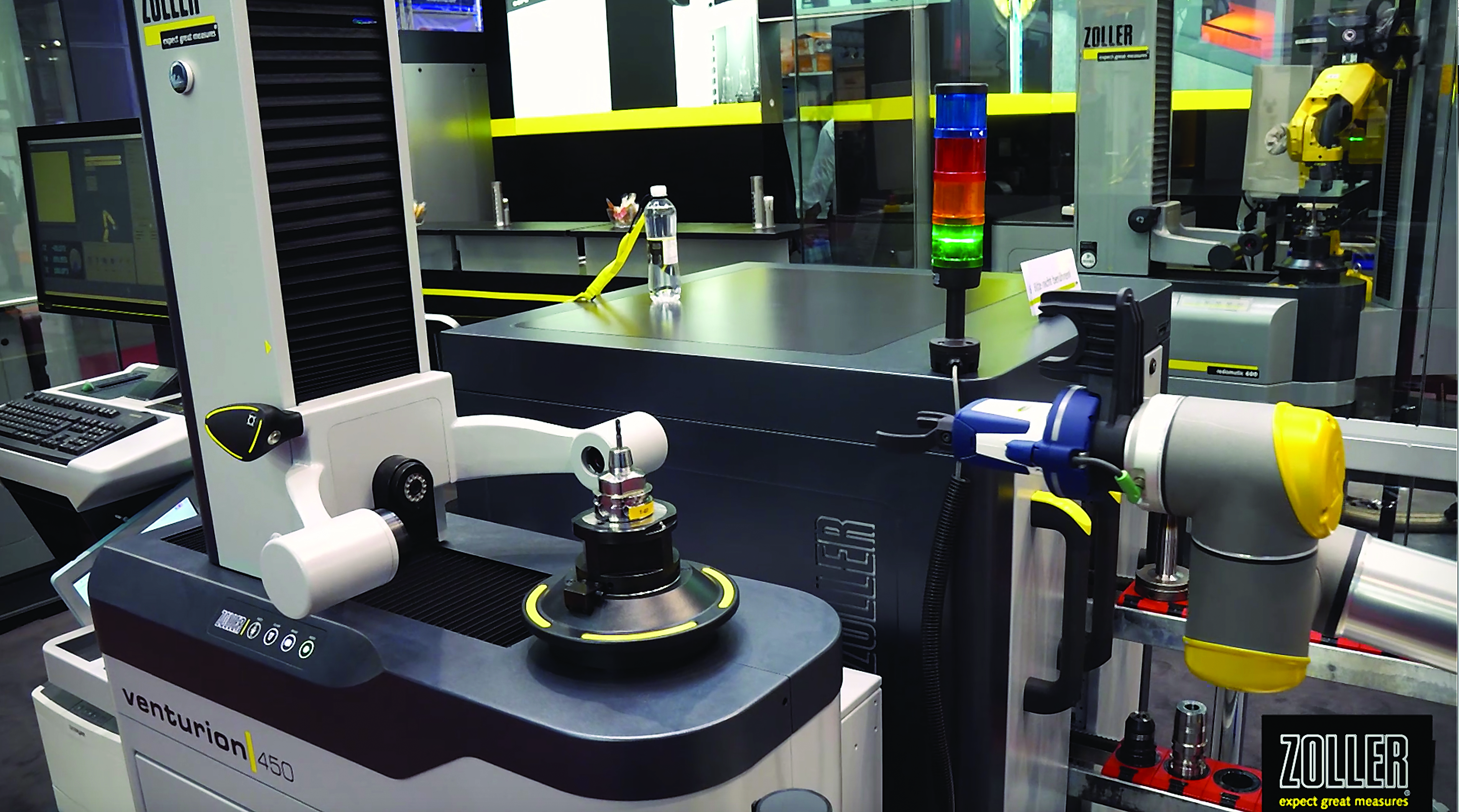

Zoller developers and engineers also created »cora«, short for collaborative robotic assistant, which is displayed at the showroom in Ann Arbor. He said »cora« is a self-contained tool measurement system. It picks, cleans, assembles, clamps, measures and stores tools and tool assemblies, then automatically places them into a tool cart for dispatch to the shop floor.
