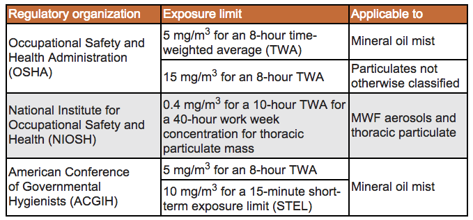

Three different entities have established and published exposure limits that apply to MWFs: OSHA, National Institute for Occupational Safety and Health, and American Conference of Governmental Hygienists (Table 1 below).
​Table 1. Exposure Limits for Metalworking Fluids
OSHA also published the Metalworking Fluids: Safety and Health Best Practices Manual in 2001, which incorporates recommendations from multiple sources. It does not carry the force of law or regulation, but it is meant to be advisory and informational. Its goal is to help employers develop prevention programs that will create safer workplaces for employees exposed to MWFs.
The list of adverse health effects associated with MWFs is long. It includes respiratory ailments such as asthma, chronic bronchitis and hypersensitivity pneumonitis; pancreatic, colon, bladder and liver cancers and tumors of the brain and respiratory organs; contact dermatitis, eczema and other skin disorders; irritation to the respiratory tract and mucous membranes; and changes in organs, as well as potential nerve damage, damage to genetic material and immune
disorders.
The exposure limits defined in Table 1 have been developed to protect workers against many of these adverse health effects. If your facility is meeting OSHA requirements but workers are still experiencing symptoms, it may be necessary to set lower limits.

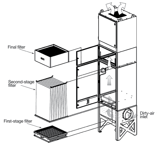

Figure 1. A fiberglass V-bag-style mist collector.
Mist Collectors
A variety of equipment captures mists generated when these coolants and lubricants are applied. Most commonly used are multiple-stage, fiberglass V-bag mist collectors (Figure 1). These units feature a first-stage Chevron metal filter, a second-stage aluminum mesh filter and a third-stage fiberglass V-bag with a 95 percent ASHRAE (formerly American Society of Heating, Refrigerating and Air-Conditioning Engineers) efficiency rating. The efficiency rating is a bit misleading in that it has nothing to do with oil removal. The ASHRAE rating system is used to measure efficiency in removing dry particulates. Most units also offer an optional fourth-stage HEPA final filter for added protection and cleanliness. A HEPA filter is usually designed to remove 99.97 percent of airborne particles measuring 0.3µm or greater in diameter.

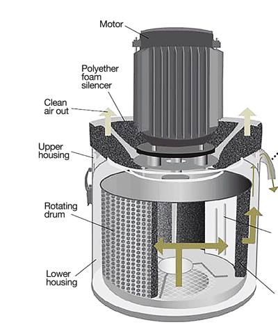

Also prevalent are centrifugal-type mist collectors that use a rotating drum to spin the oil (Figure 2). Typically, a pad inside the unit functions as a final filter, but most contaminants are removed by the rotating action of the drum. If chips collect in too high a volume, the unit can become unbalanced and malfunction, creating a health hazard and a maintenance headache.
Figure 2. A centrifugal-type mist collector.
Both styles of collectors are usually designed for double duty, meaning they are used on straight oil and emulsion coolants. As a rule of thumb, they work well in light-duty applications but are not as effective for heavy-duty use and long production runs. V-bag and centrifugal collectors have a relatively low initial cost but are limited in terms of run time, filter service life and filtration efficiencies.

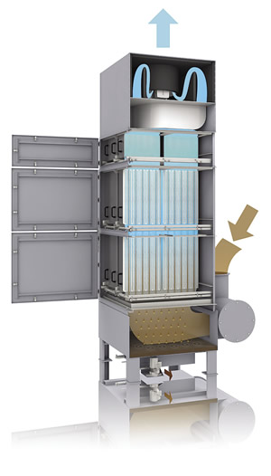

Figure 3. A high-efficiency mist collector for emulsions and coolant oils.
Figure 3 shows a high-efficiency mist collector for removing airborne contaminants emitted by water-based coolants and emulsions. It uses two stages of long-life coarse and fine-filter demisters and a final-stage HEPA filter; the high-efficiency mist collector offers a capture efficiency of 99.9 percent on particles 0.3µm and larger. This is much higher than the capture efficiencies achieved with fiberglass V-bag filters. The HEPA-filter stage is optional and is typically used for processes that generate smoke or very fine particulate.
This unit also has a patented integrated spraying system that performs two functions: It counteracts emulsion “clumping” in the system by maintaining the correct balance of water to oil, and it cleans the demister filters. This self-cleaning system reduces maintenance and extends filter life.

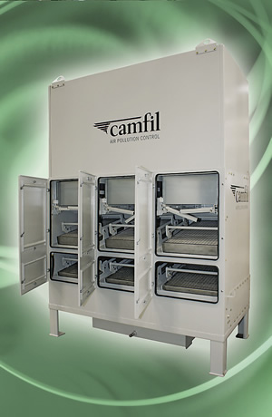

Figure 4 shows a mist collector designed for pure or straight lubricant oils. A first-stage coarse-mesh filter removes large particles and chips, followed by two stages of diffusion filters: a prefilter and fine filter. Media separators in the filter packs allow optimal airflow while providing maximum usable media area within a compact space.
This design combines high-efficiency separation performance and a self-cleaning capability via drainage of the separated cooling lubricant. Benefits include reduced energy consumption, extended filter life and enhanced protection of the optional HEPA final filter, which may be used for removal of ultrafine mists, clean-air recirculation or both.
Figure 4. A high-efficiency mist collector for straight oils.
Achieving separation efficiencies up to 99.97 percent on 0.3µm and larger particles, it can operate 24/7 and withstand the most challenging applications.
