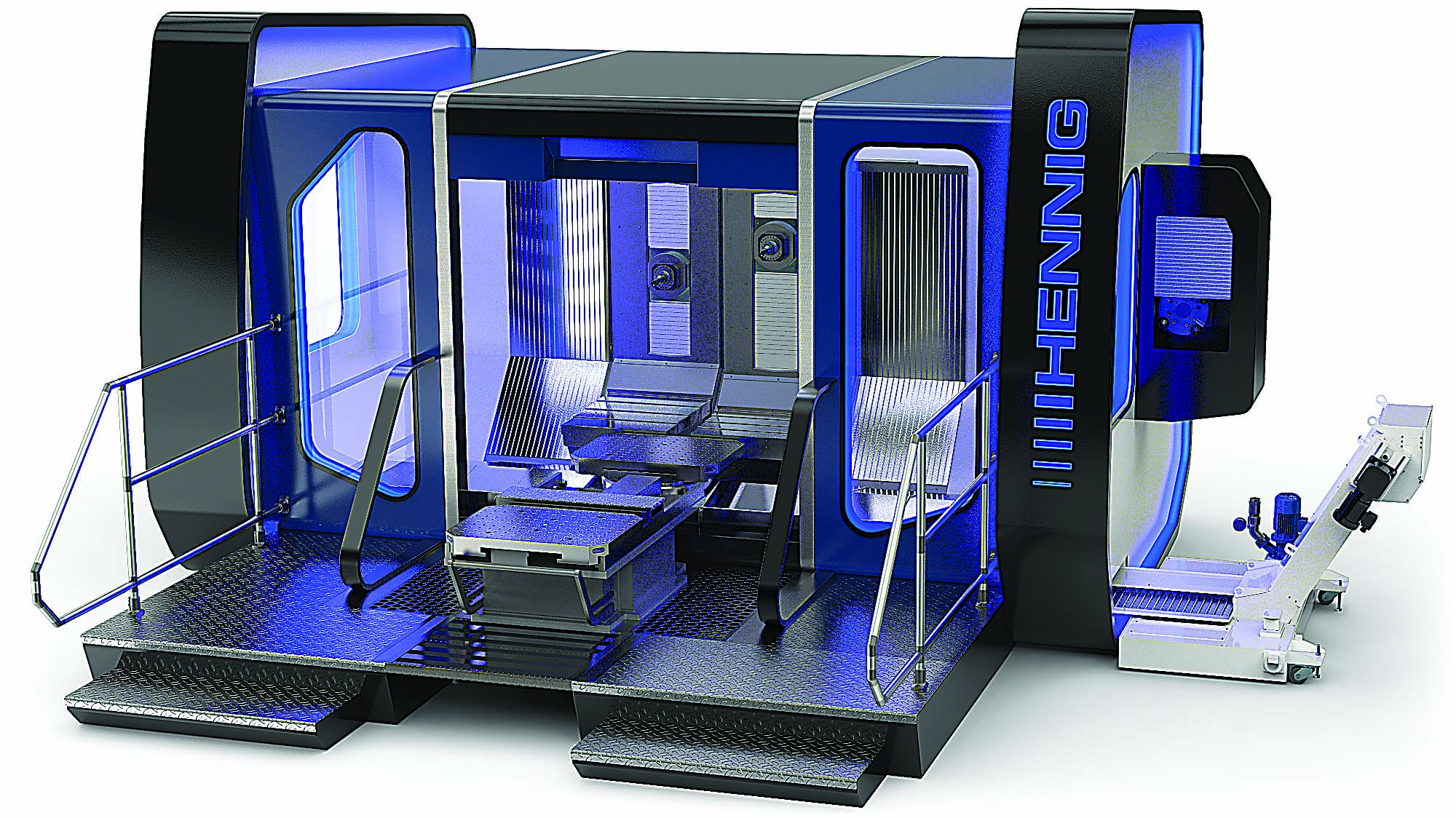

A machine enclosure protects operators from injury and machinery from damage. Image courtesy of Hennig.

For many applications, metal is the preferred choice for enclosure panels. Hennig Inc., Machesney Park, Ill., makes most of its enclosure panels out of cold-rolled steel. The thickness of these panels varies from 14 to 7 gauge, depending on the machine’s spindle speed, according to Frank Chavez, engineering and business unit manager of Hennig’s fabrications division. (Spindle speed determines how fast a projectile exits a machine.)
Instead of cold-rolled steel, Hennig sometimes opts for stainless steel enclosure panels. With its smoother surface, stainless steel can be a little better at deflecting chips and coolant coming from the work zone, Chavez said. Another option for Hennig is aluminum, which can be used to lighten the loads of large enclosure panels.
When enclosure panels are made of metal, windows allow machine operators to see inside. According to Chavez, Hennig enclosures include “safety-level” windows made of materials such as laminated glass, which consists of a protective vinyl layer inside two glass layers.

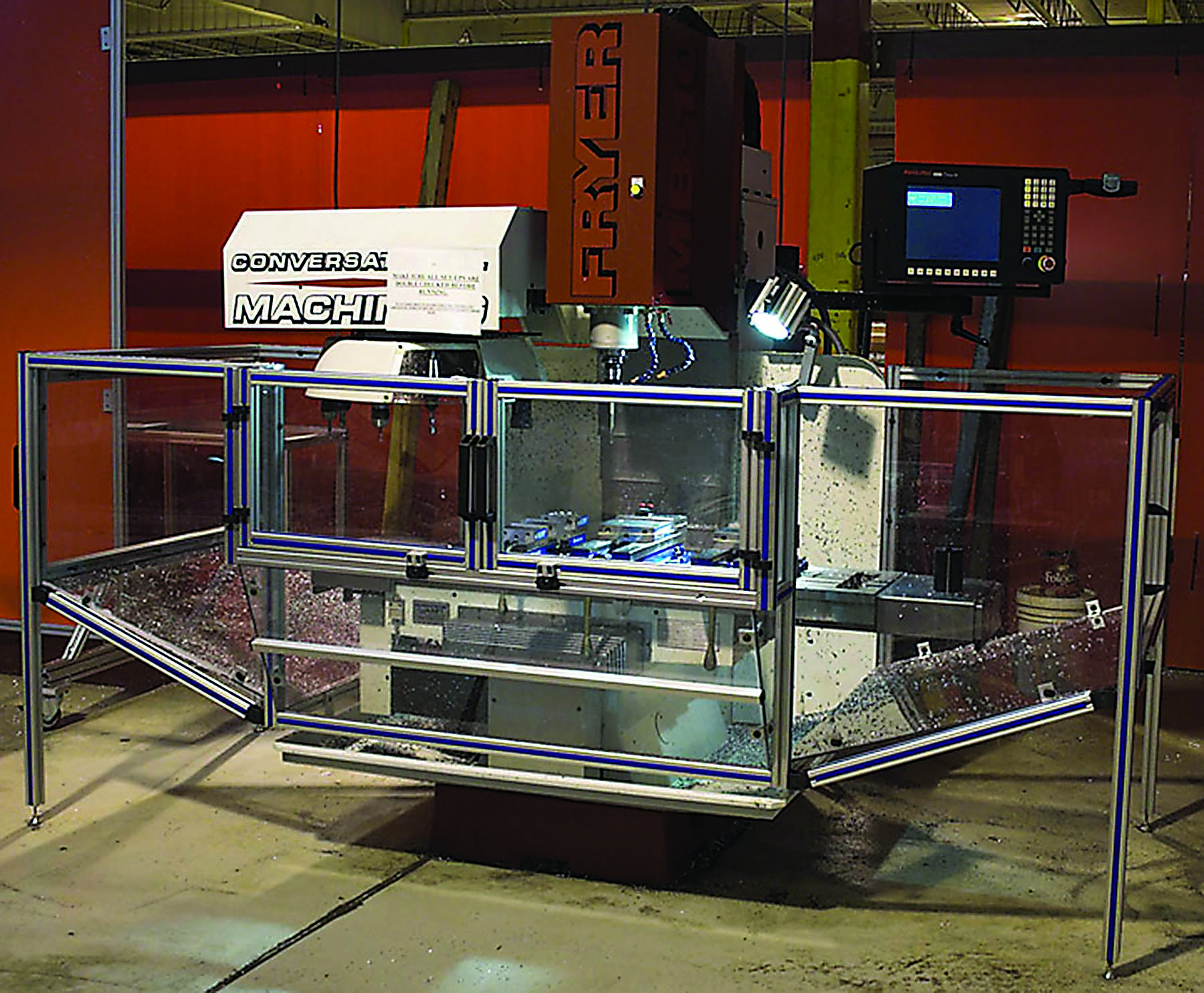

Other enclosure options besides those with metal panels include wire mesh and plastic structures, both of which Faztek sells. “If the customer is trying to keep peoples’ fingers out of the machining area and keep large chunks of material from flying out, we can use a wire mesh,” McDevitt said. However, “if some type of coolant is being sprayed around and the customer needs to have good visibility into the machine, we will go with polycarbonate.”
Faztek uses 3⁄16″- or 1⁄2″- thick polycarbonate sheets to make its transparent plastic enclosures, depending on the impact resistance needed. “If your machine tool is throwing out 1″×1″ boring chips at 400 mph, we would go with 1⁄2″ polycarbonate sheet,” McDevitt said.
In some cases, only steel panels may be able to provide enough impact resistance to deflect large chunks of material flying from the machining area, McDevitt said. Steel is also a better choice for applications generating extreme heat that could melt plastic panels, he added.
Faztek designed this enclosure for a customer’s machine. Image courtesy of Faztek.
