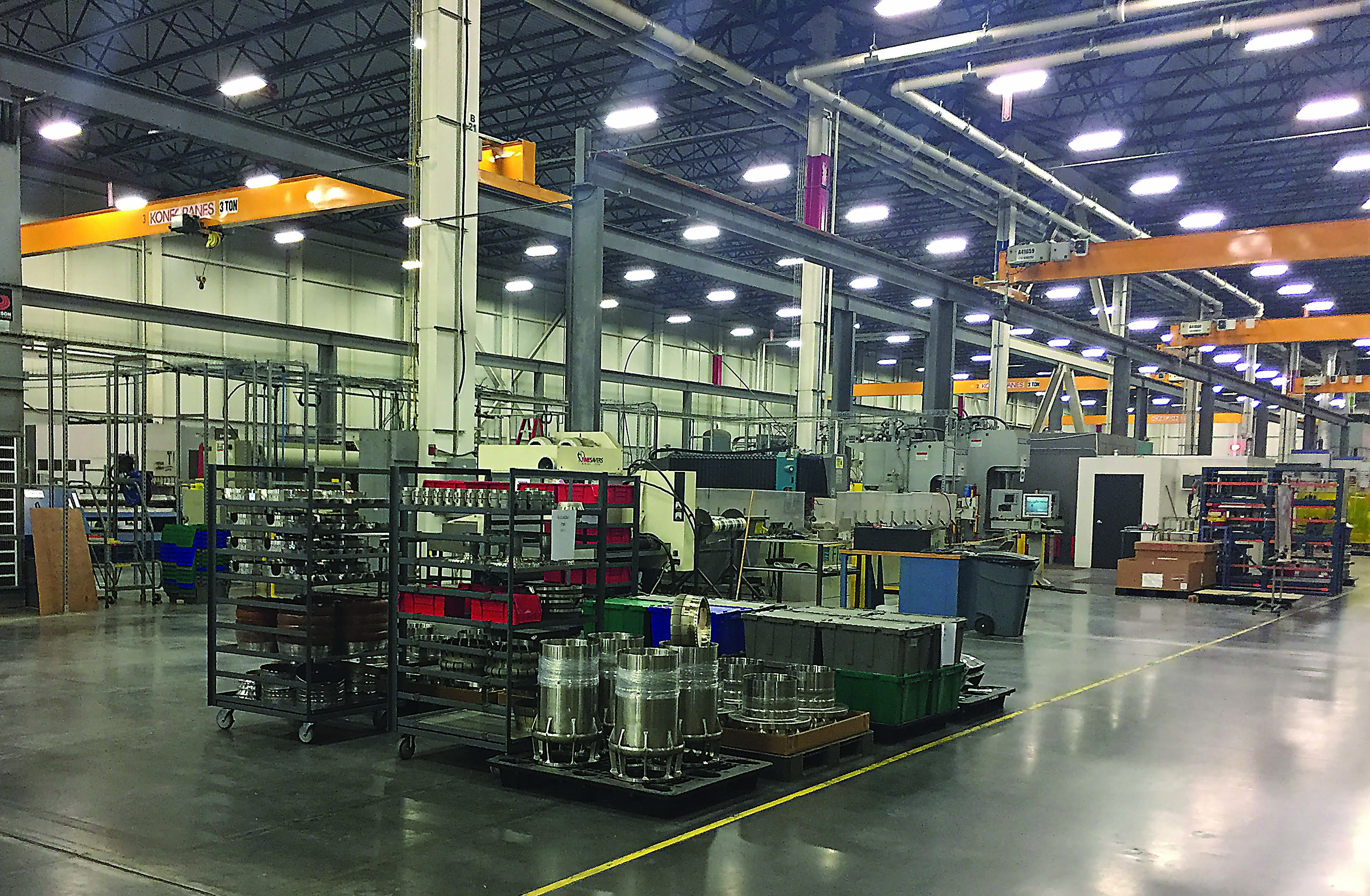

Parts wait for distribution to various manufacturing cells at Mitsubishi Hitachi Power Systems Americas’ combustion shop. The prototyped carts, floor location and MRP system are set up before deciding the arrangement. All images: C. Tate

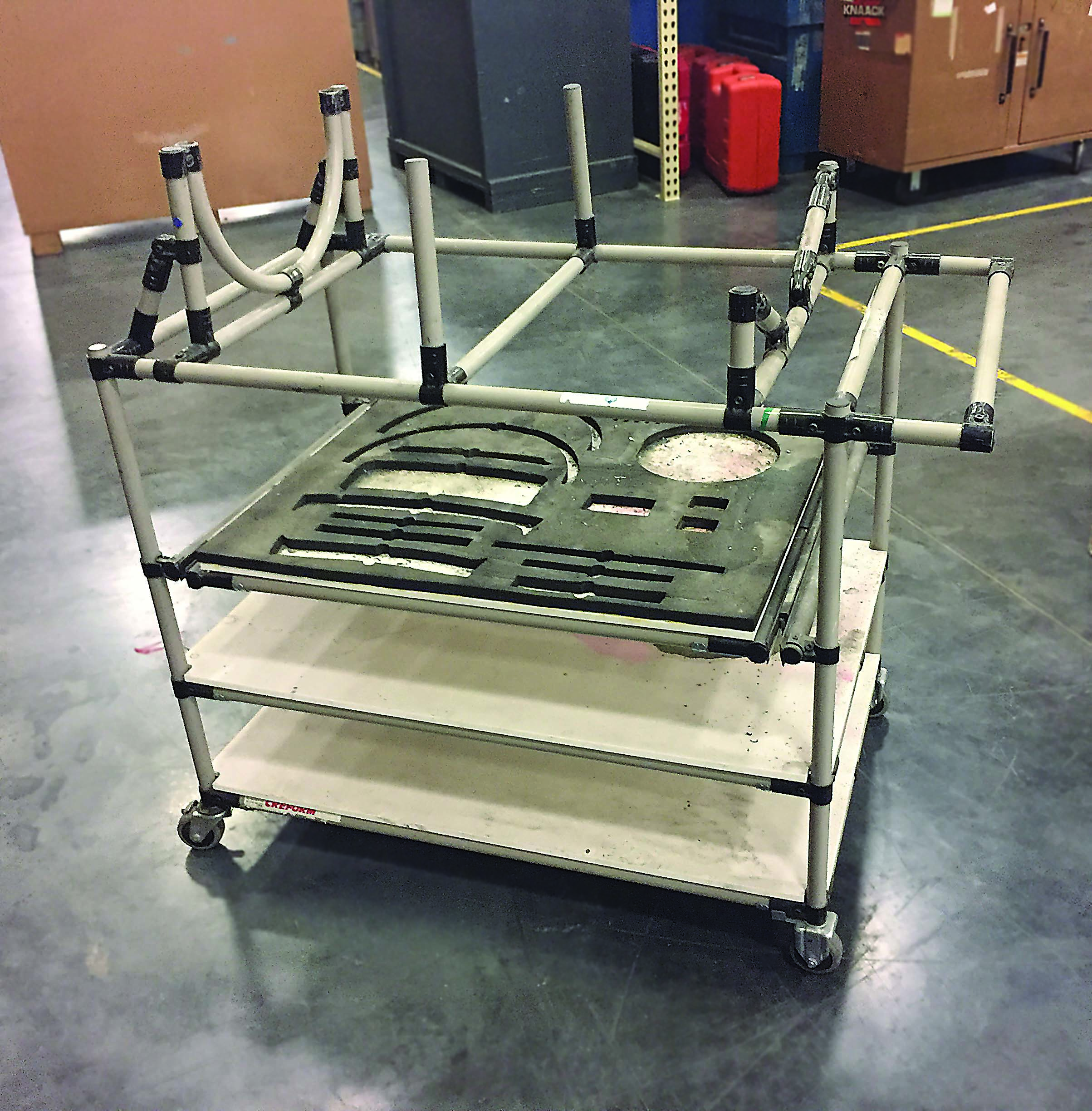

For example, our combustion hardware is heavy. Loading it into welding fixtures requires the use of cranes. Eliminating crane moves is one of the initiatives we have in the combustion shop. Crane moves have become part of our culture; success will require developing a solution that is extremely robust.
One team came up with the idea of moving parts around with carts. After creating and reviewing some basic designs, we selected the best and built a prototype. It was built from erector set-type materials purchased out of a catalog. The materials were inexpensive and could be assembled with wrenches and screwdrivers, so making iterations was easy and fast. This process allowed us to quickly and cost-effectively move from idea to test so we could vet each iteration.

Power generation manufacturers are in a state of flux. We are adapting to changes by bringing in new work, which will require us to rearrange the shop floor and move large pieces of equipment to locations that enhance product flow. Moving equipment can be dangerous and is always expensive.
Ensuring we have the best layout is critical. Therefore, we not only used CAD software to lay out the floor but fabricated full-size footprints of each machine from cardboard. Each footprint was placed on the floor to replicate the exact layout. This activity allowed us to walk around the new arrangement and verify we had a well-organized layout. We checked that the exits and electrical panels were not blocked or any other regulatory requirements were violated. The cardboard cutouts also made it easy for the millwrights to locate equipment quickly and accurately.
These prototype transportation carts were made from inexpensive materials that were easy to modify.

Continuous improvement is not only for manufacturing processes. It also has a place in business processes. Reducing lead time and inventory is a goal of every company. To reduce time spent waiting on parts to be released from the warehouse, we planned to have parts kits made up ahead of the assembly process. Kits would be built in the warehouse and distributed to the shop floor as needed.
A prototype cart for the parts was made. Next, we created a prototype method for dealing with the material requirements planning system, which was not set up to allow the building of kits. Then we tested.
We made discoveries that required us to return to the drawing board a few times. In the end, we successfully created kits and learned a lot about both our business and culture from the prototyping work.
