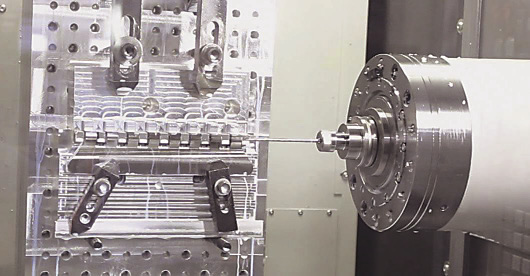

PCT offers carbide twist drills as an alternative to gundrills when deep-hole drilling.
