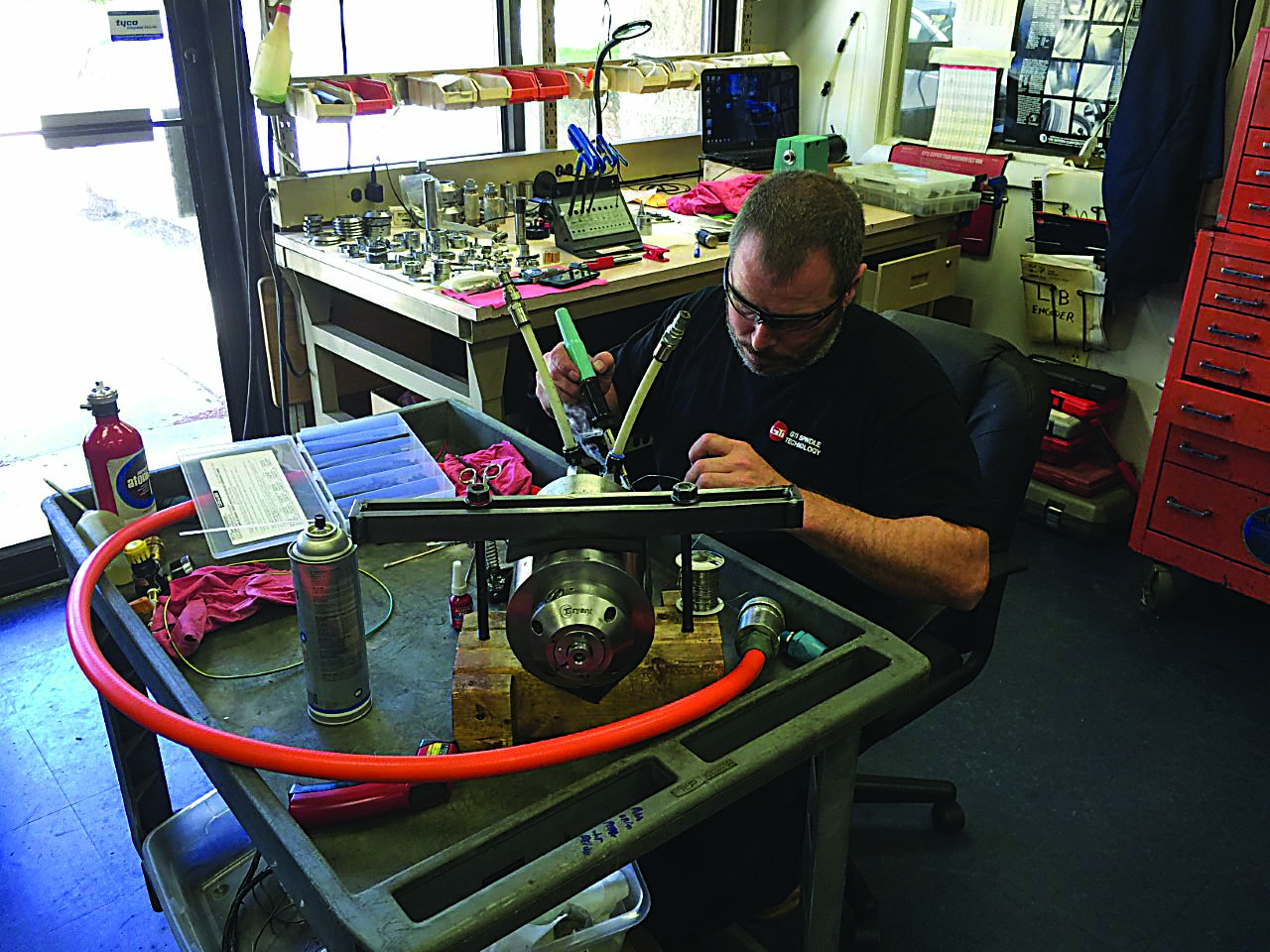

“In extreme cases, the damaged components can be remanufactured to the point of remaking the whole spindle,” said Zeljko Cvitkovic, engineering manager of spindle remanufacturing/production at SKF USA Inc. in Lansdale, Pennsylvania. “The determining factor when considering a spindle rebuild is usually cost. Ideally, customers pay less than half the cost of a new spindle to repair an existing one. Sometimes the cost will be higher, but if the repair cost is estimated to exceed the cost of a new spindle — and it is readily available — then it makes sense to buy a whole new spindle.”
GTI's Johnny Johnson works on a Bryant spindle.
GTI’s Johnny Johnson works on a Bryant spindle. Image courtesy of GTI Spindle Technology

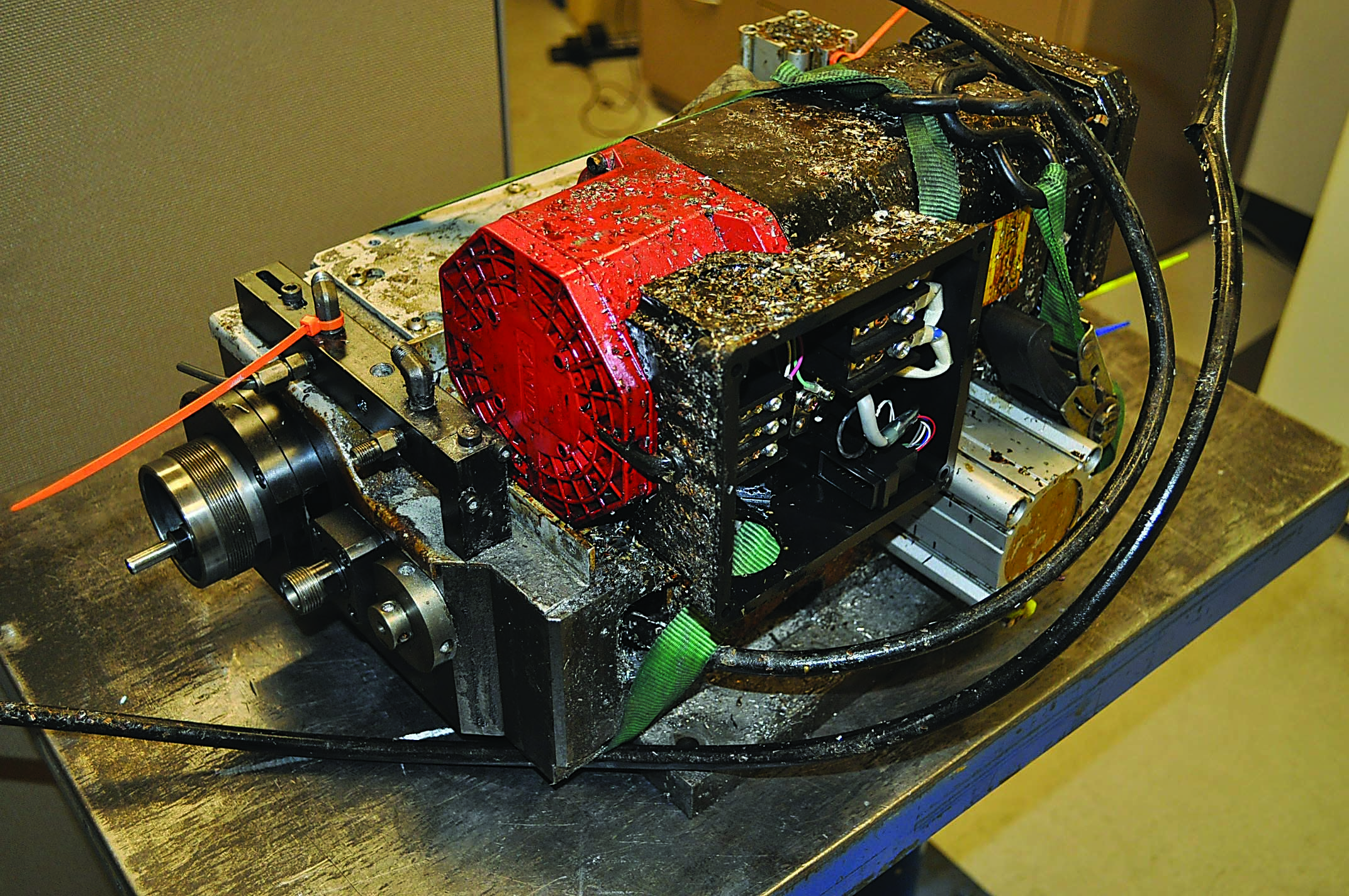

A spindle is shown prior to and after being repaired
A spindle is shown prior to and after being repaired. Images courtesy of SKF USA
Cvitkovic said although some end users assume that a spindle repair involves only taking the spindle apart and installing new bearings, that is rarely the case.
“In some situations, spindles are run to failure and come to a screeching halt,” he said. “When that happens, other components get damaged, not just the bearings.”

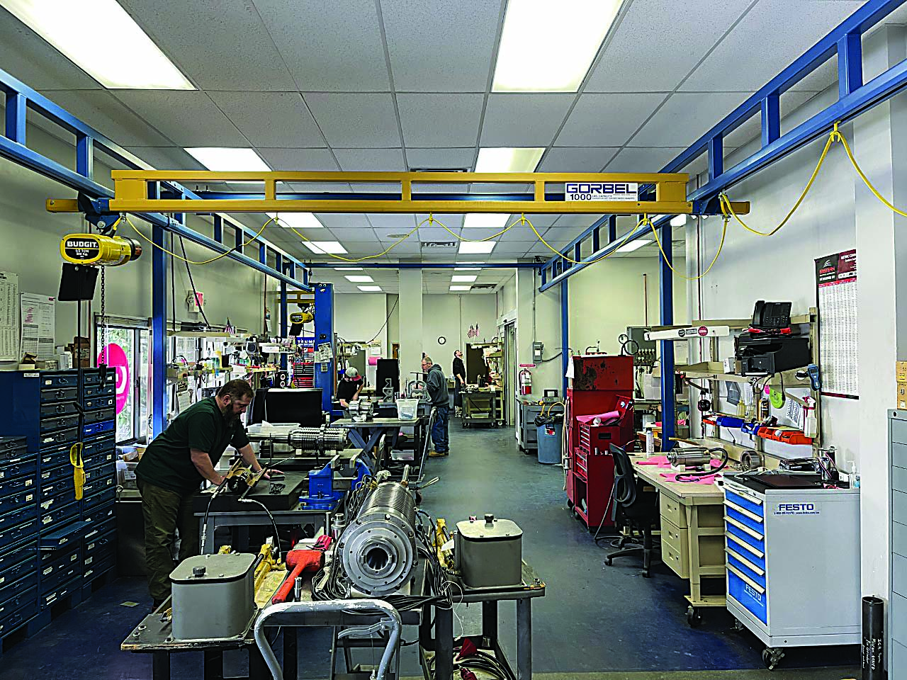

Shown is the spindle assembly room at GTI Spindle Technology.
Shown is the spindle assembly room at GTI Spindle Technology. Image courtesy of GTI Spindle Technology

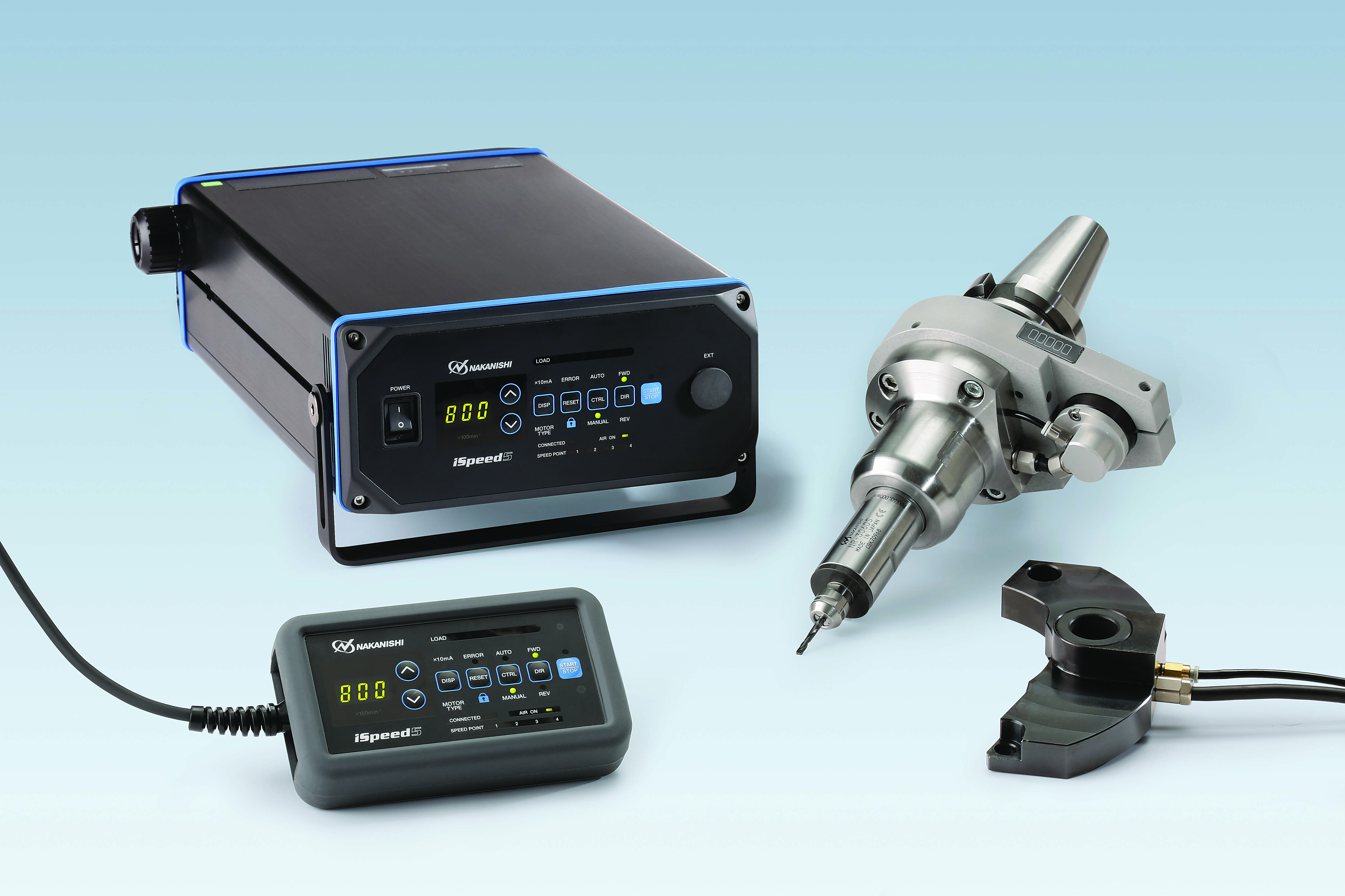

The iSpeed5 is a brushless DC, fully tool-changeable electric system that primarily consists of a motor spindle, a stop block, an air pressure switch and a control unit.
The iSpeed5 is a brushless DC, fully tool-changeable electric system that primarily consists of a motor spindle, a stop block, an air pressure switch and a control unit. Image courtesy of NSK America
