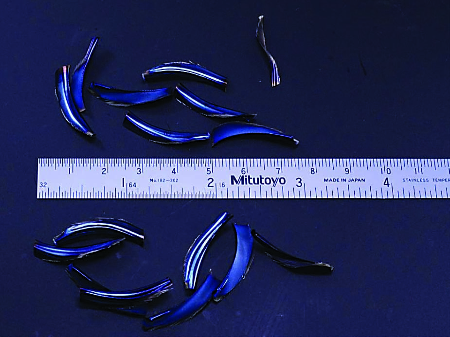

Each ProvenCut recipe includes, among other ingredients, a photo of the chips made during the cut

  • Photographs of the cutting tool, the chips made during the cut and the machine setup.

Each ProvenCut recipe includes, among other ingredients, a photo of the chips made during the cut. Image courtesy of J. Saunders
