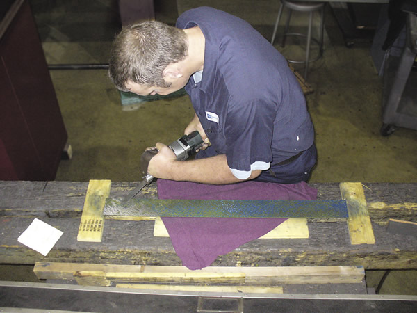

A technician power scrapes the high spots on a metal way surface. Image courtesy of Busch Precision.
A technician (top) power scrapes the high spots on a metal way surface. A finished way (below) is ready for installation. Images courtesy Busch Precision.

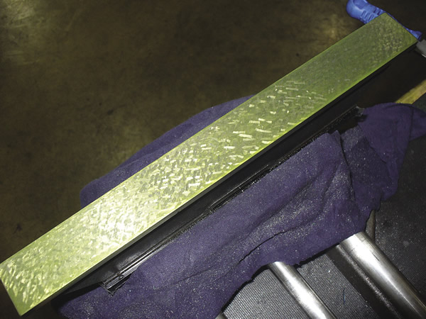

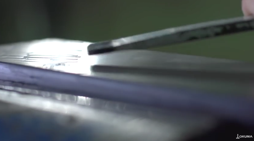

Whether metal or plastic, hand scraping requires application of a flat, carbide-tipped blade, to make the way flat, and then “flaking” the finished surface. The following six steps describe the process:
1. Make an initial “cross scrape” to clean and prepare the surface.
2. Remove any loose chips and dust, then apply a small amount of mineral oil and “stone” the surface to remove burrs.
3. Apply a thin layer of bluing paste to the surface.
4. Rub the way on a surface plate, which removes the colored paste from the high spots.
5. Scrape the high spots, then repeat steps 2 through 4 until the surface is completely flat and the machine’s geometric requirements are met.
6. Flake the surface to create oil pockets, then clean and stone it one final time.
Bob Behnke, a machinist at Busch Precision Inc., a Milwaukee contract manufacturer and machine repair company, said scrape marks are like fingerprints of the person who worked on the machine. “Everybody has their own individual pattern. Over time, you look at enough of them and you’re able to recognize who did the work. We have people who scraped here 25 years ago, and I can still pick out which machines were theirs.”
Behnke said the amount of scraping, the depth of each individual mark and the distance between them (points per square inch) depends on a number of factors. A very worn machine could require grinding or machining to true the geometry, followed by a complete scrape job. A light rebuild may only need to be “freshened up” to make surfaces flat and create the proper amount of oil retention. Machines that will see heavy loads call for deep scraping, where light-duty machines can be effective with shallower scrapes. In each case, the craftsman follows the same basic process, but makes technique adjustments based on skill level, experience and the application needs of the machine tool.
“There’s a lot to it,” Behnke said. “The length of time spent scraping any particular surface or machine comes down to how many high spots there are to begin with, how much resistance is acceptable when the machine tool traverses back and forth, the amount of lubrication that’s needed and the size of the way surface. It takes a lot of experience, but it’s also physically demanding. You have to push on the blade and really dig in if you’re going to get a deep scrape, which is the best way to assure longevity in the machine tool.”

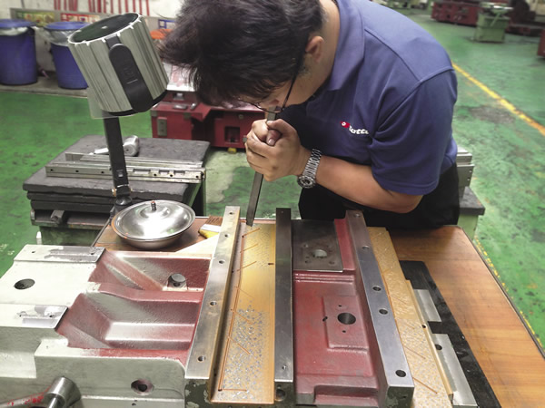

Okuma America Corp. Applications Engineer Robbie Williams agrees. The Charlotte, N.C., machine builder hand-scrapes wherevertwo moving metal surfaces meet to reduce the wear and tear on machine tools. “You can turn the machine off and walk away from it for weeks, and when you turn it back on again, you’ll still have that oil in there,” he said. “Because of this, there’s never any actual metal-to-metal contact.”

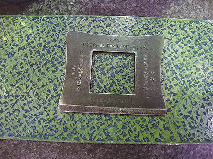

Measuring the points per inch on a scraped Rulon142 wear strip. Image courtesy of KING-WAY Scraping Consultants.
Measuring the points per inch on a scraped Rulon142 wear strip. Image courtesy KING-WAY Scraping Consultants.

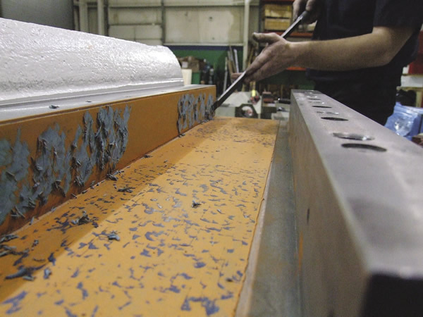

Part of the machine rebuilding process involves cleaning all surfaces and removing old paint and grime. Image courtesy of KRC Machine Tool Services.
Part of the machine rebuilding process involves cleaning all surfaces and removing old paint and grime. Image courtesy KRC Machine Tool Services.

The challenges of scraping rise exponentially as machines become larger. Williams said a small lathe might take 10 to 30 hours to complete, whereas a horizontal machining center can take far longer. That’s because more things can go wrong as the machine size increases—ways might be concave or convex and can twist from one end to the other. All geometric irregularities must be removed so the surfaces mate perfectly through careful, patient scrapes with a carbide blade.
Williams has been scraping for 16 years, but said he still learns new things every day. He teaches a weeklong class on hand scraping at York Technical College and has conducted in-booth seminars at IMTS. Becoming proficient at hand scraping takes several years as an apprentice, he said, working under the tutelage of a journeyman scraper.

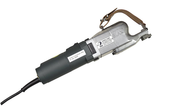

The BIAX power scraper offers adjustable stroke length and speed. Image courtesy of DAPRA.
The BIAX power scraper offers adjustable stroke length and speed. Image courtesy DAPRA.
Scrape to the point
The BIAX power scraper was invented in the early 1950s by Walter Wetzel, brother of DAPRA’s owner, Rudi Wetzel. It incorporates an electric motor to drive a reciprocating carbide-tipped blade, mimicking the back and forth motion of hand scraping. The blade speed and stroke is adjustable—up to 1,900 strokes per minute, with stroke lengths from 0″ to 0.8″ (20mm). Milhomens said operating the BIAX is about as difficult as steering a bicycle. All that’s required is to set the proper stoke and speed, and then push. Long, fast strokes are suitable for roughing and heavy material removal, whereas short, delicate strokes flake the finished surface or get into tight corners.
“We’ve sold [power scrapers] to companies all over the world, from machine builders and reconditioners, to manufacturing companies that rebuild their own machines in-house,” Milhomens said. “Even the folks who’ve been hand scraping for years like how easy the BIAX operates. There are none of the aches and pains you get from gripping a blade all day long, and the cutting method can be customized to your own personal preference.”
The price for a BIAX scraper is from $2,700 to $3,500, inexpensive enough that even some hobbyists purchase one. Milhomens admits that hand scraping is never going away, and is preferred by many for finishing and fine detail work, but power scraping will at least do most of the heavy lifting. “It just makes life a lot simpler.”
