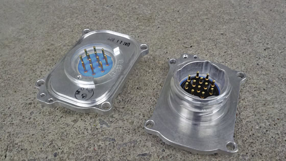

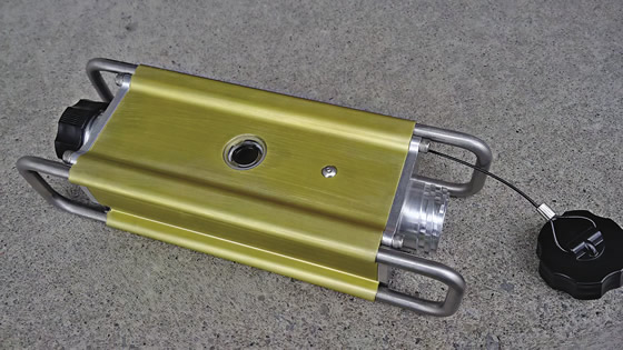

In the winter of 2011, INOVA, based in Stafford, Texas, started selling the G3i, a flexible, cable-based recording system for oil and gas exploration and production companies and seismic contractors prospecting for reserves. The unit consists of three main parts: an extruded aluminum shell, a circuit board inside the shell and two 6061 aluminum connector plates that link electrical and communications cables, one on each side of the shell.

The 3½ "×2½ "×2½ " (88.9mm × 63.5mm × 63.5mm) connector plates are made on two Haas VF3 vertical machining centers, each equipped with a two-pallet changer. In our previous production process, each pallet used two double vises, each of which can hold two parts. Although the vises are handy and convenient, they are not always good for production. The vises consumed too much room on a pallet, so we could only make four parts per pallet.

However, outsourcing created other problems. The parts must be repeatable and meet tolerances as tight as 0.001 " (0.0254mm), as they are run through a silicone injection molding machine to add a silicone sleeve to a bore in the part to create a watertight seal. If the bores vary by just a few thousandths of an inch, the silicone sleeve will be overshot or undershot.

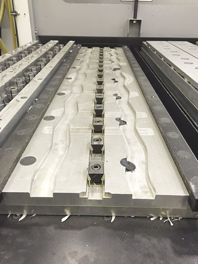

We knew we had to get as many parts on a 3 '×28 " (0.9m × 711.2mm) pallet as possible. The more parts we could machine per tool change, the better. Randy Cameron, director of technical services, Steven Jiang, mechanical engineer, and I calculated that if we staggered our parts by alternating them with one part slightly higher and one slightly lower in each row, we could get 60 parts per pallet in four rows (two rows of 15 parts for the first operation,and two rows of 15 parts for the second operation). As a result, we went from machining four parts on a pallet to 60 parts. A GibbsCAM TMS (tombstone management system) made it fairly easy to program the job, and Tungaloy’s Tung-AluMill insert cutter, which provided an excellent ramp angle and material- removal rate to help expedite machining. The problem was how to hold the parts.

Connector plates for the G3i cable-based recording system (above). The completed device (below).

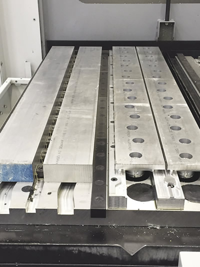

In op. 1, we used two rows of Mitee-Bite locating rails on the bottom row of parts and a row of Mitee-Bite Uniforce clamps in the middle to securely hold two 2.5 "x1.5 "x36 " (63.5mm × 38.1mm × 914.4mm) aluminum bars for roughing (15 parts were machined on each bar and separated during final machining).
In op. 2, we used 30 Mitee-Bite ID Xpansion clamps. The clamps are easily turned on a CNC lathe. Machining the clamps to exactly match multiple bore diameters greatly increased the clamping surface.
After the parts were machined in op. 1, we loosened the Uniforce clamps and took the two full-length bars, removed them from the pallet and flipped them, then slid them onto the ID Xpansion clamps for machining on the back of the parts in op. 2. This process did not require us to move all 30 parts individually—instead, the bar slid into place with a light hit from a 3-lb. (1.36-kg) dead blow mallet.
When the connector plates were in place, the operator tightened a ½ " (12.7mm) bolt on the ID clamps for each part with a set torque wrench.Finish machining of the bar in op. 2 separated the parts from each other, and they were ready to be unbolted and readied for the molding department.

In the photo above, the pallet is ready to receive aluminum bars for op. 1. Mitee-Bite expansion clamps are positioned between the two sections of the pallet. After the bars are loaded on the pallet in the photo below, tightening the ¼ "-20 bolts pushes the work material against the fixed black rails. There are two rows ready for op.1 (right-hand side of image below) and two rows ready for op. 2 (left in image below). The wavy grooves on the pallet are chip channels, so chips can easily wash out after through-holes are drilled. All bolt holes in the fixture are filled with silicone so they don 't fill with chips and coolant, which simplifies cleaning.
