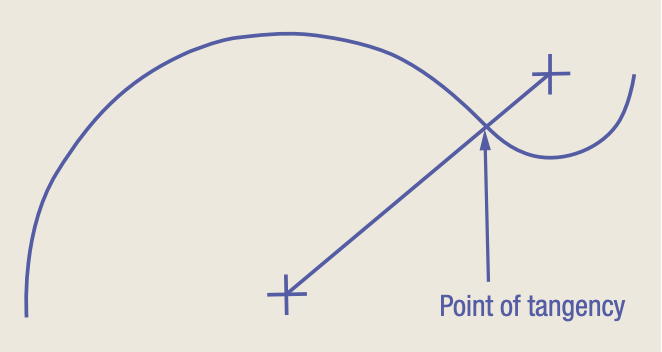

The line connecting the centers of the two arcs passes through the point of tangency.

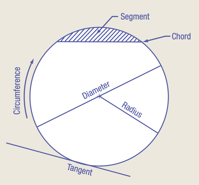

In addition to formulas, shapes are important to shop math, and the circle is one of the most important shapes encountered in the trades. It pays to know a few circle facts.
Every metalworker should know the terminology and properties of a circle. These come up so often during the course of everyday problem solving that metalworkers who don’t know them are handicapped.
A line tangent to any point touching a circle is perpendicular to the center of a circle at the point of tangency. This fact is useful when doing inspection and reverse engineering.

Knowing that two tangent arcs of different radii will have their centers along a common line passing through the point of tangency is also beneficial. Also, the length of any circular arc can be quickly calculated by multiplying the radius by the arc angle by 0.01745, or rα(0.01745) = arc length. You will see this number again, so it’s worth remembering.

Hopefully, everyone remembers that the circumference of a circle is the diameter multiplied by π, or C = d π.

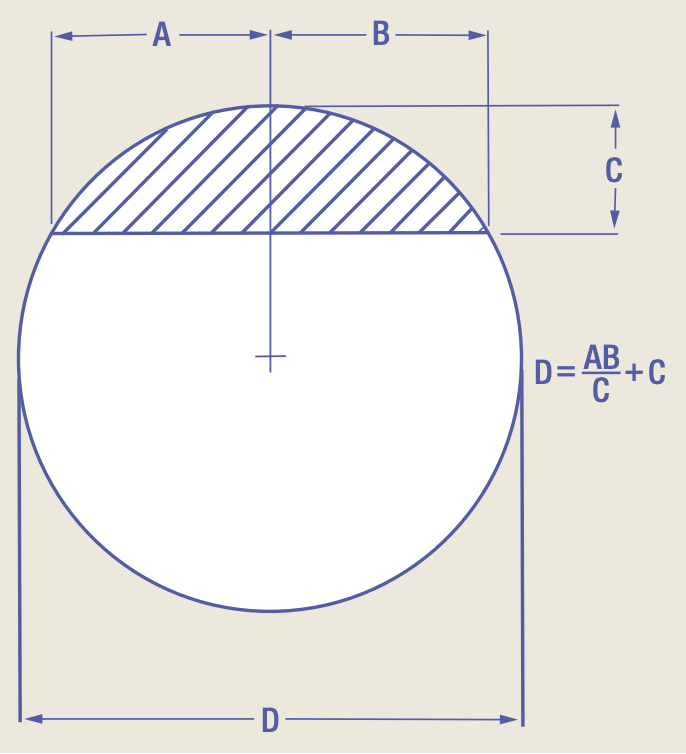

True roundness, or circularity, cannot be measured with a two-point measuring system. A common example is poor-quality, centerless ground shafts and pins. These will measure correctly with a two-point measuring tool like a micrometer, but when these pins or shafts are spun in a V-block and compared with an indicator, they show some roundness deviation as runout. The only true way to measure roundness is by rotation of an accurate spindle or center point.
The formulas for measuring chords are also extremely useful. I have used them often to find an unknown radius. Many times, things in the shop have a radius that is outside the range of standard radius gages.
Use a bar or pin of a known length to act as the chord for your measurement. Finding the radius can then be reduced to a simple calculation. The space between the pin and the radius to be measured can be determined with gage pins or by measuring the top of the pin with calipers. Be sure to measure in the center of the pin or bar to get the maximum measurement of the radius. A depth micrometer can also be used. The tip diameter of the depth micrometer will affect the depth measurement, but you can add a ball tip to the measuring tool to avoid that problem or to make some additional correction calculations for the tip diameter. CTE

function calculateChordRadius() { let c = parseFloat(document.getElementById(“chord”).value); let h = parseFloat(document.getElementById(“height”).value); let radius = (c * c) / (8 * h) + h / 2; document.getElementById(“chordRadiusResult”).innerText = “Radius: ” + radius.toFixed(4);}
Formula: Radius = (c² / 8h) + (h / 2)
