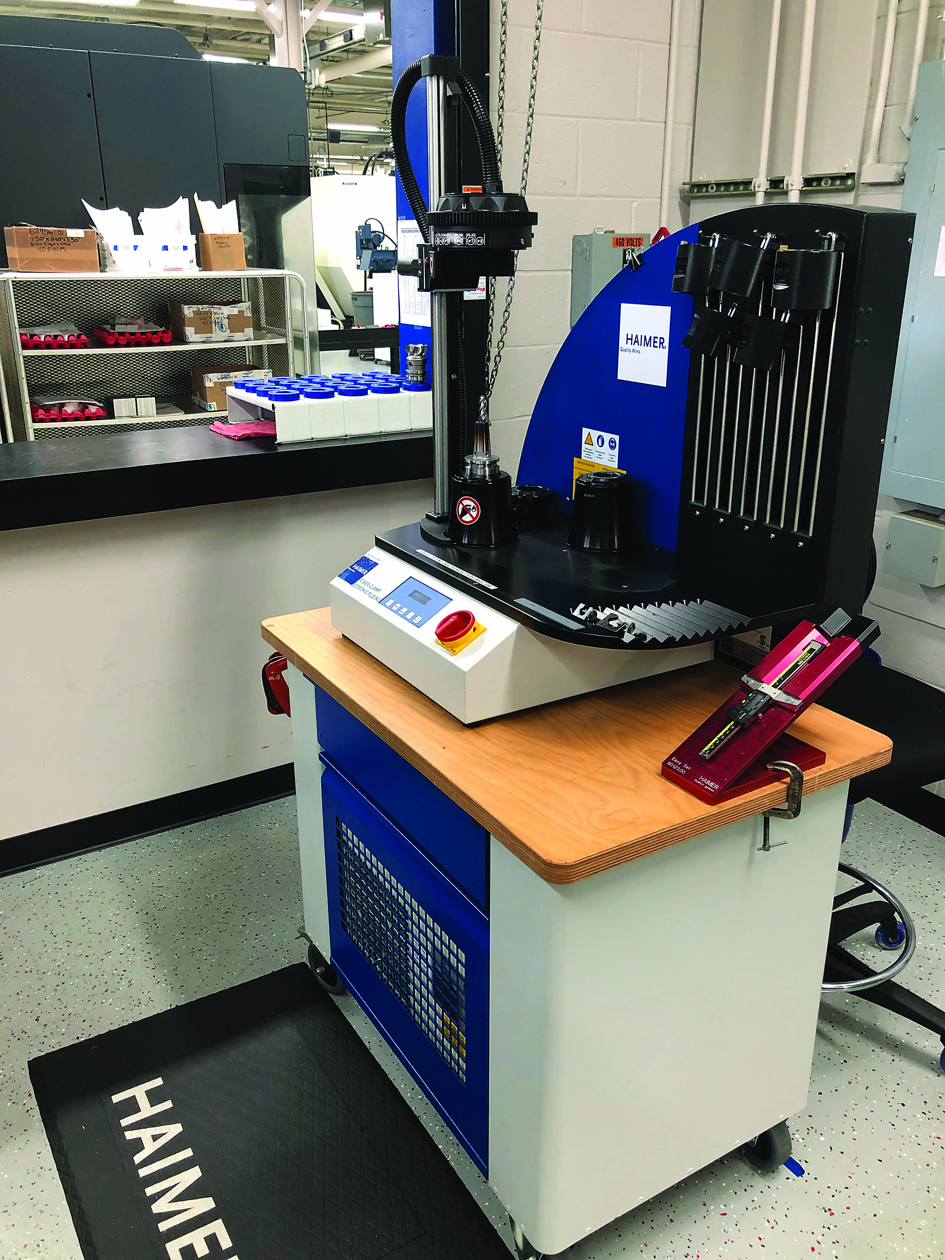

Raym-Co purchased a Power Clamp Economic Plus NG shrink-fit machine with an adjustable coil and two bases. Image courtesy of Haimer USA

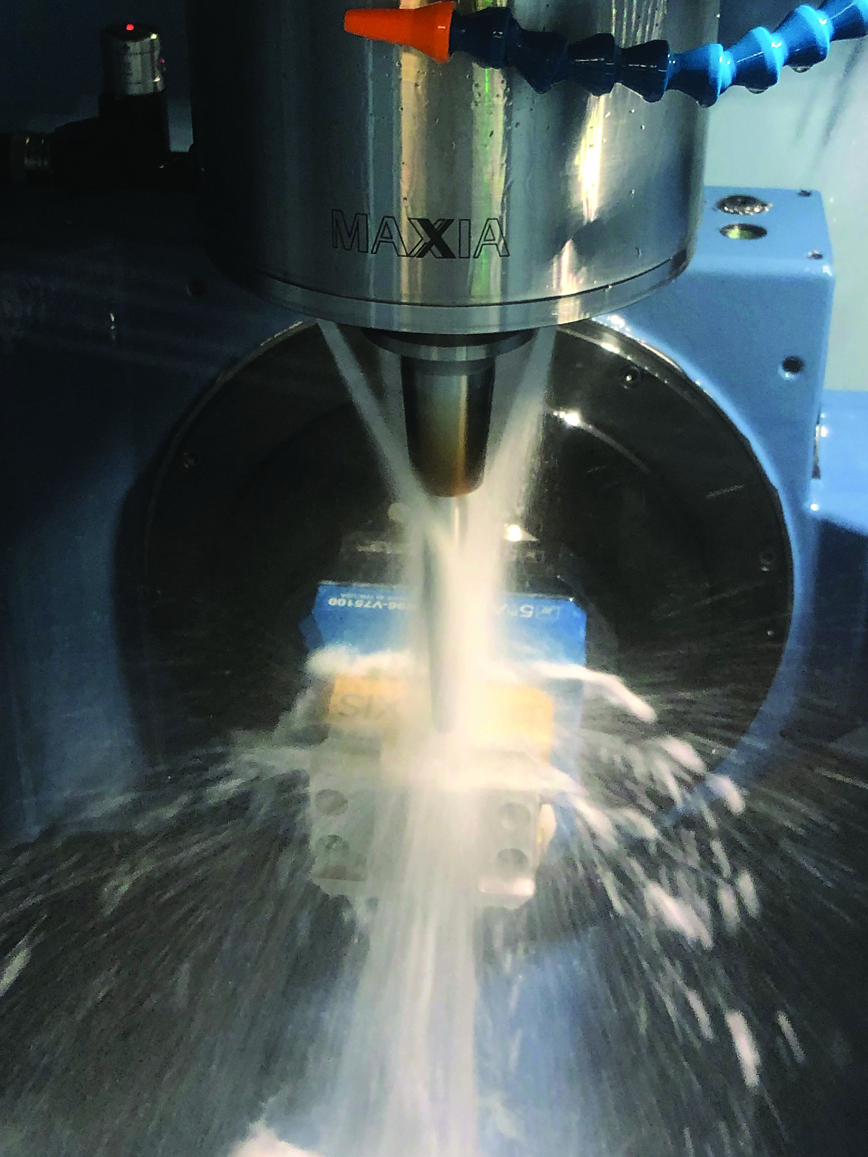

“After that,” he said, “we just started cranking the feed rates up until we got to where we were either snapping cutters off because the cutter couldn’t hold up or we were at the limitations of the machine. Now we incorporate that into our everyday programming, so the speeds and feeds are three times what they used to be on average.”
When endmilling aluminum, for example, Artibani said Raym-Co went from 1,270 to 1,524 mm/min. (50 to 60 ipm) to 7,620 mm/min. (300 ipm) on average and as high as 25,400 mm/min. (1,000 ipm) on some applications.
Even at elevated cutting speeds, vibration is not a concern.

“Chatter issues just don’t exist anymore,” Artibani said. “If we have chatter, it’s because the machine is shaking on the floor.”
He said he quickly learned that holding tolerances was effortless with the shrink-fit toolholders. Raym-Co holds ±0.005 mm (0.0002″) on location and hole size without having to try.
To heat a holder’s bore so it expands enough to accept a tool shank and cool it so the tool is held solidly in place, Raym-Co took the recommendation of Mike O’Connor, regional sales manager at Haimer USA, and purchased a Power Clamp Economic Plus NG shrink-fit machine with an adjustable coil and two bases.

“You can heat one tool and move it to the side and have it in the cooling area while you heat a second tool,” Artibani said about the benefit of an additional base.
He said this capability enables Raym-Co to set up a shrink-fit holder as quickly as or quicker than assembling a collet chuck, primarily because a collet chuck must be checked for runout. Heating a holder consumes 10 seconds while cooling it takes 30 to 60 seconds.
