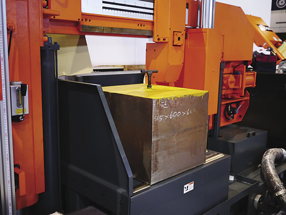

Cosen_C-800NC%20Cutting%20Metal%20Block.tif
Heavy, wide cuts such as this one can cause chip evacuation problems. Deep blade gullets and flood coolant increase productivity and improve blade life. Image courtesy Cosen Saws USA.
“I call it smart cutting,” Young said. “It removes much of the thought process in sawing, automatically setting the feed, speed and cutting pressure based on preloaded control parameters. If the head senses resistance in the cut, the controller will pick up on that and signal the hydraulic system to provide more fluid to the down-feed side of the cylinder, maintaining a consistent, straight level of cutting. Also, the computer will monitor the blade speed and automatically adjust to whatever feed rate is being used at that time. The operator doesn’t have to worry about any of those things.”
Young noted that machine shop customers are demanding faster lead times and lower priced parts. One often overlooked part of this equation is the first step in machining: sawing blanks. “The biggest failure is not treating a saw as a CNC machine tool,” he said. “In today’s price-conscious world, you have to consider every detail. Unfortunately, as shop owners modernize their equipment, the last thing they consider is the saw.”

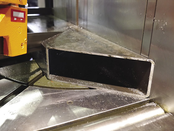

Cosen_CNC-800DM%20Automatic%20Miter%20saw%20cutting%20structural%20material.tif
Mitering is a common bandsawing operation, but one that’s prone to deflection as the blade enters the angled cut. Controls that automatically adjust the down-feed pressure and blade speed improve blade life and part quality. Image courtesy Cosen Saws USA.
A big part of the modernization Young promotes is improved blade control. Aside from automatically speeding up or slowing down as the need arises, Amada bandsaws offer pulse cutting technology, which uses a guide arm-mounted servomotor to apply alternating pulses of pressure to the saw guides approximately 10 times each second (see photo on page 90). According to Young, this forces the blade to penetrate materials faster and more aggressively than conventional bandsaws, increasing material removal in titanium and nickel-based alloys from 3 to 4 sq. in./min. (76.2 to 101.6 sq. mm/min.) to 25 sq. in./min. (635 sq. mm/min.) or more when using Amada’s Axcela G carbide blade.

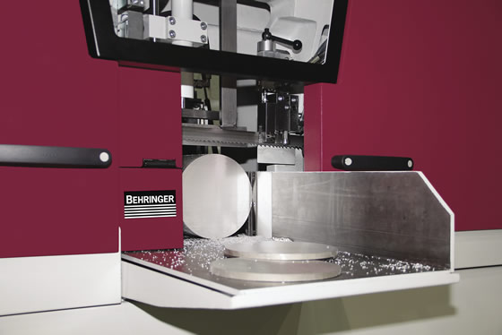

The key to vibration reduction is cast iron construction, according to Joe Suydam, inside sales and marketing specialist for Behringer Saws Inc., Morgantown, Pa. “As with any machine tool, a rigid frame is critical to tool life and part accuracy.” Behringer uses cast iron for the bow frame and other major components, “which we feel is far better at damping vibration than steel weldments,” he said.
Behringer_HBE261A%20Dynamic%20verl%2b%c3%b1ngerter%20Materialtisch%20with%20logo%202.tif
A cast iron frame and hydraulic blade tensioning eliminate much of the vibration in bandsawing operations. Image courtesy Behringer Saws.
That’s not to say there are no electronics involved. As Suydam explained, Behringer saws are equipped with a servo ballscrew system and pressure sensors to monitor the cutting force and make adjustments to optimize the process. Hydraulic blade tensioning further reduces any residual vibration not absorbed by the saw’s iron frame, and the control will sense blade deflection during the cut, operating within user-defined parameters to adjust feed rate or even shut down the operation if needed.
Ease of use is another feature saw builders strive for. Auto feed control is one example. “We have a data-base of specific materials within the control,” Suydam said. “This gives the operator good feeds and speeds as a starting point, rather than relying on the sound of the cut or color of the chips to determine sawing parameters. There are also built-in functions to accelerate or decelerate based on where you’re at in the bar or channel. This helps avoid problems with gouging at the start of the cut, for example, where only a few teeth are engaged, reducing tooth breakage and premature blade wear.”

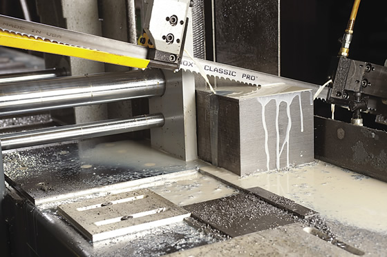

Matt Lacroix, director of brand marketing at Lenox Tools, a saw blade manufacturer based in East Longmeadow, Mass., agreed that preventive maintenance is an often-overlooked component of saw operation. “You want to make sure there’s a preventive maintenance schedule in place. Whether that’s monthly, quarterly or every 6 months, it’s still important to have it; otherwise, at some point you’ll find yourself with a broken saw and no way to cut parts,” he said.
LENOX%20CLASSIC%20PRO%20Bi-Metal%20Band%20Saw%20Blade.tif
Because of their toughness and relative low cost, bimetal bandsaw blades are widely applied. Image courtesy Lenox Tools.
Lacroix is also a proponent of proper blade break-in, a process whereby the blade is run at 20 to 50 percent of the normal feed rate for the first few cuts. This removes microburrs left from the blade manufacturing process and avoids the chips and fractures that will form with aggressive initial handling. On older machines, this was left to the operator, but some of today’s saw controls have preprogrammed cycles that ease saw blades into a long and useful life.
He also recommends carbide-tipped blades instead of bimetal ones when cutting difficult materials used in aerospace, power generation and medical parts. “Much of the technology used in saws lends itself well to carbide. This includes vibration damping and automatic feed adjustments, as well as beefier machine construction, allowing for the higher cutting speeds.”
Lacroix admitted the price tag for carbide-tipped blades may be three times that of bimetal blades, but said the blade life and increased productivity easily justifies the additional expense—even for the high-mix, low-volume applications seen in many job shops.
