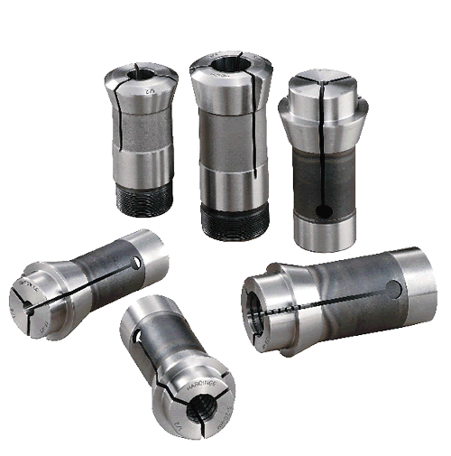

You might not think that something as unassuming as a workholding collet would play a major role in how a part is made. Collets are simple. They grip or support bar stock, providing rigidity so cutting tools can precisely remove material. There’s not much more to it than that, right?
Wrong. When faced with challenging applications, such as machining non-round and extruded workpieces, using nonground stock and making small parts on Swiss-style machines designed for larger ones, Swiss-style machine shops often must devise creative workholding solutions. Some of these solutions include the use of specialty collets and other nonstandard workholders, including hex sleeves, adaptive bushings, extended-nose guide bushings and over-grip collets.
Courtesy of Hardinge Workholding Div.
A variety of Swiss-style collets manufactured by Hardinge.
