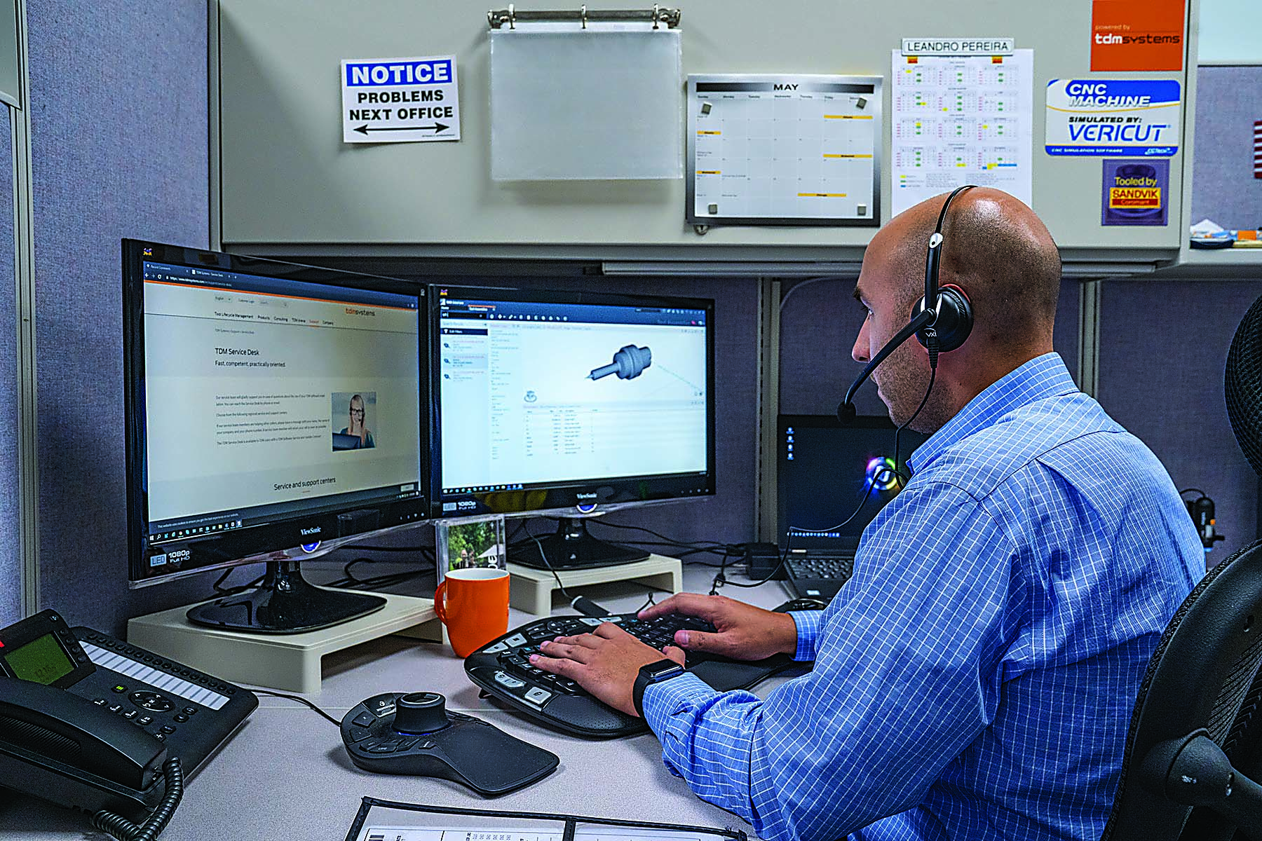

Leandro Pereira, automation engineer at Sandvik Coromant, reviews TDM Systems’ tool data management database. Image courtesy of TDM Systems
“Sandvik Coromant Mebane is a very well-run facility, but they still had room for improvement,” Auer said. “The difference is that Mebane was determined to do something about it. The key driver for them was that they realized they needed to become more organized in terms of their tooling information.”
