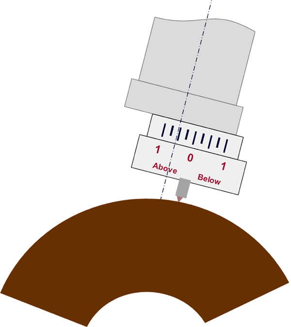

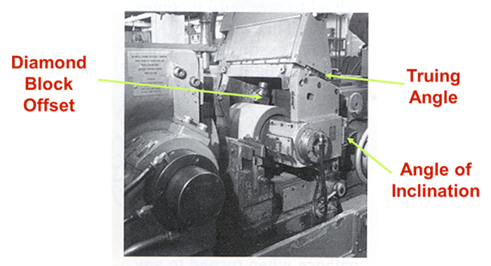

A majority of centerless grinders are set up with the work center height above the centerline of both wheels. There are some applications like bar grinding that set up the bar center below the centerline of the wheels to keep bar vibration low during the grinding process. We will focus on setups with the work center above the centerline of the wheels, which is commonly called “work height above center.” Part diameters 1½” or less should have the height above center dimension set at half the part diameter. Parts greater than 1½” should be proportionally less for stability reasons. The purpose of the truing device on the regulating wheel is to have the diamond follow a similar line of contact to the wheel that the parts will follow. This will allow parts to enter and exit the grind zone in a straight line. So there is an important relationship that ties the work height above center dimension to the regulating wheel diamond offset setting. (See images below.)
There is an important relationship that ties the work height above center dimension to the regulating wheel diamond offset setting.The purpose of the truing device on the regulating wheel is to have the diamond follow a similar line of contact to the wheel that the parts will follow.

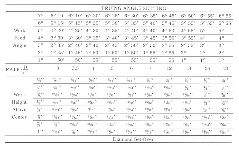

Typically the diamond offset is set slightly less than the workpiece height above center dimension. It is key to understand that this relationship influences the grind pattern and part contact to the grinding wheel as parts pass through the grinder. It is very important to calculate the ratio of the regulating wheel diameter to the workpeice diameter, or D/d. “D” is the regulating wheel diameter and “d” is the workpeice diameter. Once you know this ratio, then you can use the “Truing Setting” chart (below) to determine the correct truing angle and diamond offset.
The
The regulating wheel angle of inclination typically is in the +1 degree to +3 degree range. This angle, along with regulating wheel speed (RPMs), determines the part thrufeed rate in inches per minute. This setting also affects the distance a part will travel in one workpiece revolution. A lower angle means a shorter travel distance and this affects grind force on the workpeice. So you can affect how a grinding wheel performs by changing regulating wheel inclination and regulating wheel RPMs. Parts that have a high diameter-to-length ratio, such as bearing rings, should have a lower regulating wheel angle of inclination to help keep the parts stable as they travel through the grind zone. Proper settings allow the workpieces to smoothly enter and exit the grind zone.

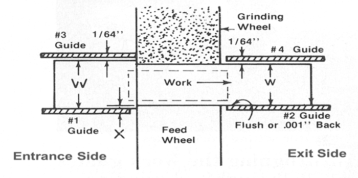

Typically there are adjustable guides on the entrance and exit sides of the grind machine. The purpose of the guides is to align the workpeices as the wheel goes in and comes out of the grind zone. (See diagram below.) It is important to correctly align the guides located on the regulating wheel side. The workpeices should smoothly transition between guides and regulating wheel. Even a slight “bump” during the transition can cause a defect to be ground into your parts.

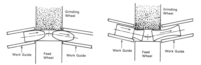

Proper guide alignment is important to avoid your parts from having a “barrel” or “hour glass” diameter across the part length. The illustration below shows how misaligned guides could affect part quality.
This illustration shows how misaligned guides could affect part quality.
