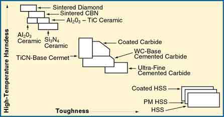

Figure 2 compares the hardness and toughness of TiCN-base cermet to other cutting tool materials. As can be seen from its position near the center of the group of materials, cermet offers a balance between hardness and toughness. Its properties place it in the same group with carbides and coated carbides, but it is harder than the carbide grades.

Figure 2:As this chart indicates, TiCN-base cermets are harder than tungsten-carbide and HSS cutting tools and tougher than diamond and ceramic tools.

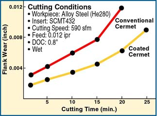

Studies have also been used to find the optimum coating and coating method for cermet tools. In one series of turning and interrupted-turning tests, the mechanical properties and cutting performance of TiN-coated cermets coated using a physical-vapor-deposition (PVD) process and a chemical-vapor-deposition (CVD) process were compared. The coated cermets were also compared to uncoated cermets.
After coating, the microstructure, thickness, grain size, microhardness, residual stress, and adhesive strength of the TiN coating were examined. It was found that PVD TiN coatings were of a considerably finer texture than those formed by the CVD method. Also, the hardness of the film deposited by the CVD method was low compared to the PVD film’s hardness. This was attributed to the diffusion of the binder metal from the cermet into the film, as well as the coarser grain size. The adhesive strength of the film deposited by CVD was low as well.
The transverse rupture strength of both the CVD- and PVD-coated tools was less than the transverse rupture strength of the uncoated tools, but this was to be expected. A similar reduction of transverse rupture strength is seen in coated tungsten-carbide tools. Despite this reduction in an important property, the coating of the cermet tools did yield enough improvement in performance to justify the use of coated cermets in many situations.

Figure 3: In one test comparison of coated and uncoated cermet cutting tools, coated cermets showed significantly less flank wear.
