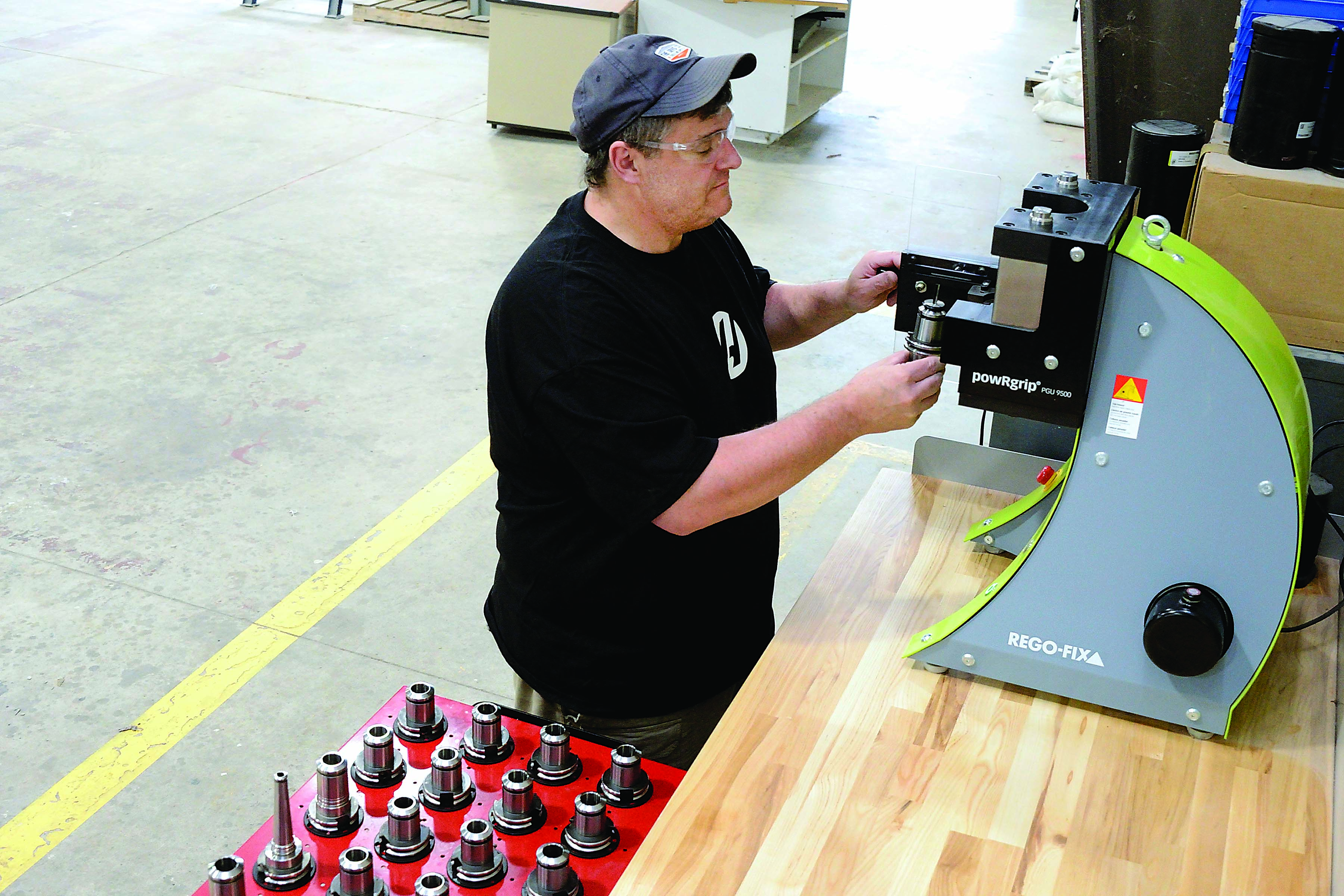

As part of the system, the PGU 9500 automatic clamping unit secures tools in holders in less than 10 seconds without setting parameters or using heat. The system—which also includes powRgrip collet holders, clamping inserts and PG collets—solves K&E’s runout-related problems.
With the press of a button, the powRgrip automatic clamping unit produces a force of up to 9 tons. The pressure fit between collet and toolholder creates a radial force that concentrates on the tool shank through the slotted collet, holding the tool safely and with a high degree of concentricity. This smart system automatically determines clamping pressure based on the clamping insert for a quick, accurate, secure setup that earned Broderson’s immediate commitment.
“The presale demonstration and testing that Rego-Fix’s representative offered allowed us to make the investment much easier,” he said. “Our first purchase order covered probably 30 percent of our milling machine tooling. Eventually, we’ll use Rego-Fix on 100 percent of our milling operations.”
Along with the accuracy that K&E gets, Broderson said the powRgrip System is quick and simple. “It’s very easy to load a holder into the die, put the collet in—done. With Rego-Fix tooling, job changeovers are also much faster.”

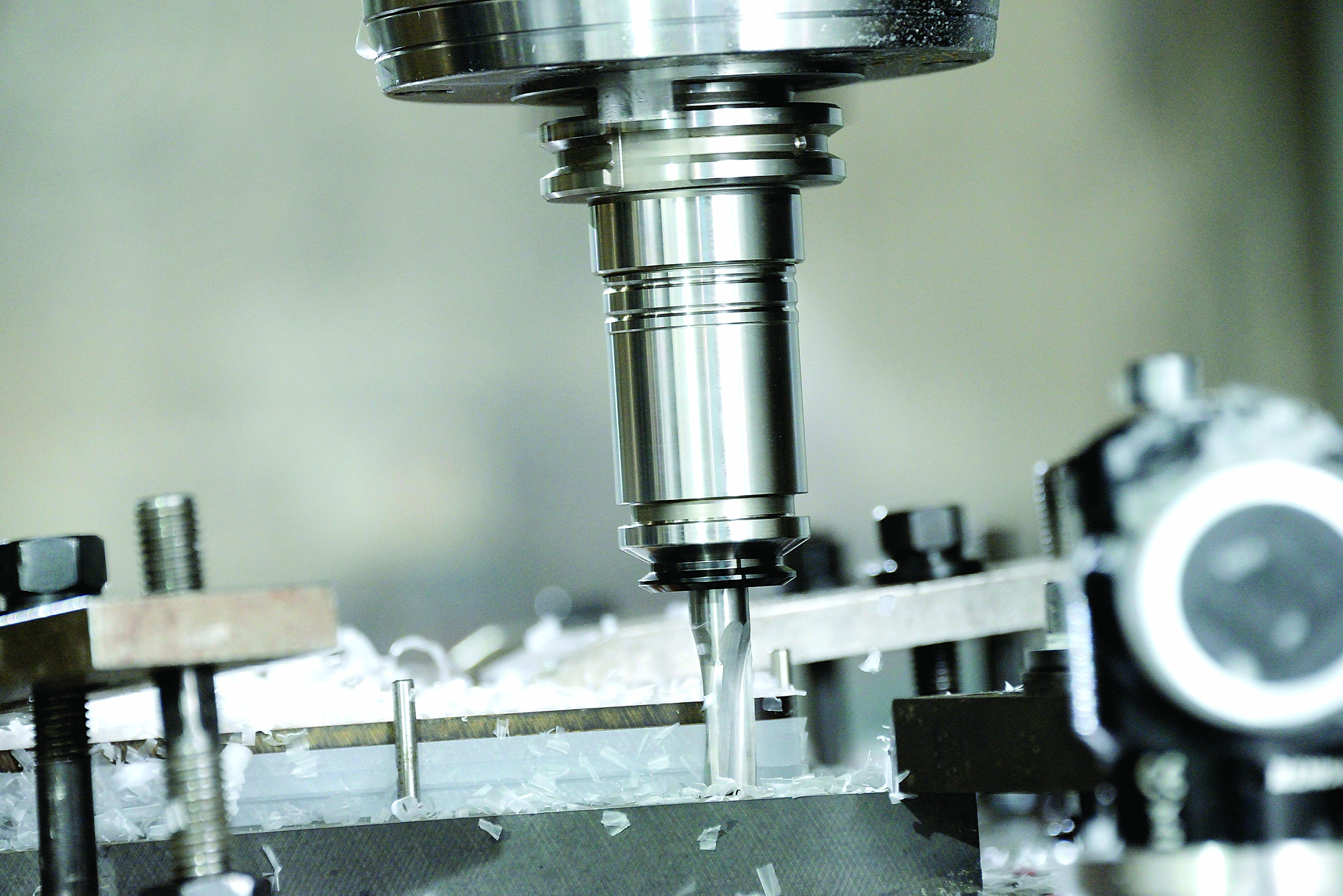

With runout significantly minimized, K&E’s machinists can set cutter compensation at zero and use a 0.125″-dia. endmill to create a 0.125″ slot. Multiple passes with a 0.093″-dia. tool are no longer needed, reducing cycle times.
“With Rego-Fix tooling precision,” Broderson said, “we’re actually cutting with all three cutter flutes instead of just one, and there is less vibration. This means fewer burrs, so we get a better finished product coming off the machine.”
