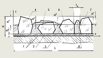

Figure 2: Schematic of a cross section of a composite diamond-electroplated coating.
1. Copper-electroplated metallic tool body
2. Intermediate diamond-free layer
3. Nickel binder
4, 5, 6 and 7. Synthetic diamonds retained in a single layer by electroplating
8. Binder overhang above its basic level
Hi (i = 4-7). Diamond overhang above the binder
H0. Thickness of the no-diamond layer
1ai. Distance between diamond grains

The surface of a single-layer diamond abrasive tool is a rough, complex and multiphase heterogeneous system. Such a system contains dielectric diamond grains strongly connected to each other and safely retained in the binder (Figure 2).
The copper-electroplated metallic body and the intermediate diamond-free layer provide high adhesion strength between the diamond layer and tool body.

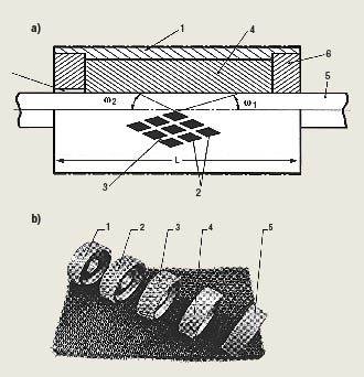

Figure 4: Design of a single-layer diamond abrasive roller: a) the roller and b) the wheels with different geometry of the interrupted cutting surface.
Single-layer diamond abrasive tools with a nickel-galvanic binder developed at the Institute for Superhard Materials, including cutoff and grinding wheels, rollers, grinding heads, drills and conical and cylindrical countersinks, are based on the principles of minimizing the thermal fields in the tool/workpiece cutting zone and optimizing clearance of the contact between the tool and workpiece. In accordance with these principles, reduction of thermal stresses generated by such tools when cutting PCM can be achieved at certain periods of time. The durations of such periods should be shorter than when heat saturates the workpiece.
To obtain such a condition, calculations of thermal fields in the workpiece and in the cutting tool were performed. Based on these calculations, the following design and geometric parameters of the interrupted working surface were determined: dimensions of the cutting elements, the distance between them and inclination angles of the cutting elements respectively to the tool’s centerline.
From a design viewpoint, the working surface of the recommended diamond abrasive tools is a sequence of alternate overhangs and recesses. The dimensions of the overhangs and recesses are determined through the amount of time of the cutting elements’ engagement and disengagement with the workpiece. The design of the cutting elements provides optimal clearance between the cutting tool and workpiece to wash microchips from the cutting zone.

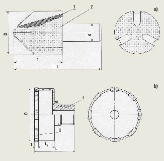

Figure 6: Design of single-layer diamond abrasive solid (a) and annular (b) drills: 1) body and 2) working surfaces.

Solid and annular single-layer diamond drills from 2mm to 60mm (0.08 ” to 2.36 “) in diameter were developed for drilling holes into sheets and tiles of metal-based PCM (Figure 6). The optimal cutting speed is 5 to 20 m/sec. (985 to 3,940 sfm) and the optimal feed rate is 0.01 to 0.10 m/sec. (2.0 to 20.0 sfm).
Compared to standard HSS and cemented-carbide drills, single-layer diamond drills last five to 10 times longer when drilling carbon, fiberglass and organic plastics and nine to 10 times longer when drilling sandwich-like metallic PCM containing aluminum and organic-based-plastic sheets.

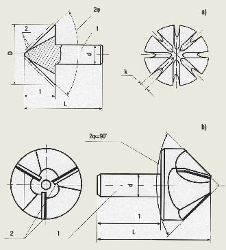

Figure 7: Design of the countersinks: a) single-layer diamond conical countersink, where 1 is the body and 2 is the diamond layer; b) blade-type conical countersink where 1 is the body and 2 is the PCD bonded to a cemented carbide substrate.
Drilling productivity using diamond tools is three to nine times higher, the quality of machined surface is higher and drilling accuracy is two to two-and-a-half times higher compared to standard technology. The degree of hole accuracy for diamond drills depends on the hole diameter. For example, the accuracy is 36ÎŒm (0.0014 “) or better for a 2mm (0.08 “) hole, and the accuracy is 116ÎŒm (0.0046 “) or better for a 60mm (2.36 “) hole.
Countersinking of PCM is performed to produce conical cavities for rivets. Riveted structures consist of PCM packets, such as carbon plastic and carbon plastic, organic plastic and organic plastic and mixed packets of carbon plastic and an aluminum or titanium alloy. Such PCM packets and metallic PCM are not thicker than 6mm (0.24 “).
Single-layer diamond abrasive and cutting blade-type countersinks have been developed (Figure 7). A cutting blade consists of PCD bonded to a cemented tungsten-carbide substrate. The optimal cutting speed is 3 to 20 m/sec. (590 to 3,940 sfm), the optimal feed rate is 0.01 to 0.12 m/sec. (2.0 to 24.0 sfm), and the optimal DOC is 0.5mm to 5.0mm (0.02 ” to 0.20 “).
Compared to standard HSS and cemented carbide countersinks, single-layer diamond countersinks last seven to eight times longer when used for carbon-based plastics, four to five times longer when used for boron-based plastics and 10 to 12 times longer when countersinking organic plastics. Countersinking productivity is three to five times higher and the quality of the machined surface is better compared to standard technology.
