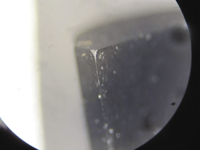

After you’ve made the adjustments necessary to allow the boring bar to finish holes without suffering catastrophic failure, let’s say you decide the production per shift is not acceptable and you feel you’re changing boring bars too frequently. Upon examination of the bar, you determine the tool’s cutting edge has excessive flank wear (Figure 1).
However, the cause of excessive or rapid flank wear can easily be misdiagnosed. Frequently, over time, interrupted cutting or chatter can cause small pits to form on the cutting edge that resemble flank wear.
Troubleshooting solid-carbide boring bars requires the right diagnosis
Figure 1. The cause of flank wear is easy to misdiagnose when troubleshooting boring bars.

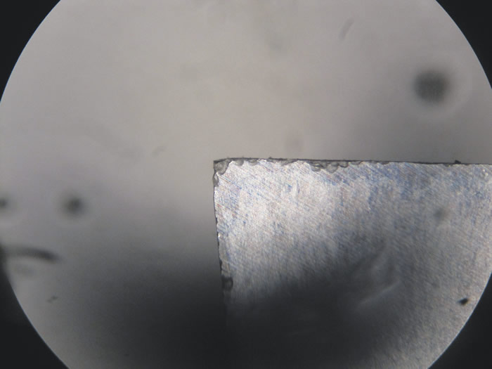

In addition, what looks like flank wear can start as built-up edge on the top surface of the bar (Figure 2). This is caused by metal from the workpiece welding to the top surface at the cutting edge as a result of heat and pressure during chip formation. Then, at some point, a chip will dislodge the buildup, along with a small piece of carbide from the bar.
To determine if one of these conditions caused the tool to look as though it has experienced flank wear, bore one or two holes and then check to see if any BUE or chipping exists (Figure 3 below).

To reduce BUE, the pressure or heat must be reduced. Pressure results from an overly high DOC and feed rate. Lowering the cutting parameters will reduce the pressure, as well as the heat, but it also lowers productivity. A more productivity-enhancing change would be to apply a coated tool. Coatings reduce the heat that develops as chips move across the cutting surface. A thin, PVD AlTiN coating should be effective, whereas a CVD coating would be too thick and can cause the cutting edge to deteriorate.

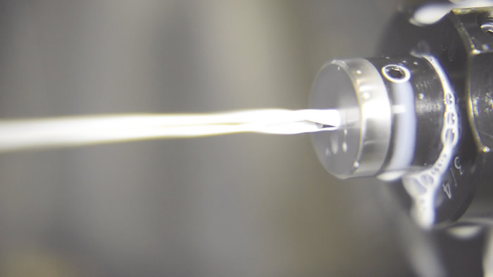

Generally, end users try to reduce heat by applying coolant. This is usually simple when machining an OD but can be difficult when boring a small ID, because the hole is partially filled with the boring bar and hot metal chips that need to be cooled.
A coolant line positioned close to the hole often gets in the way, so the best approach is to supply coolant through the boring bar holder. An ample supply of coolant around the circumference of the bar would be ideal, enabling coolant to find the path of least resistance and access the bottom of the bore. Typically, this requires positioning several coolant lines, such as one on the cutting edge side, one directed at the top of the bar and one on the back opposite the cutting edge.

(In response to the need for ample coolant, Scientific Cutting Tools offers a toolholder with Coolant Ring Technology, which enables coolant to be applied around the circumference of a boring bar. This encompasses the bar in a “tube” of coolant.)

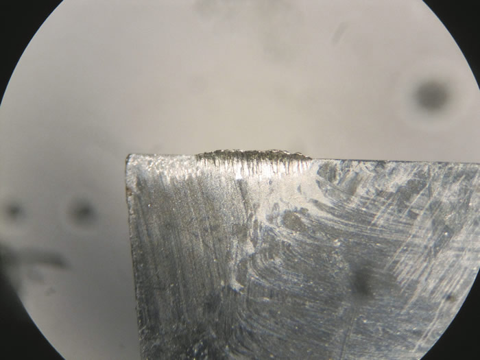

If the tool experiences chipping after boring a couple of parts, the most likely cause is an interruption in the part, such as a cross-hole or keyway. When boring an interruption, you may need to apply a tool whose cutting edge has a corner radius, hone or both a corner radius and hone.
If the chipping is not from an interruption, chatter could be the culprit. Chatter is similar to an interruption in that as the tool flexes, it moves downward, then moves back up as it relaxes, shocking the cutting edge. A possible solution is to increase the feed rate. A 10 percent increase can sufficiently boost the pressure to keep the tool in a deflected state, preventing it from relaxing and experiencing a shock.
Figure 3. An example of a cutting edge with severe chipping.
