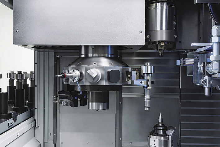

This vertical lathe combines turning and grinding in a single machine.
This vertical lathe combines turning and grinding in a single machine. Image courtesy EMAG.

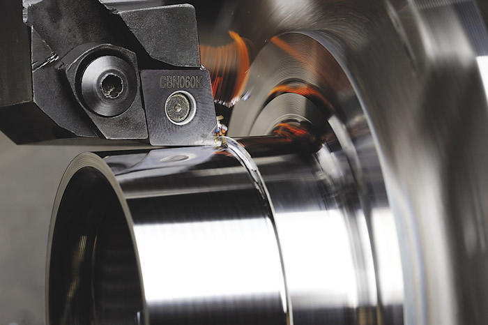

Indexable ceramics are another option. Jack Kohler, applications engineer for Greenleaf Corp., Saegertown, Pa., said the cost of ceramic cutting tools falls somewhere between PCBN and carbide, and offers equivalent or better performance in some applications. “Ceramic does quite well in the 50-HRC to 65-HRC range,” he said. “Cutting speeds would be comparable to PCBN. Figure around 700 sfm on a 55-HRC A-2 tool steel, for example, with only slightly lower tool life.”
Kohler said he’s seeing increased use of ceramic in high-temperature alloys, such as Inconel 718 and Hastelloy, although he warns shops to steer clear of titanium, as this presents a fire risk because titanium chips can burst into flames at the high cutting speeds common with ceramics. Regardless of the metal being cut, ceramic inserts usually come with a slight hone, land or combination of the two at the cutting edge to prevent chipping and increase strength.
Ceramics should be run dry in hardened materials, Kohler said. He recommends Greenleaf’s WG-600 silicon-nitride grade—a CVD-coated version of the company’s whisker-reinforced WG-300—as a good starting point for most hardened steels, as well as its new XSYTIN-1, a phase-toughened ceramic grade designed specifically for high-performance roughing and interrupted cuts.

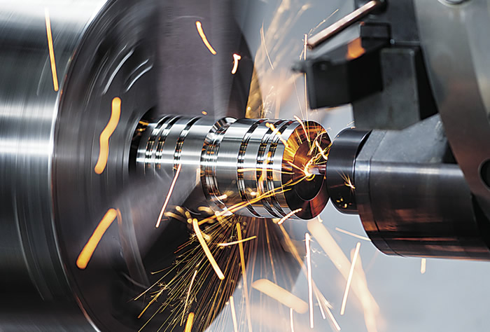

Turning a part with a Seco PCBN-tipped insert.
Turning a part with a Seco PCBN-tipped insert. Image courtesy Seco Tools.

CNC grinders are routinely called upon to produce part roundness of 1μm (0.00004″), maintain diametral tolerances of ±2.5μm (0.0001″) and impart surface finishes as fine as 8 rms or finer. Sheehy said the only way a CNC lathe can compete in this arena is if it is designed from the ground up for hard turning.
“Hardinge Super-Precision lathes offer 0.1μm programmable resolution,” he said. “Axial errors are mapped and compensated for electronically. All mating surfaces within the machine are hand-scraped, the linear guide ways and ballscrews are oversized, and the base of the machine is filled with composite polymer for vibration damping. Not only does this produce the accuracy and rigidity needed to replace many grinding operations, it also increases tool life during hard turning by up to 30 percent.”

Some machine builders, Hardinge included, offer turning and grinding machines, making them trusted advisers on which process is most suitable for a given part. Another is EMAG LLC USA, Farmington Hills, Mich., which also offers machines that grind and hard-turn. The company’s director of sales, Kirk Stewart, agreed that hard turning offers many opportunities for improvement in productivity and part quality, and proper machine design is critical to success.
Turning hardened materials presents challenges, opportunities
Turning with ceramic inserts is usually done dry. Here the toolholder is mounted face up, driving cutting forces down into the machine's load-bearing surfaces.
Turning with ceramic inserts is usually done dry. Here the toolholder is mounted face up, driving cutting forces down into the machine’s load-bearing surfaces. Image courtesy Greenleaf.
“A significant benefit of changing from grinding to hard turning is the reduction in capital investment,” Stewart said. “Grinding, however, does have its place and is, in some instances, a faster process when multiple features are ground simultaneously—a situation that is ideal for high-volume applications. Thus, in a high-volume environment, when there are only one or two features that require finishing, hard turning might be the better process for overall capital investment.
“Alternatively, when the machine architecture allows, a combined configuration of turning and grinding can become very attractive for mid-volume requirements, an architecture that EMAG machines inherently provide.”
