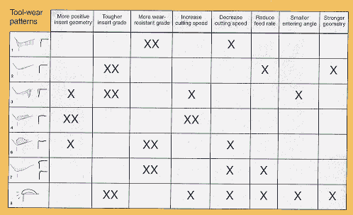

Employing appropriate machining parameters helps minimize tool wear. But it doesn’t prevent wear. Remember, tool wear is not an inherently negative process. Tools will always wear. It is not if, but when, how much, and in what manner tools wear. When a cutting edge has performed a considerable amount of metalcutting within a reasonable time, wear is quite acceptable. It is a problem when premature breakdown or tool fracture occurs, causing excessive stoppages for edge changes and, in some cases, workpiece damage.
Figure 2: Principal tool-wear characteristics in stainless-steel turning: (1) flank wear, (2) edge chipping, (3) notching, (4) BUE, (5) flaking, (6) crater wear, (7) plastic-deformation-based wear, and (8) thermal cracking.
Prevent the Avoidable
Some edge-wear patterns are normal, while others are symptomatic of improper insert application, incorrect machine settings, or inappropriate turning techniques. The latter patterns are signs of trouble ahead. It’s important to diagnose and correct these early warning signs and apply some innovative cutting techniques to minimize future tool troubles.
Tool-failure mechanisms that come into play in stainless-steel turning are similar to those found in steel-turning operations. The differences can be seen in the degree of wear (Figure 2). Here is a brief overview of the most common wear patterns and remedial actions to take to correct them early (Table 2).
Flank wear should generally be viewed as normal. It occurs at the flank or clearance face of the cutting edge along the length of engagement with the workpiece. Its occurrence can be positive in that it makes the edge sharper. However, after a certain amount of wear, continued friction against the machined surface abrades the tool and diminishes edge performance.
The solution to excessive or premature flank wear usually is to slow down the cutting speed. Another remedy is to use multicoated inserts or inserts coated with Al2O3 rather than just TiN.
Edge chipping, or breakage of the edge line, can occur when an edge has reached the end of its useful life or when the tool must execute an interrupted cut. If the edge is simply worn, you should consider indexing and changing inserts more frequently. The remedies in the case of an interrupted cut are to reduce feed rate; change the tool’s approach angle to ensure stability; and/or select a tougher, cobalt-enriched insert grade. Often, the answer is a combination of these remedies.
Notching is a type of wear in which the carbide actually breaks down, leaving a void on the cutting edge. Notch wear on the insert’s leading edge is caused by workhardening of the stainless-steel surface. During turning, the DOC line is machining harder material than the underlying nose radius of the insert, creating a notch. On the insert’s trailing edge, notching is caused by oxidation where air and coolant come in contact with the tool at high temperatures. Trailing-edge notch wear is less common than leading-edge notching in stainless-steel turning.
Notch wear is the culprit behind burr formation, which occurs when the cutting edge begins pushing the material instead of cutting it. As the notch becomes more pronounced and starts breaking down the cutting edge, the cutting forces at the DOC line rise, causing the edge to push rather than shear the chip. Along with a sharp, strong edge, larger lead angles also can help prevent this from happening.
To prevent notch wear, the remedies cited for flank wear are usually effective.
BUE is related to temperature and cutting speed. Under high temperature and pressure, the stainless-steel chips become gummy and tend to smear and stick to the insert flank. The workpiece material welds onto areas of the edge where the substrate is exposed. The BUE is torn off repeatedly, each time taking with it a chunk of the insert, leading to chipping.
Allowing BUE to grow without intervening causes premature edge breakdown and, in some instances, catastrophic insert failure. Fortunately, the temperature and cutting-speed ranges where BUE occurs are well defined and can be avoided. Much of modern stainless-steel turning takes place above the ranges where BUE occurs. And many modern insert grades are highly resistant to BUE if used properly.
Increasing cutting speed usually reduces BUE. If this isn’t possible because of machine restrictions or part specifications, a tougher grade, such as M-35, with a higher positive rake can alleviate BUE.
Flaking involves coating damage caused by an inferior coating, poor adhesion of the coating to the substrate, or plastic deformation of the workpiece. The remedy is to switch to inserts with a more tenacious coating, such as an MTCVD coating.
Crater wear occurs where the chip contacts the tool and is caused by cobalt diffusion between the tool and the chip and abrasion wear on the insert. It weakens the edge. The first recourse is to reduce speed to lower the cutting temperature. Second, reduce feed rate. And it’s a good idea to switch to an MTCVD Al2O3-coated insert with a positive geometry, which resists crater wear.
Thermal cracking is mainly a fatigue-wear phenomenon caused by rapid changes in cutting-zone temperatures and interrupted turning. To avoid it, turn up the coolant flow and select a tougher carbide grade with high resistance to thermal shock or, in some cases, turn off the coolant supply to keep the temperature level even.
Plastic deformation of the stainless-steel workpiece can contribute to notching, edge chipping, and crater wear. This problem often results from higher cutting forces and temperatures encountered when turning stainless steels, especially austenitic stainless steels, which contain nickel and molybdenum. For a tool material that can stand up to these conditions without causing plastic deformation, select an Al2O3-coated, wear-resistant grade. Al2O3 has high hot hardness and resists the cratering encountered at high speeds where plastic deformation occurs.
Table 2: Recommended remedies for the most common types of insert wear. XX = best alternative remedy; X = possible remedy.
