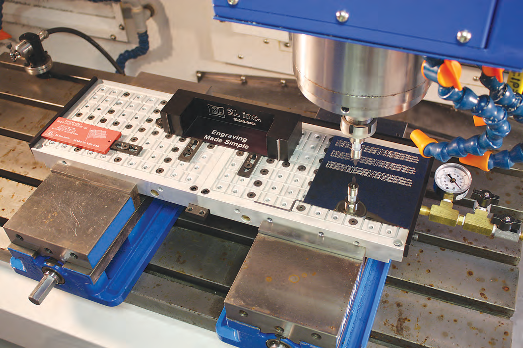

Courtesy of 2LVacuum chucks can be set up directly on the machine table or, as in this case, placed in conventional vises for fast changeovers.Vacuum workholding is catching on in new and different applications.Holding aerospace parts for milling, drilling and other operations is one of the most common applications for vacuum workholding.
August 15, 2010
Vacuum-chuck_2L_CTE_1.tif
Courtesy of 2L

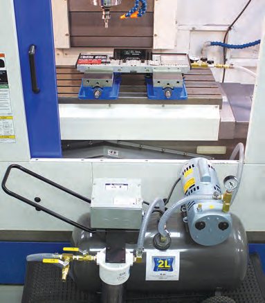

A typical vacuum workholding system consists of an industrial vacuum pump and a chuck with top plate, plus coolant return and safety devices. A common top plate is a perforated, grid-style aluminum plate that resembles the surface of an air hockey table. Users also commonly machine custom plates to fit their parts.
Regardless of top-plate configuration, polymeric gasket material installed in the top-plate surface creates a seal between the chuck and workpiece, preventing loss of vacuum. When the pump is turned on, about 13 psi of vacuum—roughly atmospheric pressure at or near sea level—pulls the workpiece against the chuck to compress the gasket material and maintain the vacuum seal. Total holding force depends on workpiece surface area, which explains why the technique works best for large, flat parts or for machining multiple small parts from large sheets of material.
Vacuum workholders used while machining with coolant also require a system to prevent coolant from being sucked into the vacuum pump. Finally, a safety device wired to the machine control monitors vacuum level and shuts down the machine if it reaches a preset lower limit.
08, Workholding 2.tif
Courtesy of 2L
Typical vacuum system setup on a VMC includes a chuck (in this case, held by a pair of machine vises) and portable electric vacuum pump.

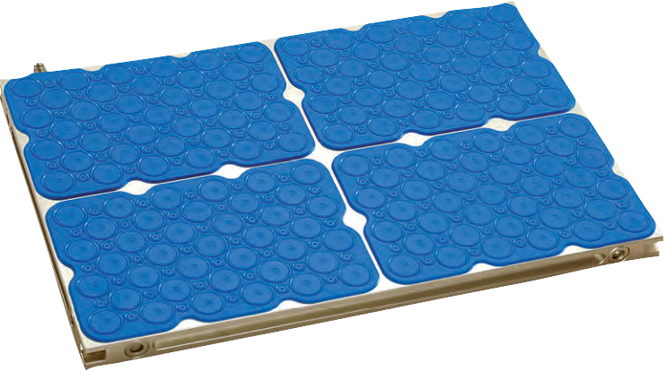

Designed to leak, the Vac Mat system consists of plastic mats covered with multiple small suction cups. The design minimizes loss of vacuum even if users machine through one or more of the cups.

One product offers another way around the problem. “Almost all vacuum workholding systems are sealed in one way or another, but our Vac Mat system is designed to leak,” explained Bruce Thomsen, applications manager for IBAG North America, North Haven, Conn.
The product consists of a plastic mat with a series of small suction cups on top. Each cup features a 0.5mm-dia. hole in the center, and each essentially acts as an individual vacuum chamber. This setup lets users machine through the mat while losing vacuum in only a small area of the mat.
According to Thomsen, the system works well for parts about 5 ” long on a side or larger and is modular. “Users can start with one mat, and simply plug more in as they need more capacity,” he said.

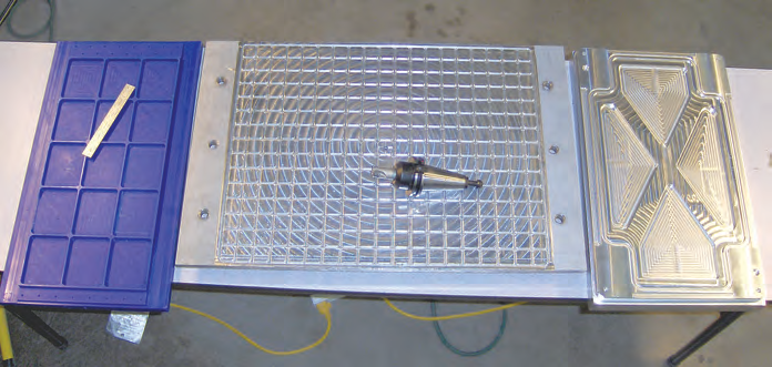

08, Workholding 1.tif
Courtesy of WarrenTech Career and Technical High School
(From left) Wax prototype, vacuum chuck and rough-milled back of an aluminum ISS storage locker produced at WarrenTech for NASA. Tool shown was used for the majority of the machining, which was performed at 35 ipm with a 0.030 ” DOC.
