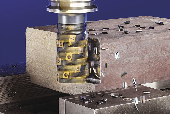

Flood coolant is not recommended for roughing steel with an extended-flute milling cutter. All images courtesy Iscar Metals.

During machining, the temperature in the cutting zone becomes extremely high, which depends on factors like the workpiece material, cutting data and cutting tool substrate. For example, the temperature for a tungsten-carbide tool at the point of contact between a cutting edge and the workpiece is estimated at 1,100° to 1,200° C (2,012° to 2,192° F).
The application of coolant lowers the cutting zone temperature and reduces the thermal load on the tool. In addition, coolant improves chip evacuation and also reduces the concentration of metal dust. Therefore, the coolant supply is directly connected to several important benefits. Specifically, coolant:
■ advances process performance by improving machining accuracy and surface finish;
■ increases profits by raising productivity and extending tool life; and
■ augments environmental control.
When interrupted milling, the cutting edge of the tool experiences a cyclic thermal load because the ambient temperature dramatically changes as the edge enters and then exits the cut. This exposes a tool’s cutting edge to severe heat stress—comparable to repeated thermal shock.
Cemented carbide is a sintered, powder metallurgy product and is sensitive to thermal shock loads, which destroy cutting edges. When using a carbide tool, coolant application may increase the “shock treatment” and unintentionally contribute to cutting edge failure. Extreme temperatures result in plastic deformation of the cutting edge, while the temperature difference leads to thermal cracks. This becomes even more exaggerated in situations that generate a high level of heat, such as when milling difficult-to-cut materials. Although wet machining provides multiple benefits, it certainly can be problematic when milling.
In many cases, however, having an efficient coolant supply is not only reasonable but absolutely necessary to ensure productive milling. For example, when machining titanium and heat-resistant superalloys, austenitic and duplex (austenitic-ferritic) stainless steels—or even special-purpose, hardened, alloyed cast iron—a considerable amount of friction and heat is generated. The flushing effect of coolant also significantly enhances chip evacuation and reduces recutting of chips, particularly when milling deep pockets or narrow slots.
