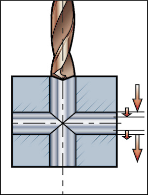

When entering and exiting a cross-hole, Sandvik Coromant recommends reducing the feed to a quarter of the normal rate.

Habben said this is just part of the story, though. “As the drill tip breaks through into the intersecting hole, a rule of thumb would be to decrease the feed rate by about 50 percent. This helps minimize the number of burrs and also to reduce deflection, especially in an off-center situation.”

No edge prep in the world, however, will help without a good drill. The cutting forces generated on breakthrough when cross-hole drilling can be tremendous, and deflection becomes a real problem. Al Zaitoon, sales and marketing manager for YG-1 Tool Co., Vernon Hills, Ill., explained that indexable-insert drills, or insert drills, a staple in most machine shops, are not the answer for cross-hole drilling.
“You need some sort of support to keep the drill stable when you break through into the cross-hole,” Zaitoon said. “With an insert drill, there’s no margin behind the cutting edge to stabilize it like there is with other drills.”
Zaitoon painted this picture of a typical cross-hole. “Say you’re using a ½ ” solid-carbide drill to go into a 3⁄8” cross-hole and it passes into another hole after that. The drill has a margin length of 2 ” or maybe 3 “, so that helps stabilize it as it passes from one hole to the next. You don’t have that with a spade or insert drill. They end up just bouncing around.”

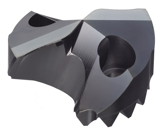

Replaceable-tip drills have basically the same geometry as solid-carbide drills, with two effective cutting edges in a one-piece design. The head is secured with screws against a ground serration. This offers high locational accuracy as well as strength in the drive mechanism, according to Habben.

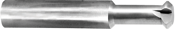

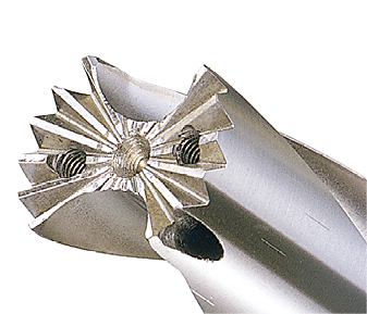

A Melin multiflute cutter removes difficult burrs using a CAM-generated toolpath, according to the company.

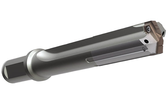

Rob Brown, product manager for Allied Machine & Engineering Corp., Dover, Ohio, agreed with most of that advice. “As far as insert drills go, they’re absolutely right. There’s no margin on those tools and only a single effective cutting edge. On spade drills, however, the margin runs the length of the insert itself. Sure, that’s all the support you’re going to get, but it’s still a lot more than you’d get with an insert drill.”
In cases where this doesn’t quite cut the mustard, Brown recommends a special, where the body of the drill has guides to help stabilize it through the interruption.
Courtesy of Sumitomo Electric Carbide
An aggressive cutting head (top) is rigidly clamped to a through-coolant drill shank on Sumitomo’s SMD-style replaceable-tip drill.

Courtesy of Allied Machine & Engineering
A custom spade drill from Allied Tool offers long margins for additional support when cross-hole drilling.

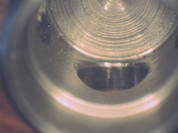

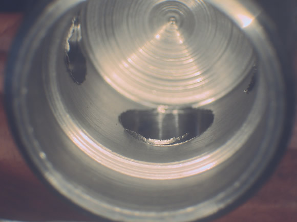

Tangling with those nasty burrs in cross-holes
Making the hole is sometimes the easiest part of cross-hole drilling. “We have customers that once took 10 hours to deburr hydraulic manifolds filled with dozens of holes,” said Stan Kroll, sales manager at J.W. Done Corp., Hayward, Calif. “And with one slip of the blade, the part was scrapped.”
Kroll and J.W. Done President Michael Kapgan will tell you the Orbitool deburring device eliminates the craft factor of manual deburring. “You can literally do it with your eyes closed,” Kapgan said. “It greatly simplifies the manual deburring process. You just run it in and out of the hole, like you’re playing a violin.”
That’s music to anyone’s ears. J.W. Done guarantees its product, whether it’s used to replace traditional manual deburring processes or in a CNC machine tool. “People ask us why we don’t have any product returns,” Kapgan said. “I tell them it’s because we don’t give a return address.”

Before: Burrs surround cross-holes in this piston body.
Courtesy of J.W. Done
After one pass with an Orbitool deburring tool, the hole is burr-free with a radiused edge.
All kidding aside, the product works through a patented mechanism utilizing a flexible shaft together with a polished disk that acts like a cam follower against the hole wall, allowing the Orbitool to cleanly and effectively remove cross-hole burrs.
The amount of edge break is controlled by the preload on the tool together with simple programming techniques, providing anything from a sharp, burr-free edge to a large radius. “It’s just like milling a thread,” Kroll said. “We tell the tool the diameter of the hole and how deep to go. Orbitool takes care of the rest.”
