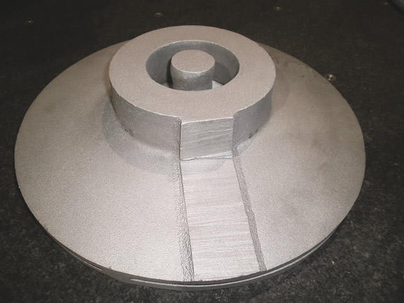

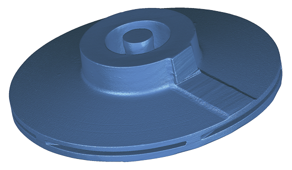

A large enclosed rotor for fluid-moving equipment (top) and the STL (stereolithography) data rendered from a CT scanning of the rotor.
However, instead of a square, 2-D pixel, where image resolution is based on the length of the square, computed tomography creates cubic pixels called voxels, where the size of the voxel is the scan resolution, and the smaller the voxel, the higher the resolution, Bhogaraju explained. “With CT data, you take from 1,000 to 1,200 2-D images and stitch them up into a 3-D dataset as the part rotates on the rotary table, so you end up with a cube and not just a square,” he said. “Voxels are the building blocks of the data.”

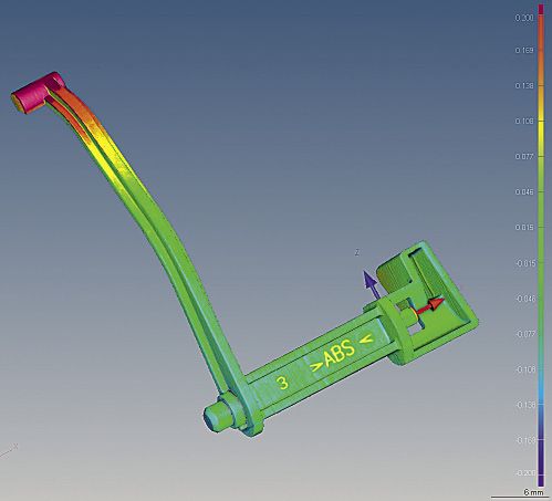

Software aligns the CT scanned part to the original CAD model.
However, filtering algorithms in the visualization software are available to help clean up the noise generated from mixed materials. “That’s not necessarily a challenge,” Bhogaraju said.

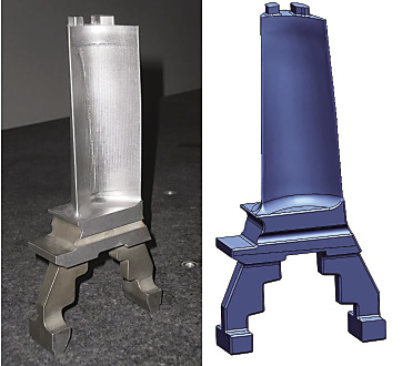

To reverse engineer a turbine blade (left), Power Plant Services produced a digital image of the blade using an NVision HandHeld laser scanner.
Laser scanner cuts reverse engineering time
Turbine parts manufacturer Power Plant Services reverse engineers turbine blades, airfoils and other parts. It also performs repairs on major turbine components for more than 40 utility plants and supplies an array of components and services to the power generation, pulp and paper, petroleum refining and steel industries.
Of the more than 10,000 parts the Melrose Park, Ill., company produces each year, Project Manager Chad Fisher estimates about 45 percent are reverse- engineered. Delivery time is critical because customers often place orders after power generation equipment has broken down, which can cost them hundreds of thousands of dollars per day in lost revenues.
Unfortunately, Power Plant Services found that reverse engineering some parts using a conventional coordinate measuring machine was consuming too much time. Producing a 3-D CAD file from a customer’s turbine blade, for example, required 15 hours. That was cut to 6 hours after Power Plant Services implemented an NVision HandHeld laser scanner, which is mounted on a portable CMM.
The shorter scan time allows Power Plant Services to deliver a new blade a day sooner, Fisher noted. “Previously, we used a contact probe to measure part elevations point by point in different cross-sections and entered the measurements in solid modeling software. Then we created lofts between the elevations,” he said. “We felt laser scanning could improve on this process by capturing the entire part profile and eliminating the need for measuring elevations and lofting.”
